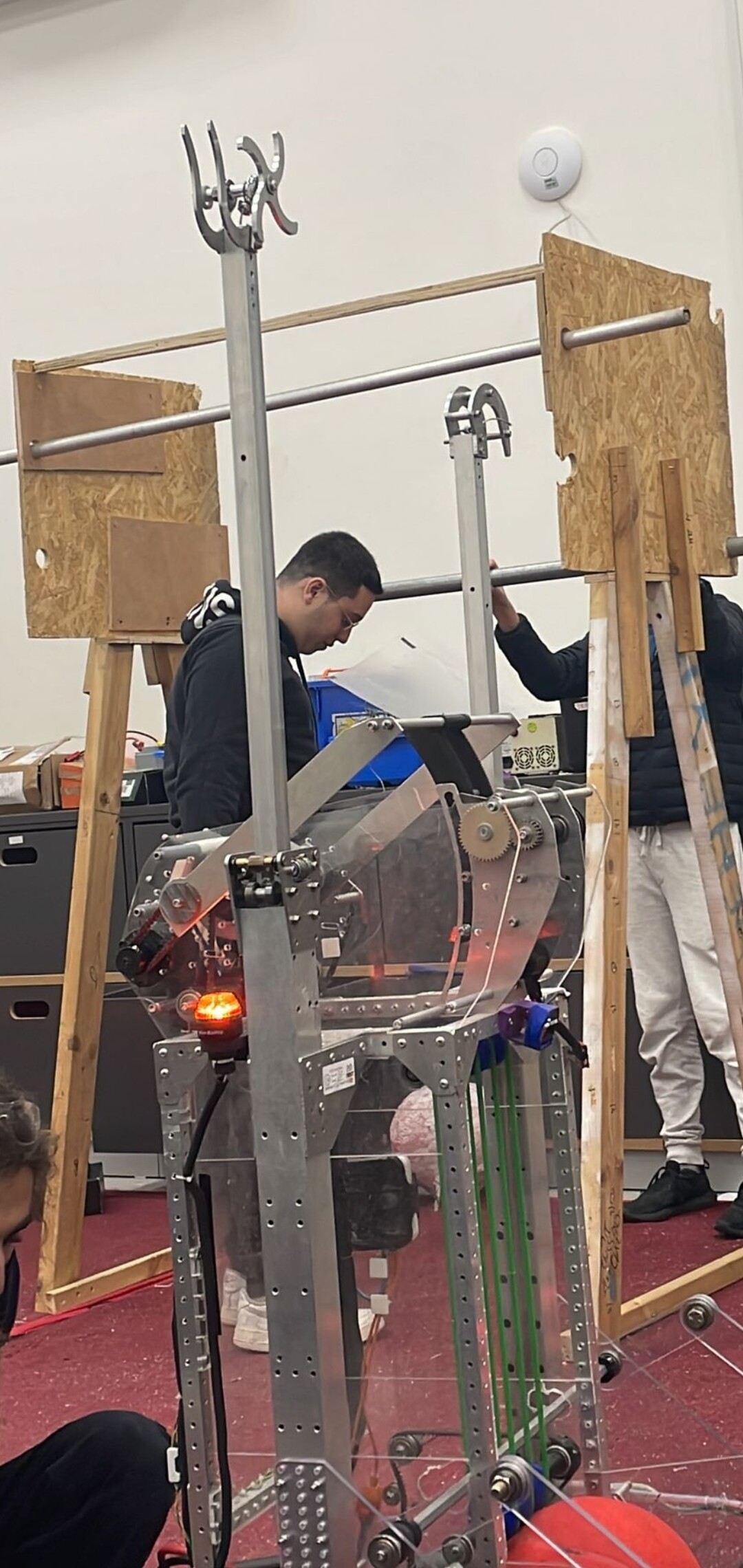

One thing to be aware of with using linear servo actuators that other people have noted is that you don’t explicitly know where the servo is, which makes it difficult to control. So there could be times where you think the hood is at the right angle but it’s actually still getting there.
But that is solvable, just like a regular motorized hood you can use a potentiometer that is concentric to the shooter wheel to find the angle, we used it and it worked great and was pretty easy to implement.
How do you control your hood with a linear actuator. Like how do you get what angle it is at if it’s a linear motion?
could you explain this a little bit more? Do you have any pictures?
This is the best image I managed to find. You can see the black hood is connected with 2 standoffs to an aluminum plate that sits on the shaft of our shooter wheel. This plate is connected to a potentiometer(in the other side of this image :frowning: ).
This works beacuse we think of the hood as a large spur gear concentric to our shooter wheel shaft.
We set the minimum and maximum angles of our hood as constants in our code and measured the resistance value in our min and max position which gives us the range of values we expect to recieve and from that we find our hood angle. Im supposed to be in the shop on friday so feel free to PM with additional questions or if you need more pictures :slight_smile:
At that point you might as well just drive the hood off of the gear teeth rather than using a linear actuator
Of course, our hood was driven of a neo 550, However, the method of using a potentiometer concentric to the shooter wheel to measure the travel of the hood does fit a linear actuator, or any other kind of adjustable hood( given the hood moves around this axis of course).
I hope it makes more sense now
