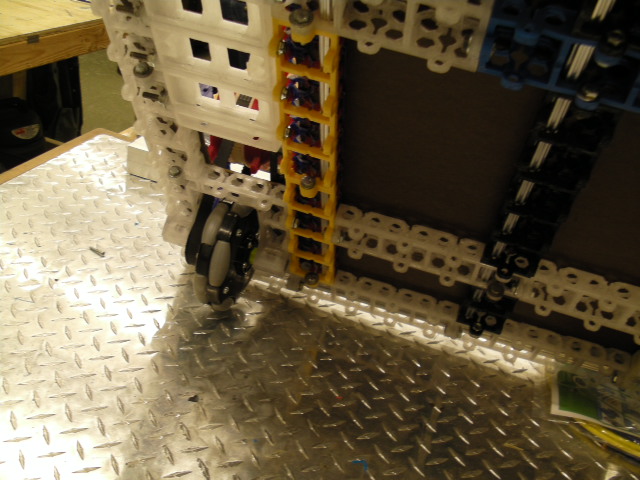

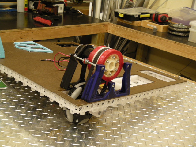

All the white(ish) is some kind of Nylon (bridge, 910, CX12) the rest is other materials (mostly PETG the light blue ABS) . This was a test platform The axle holders are about 245x215mm the longest of the straight pieces is 267x54mm The compound planetary is about 6 in in diameter. The compound planetary on this one is the only one that was printed with a .4 Nozzle
All the Nylon was printed on a prusa type printer with a garolite build plate and an E3D V6 hotend and brass nozzles except the .4 was a copper nozzle. Now How big is big? Now i know some of them were gears some small like the planets in the last planetary some huge like the rings in the big planetary and some 6 in tall like the compound planetaries in the big planetary. And some rectangular. Printing Nylon can be tricky but it can be done. Even on a hobbyist (cheap?) printer
