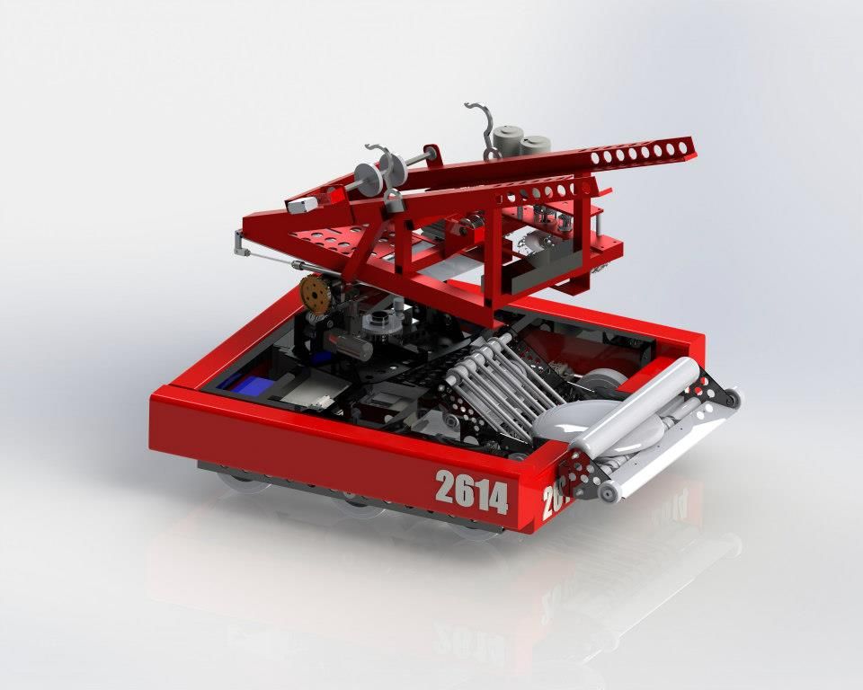

Marvin VI
Drive Train
  • 6WD with an 1/8 inch center drop
  • Colson Wheels
  • AndyMark Super Shifters 4:1 and 20:1 ratios
  • Belt Driven
  • Hex Output Shafts!
  • Talons
Shooter
  • Complete turret (Pan and Tilt)
  • Automated targeting using a Microsoft Kinect and an Onboard Processor running RoboRealm (using IR)
  • Field Realtive Setpoints with memorization functions to allow new shooting positions to be used on the fly
  • Inspired by Robot in Three Days
Other Things
  • Off Center Turret
  • 1st level climber
  • 7 second climb
  • Single disk Pickup mechanism
  • 3 disk autonomous (working on 4!)
  • Active PID control on Turret
  • Multiple Field relative setpoints allow the drivers to shoot to a goal regardless of how the drive base is positioned
  • Absolute turret position using potentiometers
  • LEDs!
  • LabVIEW Programming

Can you describe how your floor intake gets disks to your shooter? I can’t quite tell from the render?
At 1:45 in the video (pause it, nice picture), you can see the floor grabber down, then the turret comes down and meshes with the grabber. As the grabber is running backwards to pull in disks, so are the shooter wheels, so instead of rotating the shooter wheels forwards to shoot a disk, they rotate backwards to suck a disk in backwards through the shooter and into the breach.
