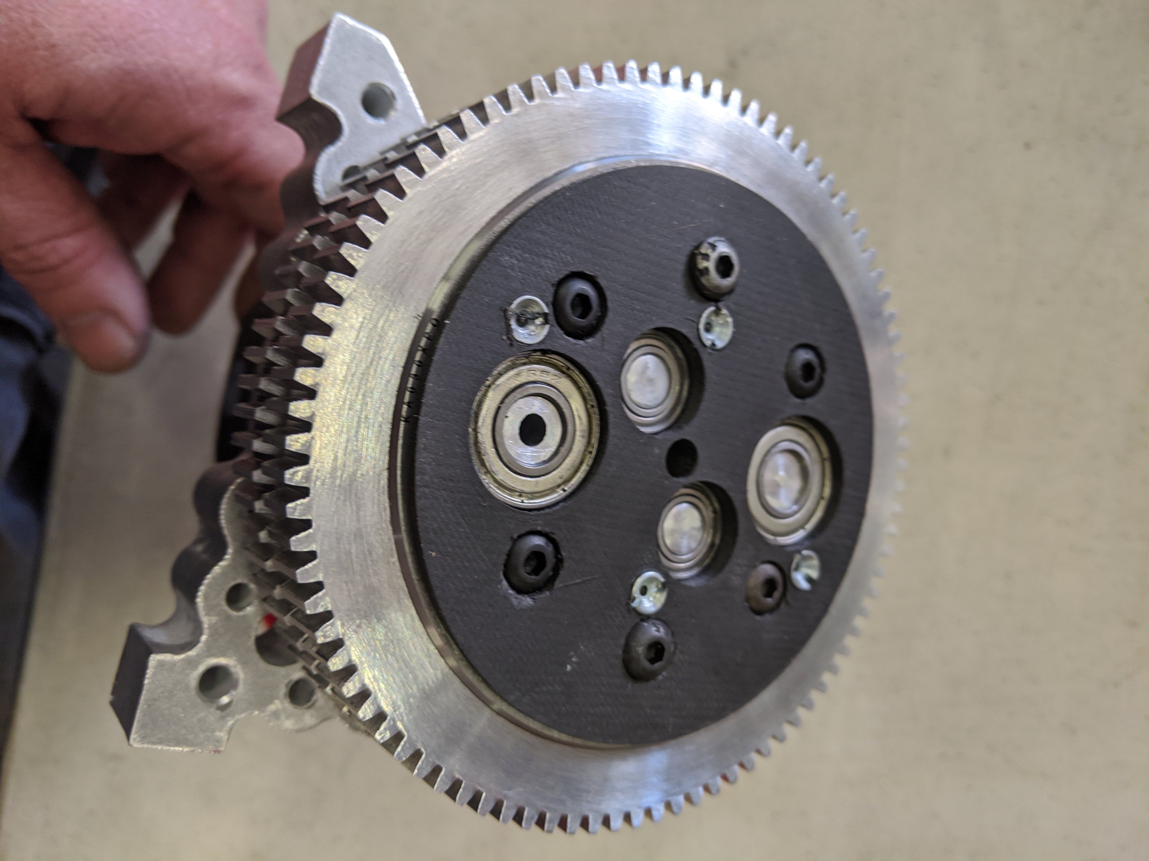

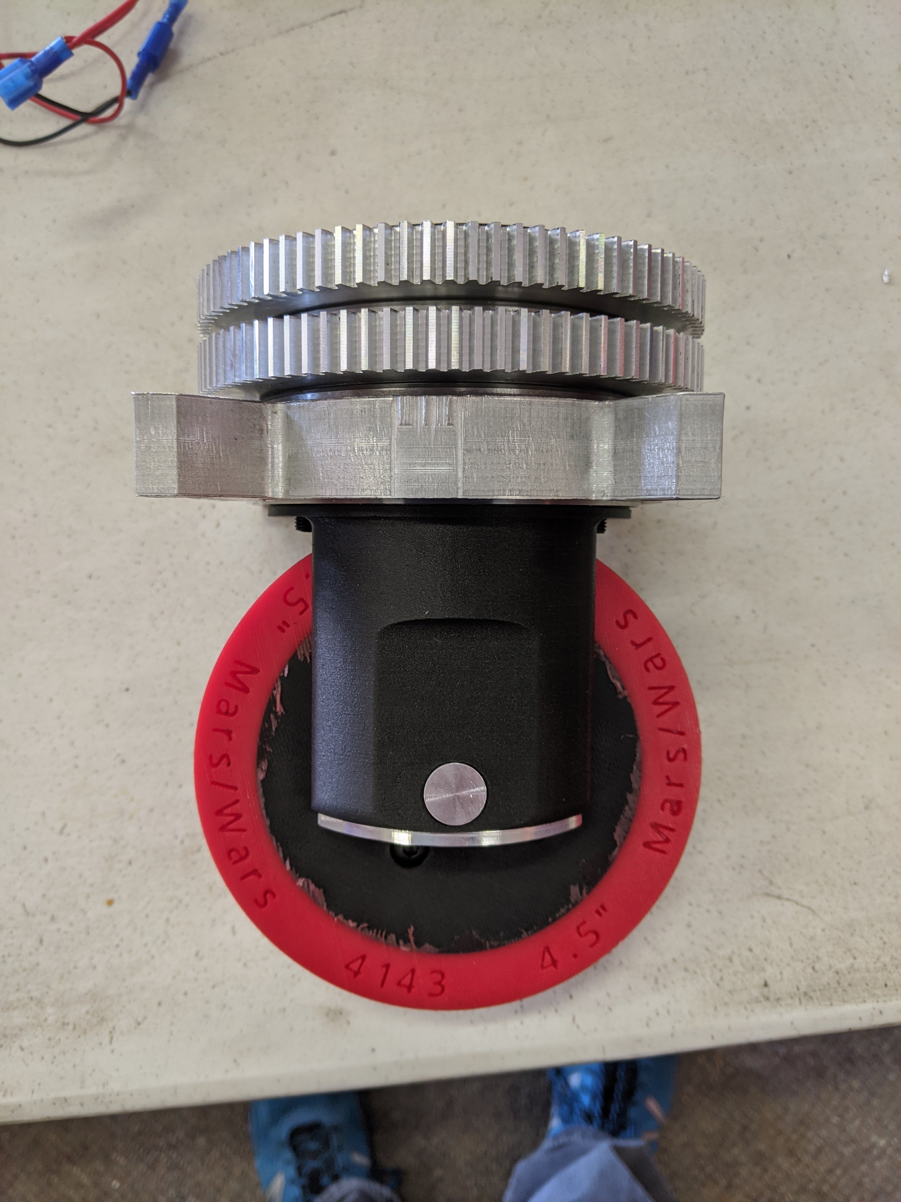

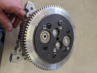

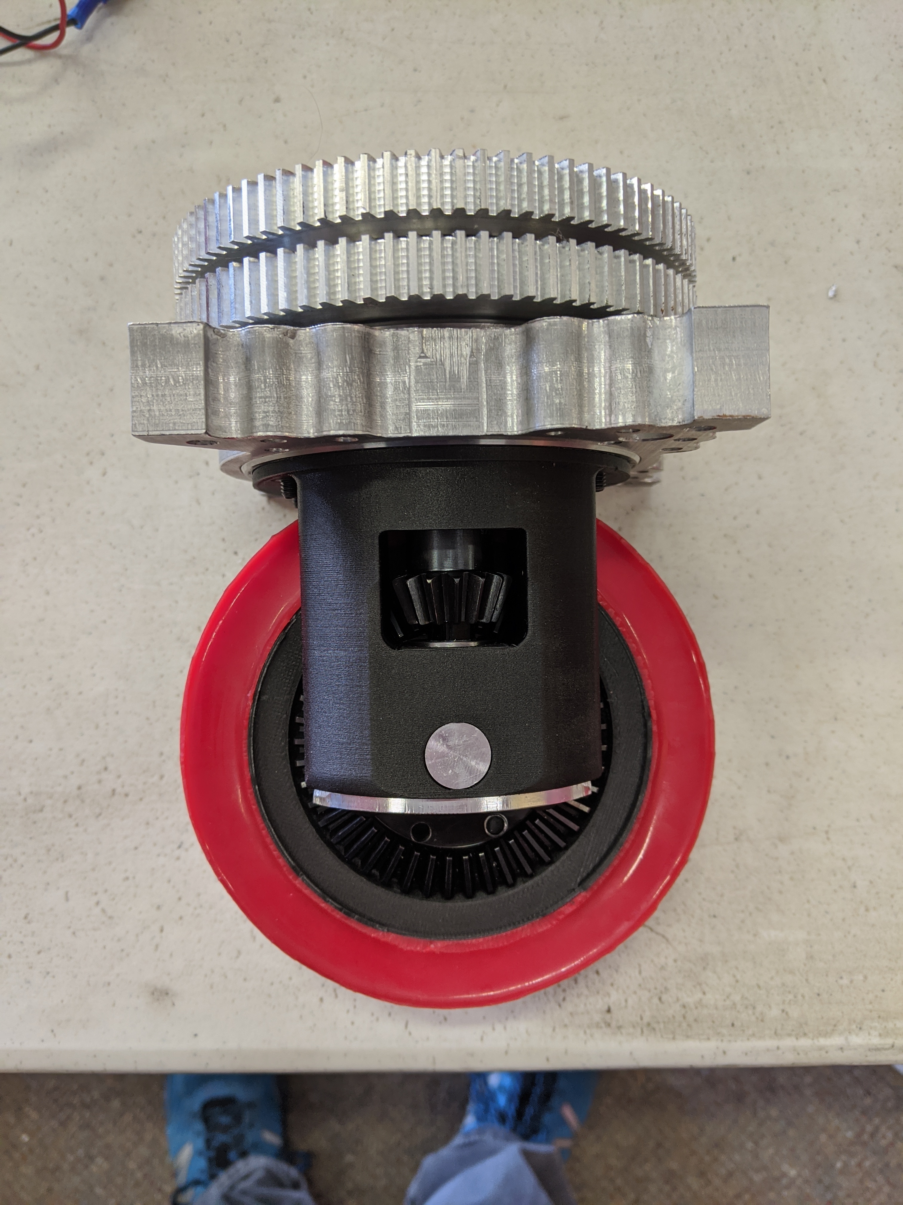

Also any chance of beauty shots of the modules? I think there’s a part I want to see in there :stuck_out_tongue:
There are 3 on the climber. I’ll get some shots of the modules.

Beauty shots
