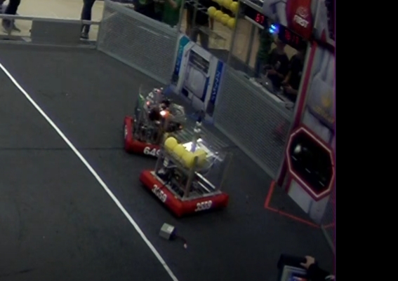

Exactly! Einstein Runner up alliance member 5406 at Detroit worlds last year accidentally got disabled by I think some field lexan piece pushing the disable switch nestled well within their frame during Ontario district champs last year. Hopefully someone from Celt-X can confirm or refute that?
So it’s not even always just another robot taking out your electronics, can be field elements or game pieces too.
another option to testing your batteries that is specifically for FRC I would say to look at the battery test kiosk my team developed. You can find our battery presentation that we presented at worlds here. If you want more information feel free to pm me and the other electrical people on our team along with me would be more than happy to answer any of your questions. Remember batteries are possibly the most important component of your robot and its ability to compete
Either that happened to them and us or you might be thinking of our team (the former is quite likely) but that definitely happened to us during DCMP 2019 during quarterfinals. We were pushed into the cargo ship by a defense bot and somehow something in the field sliced right through an Achilles heel in our electronics mounting and cut the power to our radio. Seconds later our alliance partner was tipped over, and there went the match and our season.
