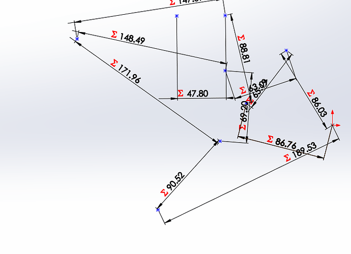

I plugged all the points and dimensions into Solidworks, nothing is defined so my answer is:
Unsolvable!
(99% sure I did something wrong)
8.06 units?
Also, no information is given about point number 1. Is that a typo?

I’m getting a whole range of values. I’m using SolidWorks in a similar fashion to Brian. Here’s the link to my solution if anyone wants to do a sanity check for me.
I think you have two different points for #2.
Also, your 47.80 dimension is the horizontal distance, not the linear distance between points.
EDIT - Ignore me.
That’s the distance to the top right point, not the one the number is closest to.
Woops! Thanks for catching that. You’re right.

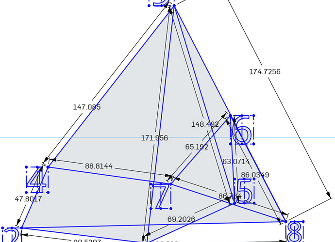

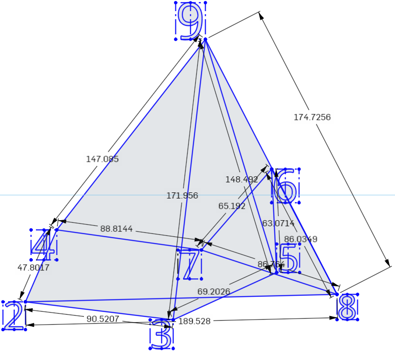

174.7256.
Link to my CAD (I found this cool, CAD package online in order to do it… seems to work pretty well, at least for this stuff, and you can have a public free account!)
https://cad.onshape.com/documents/435c0e6f9b14deedc0092c1d/w/0a06fac164e9bd97a7574059/e/9fed4d473a9620e77d130f51
Anyone see any mistakes? I even labeled my points :slight_smile:
Edit: Out of curiosity Ether, is there a purely mathematical way to arrive at the answer, one that can be done by hand on a single sheet of paper? :slight_smile:

Here’s another way to analyze this:
Jane made 12 distance measurements.
Pick a Cartesian coordinate system with point2 at the origin and point3 on the +X axis.
So the coordinates of point2 are [0,0].
Since Jane measured the distance from 2->3, and point3 lies on the +X axis, the coordinates of point3 are [146,0].
That leaves 6 points (4 thru 9) whose coordinates are unknown. Since there are 2 scalar values per point, you have 12 unknowns.
But you only have 11 measurements left, because you already used the distance from 2->3.
So you have an underdetermined system of nonlinear equations.
There is no unique solution.

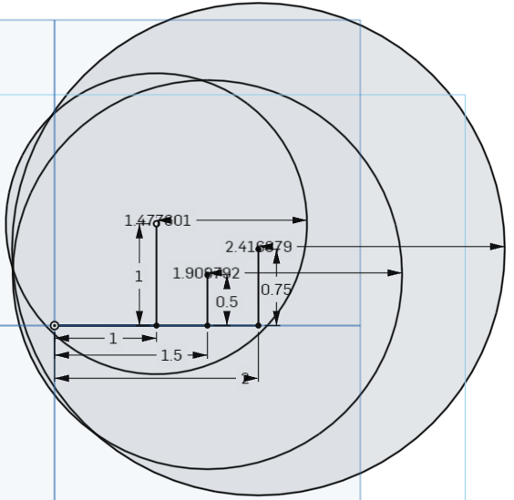

***Math Quiz 11, Part B:
Given three points p1, p2, p3 with coordinates (1,1), (1.5,0.5), and (2.0,0.75) respectively…
… find the coordinates of the point p4 whose distance from points p1, p2, p3 is 1.477601434758372, 1.909792135285932, 2.416879392936271 respectively.
This is an overdetermined trilateration problem (3 constraints, 2 unknowns), which happens frequently due to measurement noise in localization systems (like GPS). As such, the solution depends on what properties you want your residual to have. For one such choice of properties, I happen to know a neat trick that solves this problem elegantly for the particular case where (# constraints) = (# unknowns + 1).
Solution here.
This method adds a free parameter to the distance measurements representing measurement error (assuming it is uniform across all measurements), which lets us solve the system of equations efficiently to find the point representing the center of the three circle-circle intersections (obtained by leaving out one constraint at a time). “h” represents the radius^2 of the circle joining those intersections (which can be imaginary, as in this case, depending on whether or not all three circles overlap or not). The fact that “h” is small in magnitude shows that the solution is very close.
It would also be reasonable to want a (perhaps weighted by distance) least squares solution, but this would require whipping out a non-linear least squares solver.

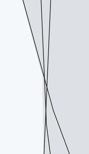

For part B… Is the system actually solvable? You can define each circle with the simple equation (x+a)^2 + (y+b)^2 = r^2. That leaves you with 3 equations but only 2 unknowns, which makes it really easy for there to be no solution. Of course, there’s no guarantee that the circles even intersect, but we should assume they do, right? Two circles can have 2, 1, or no intersections in common, likewise three circles can have 2, 1, or 0 common intersections!
Plotting it out, it initially looks like there’s an intersection point (near -0.409, 0.555) … but zoom in and the circles just miss having a common intersection. Plug the system of equations into Wolfram Alpha, and it comes back with no solution, supporting this finding.
So, lets simplify it down to pairs of circles, see how close we actually get.
p1 + p2:
x=-0.409
y=0.5550000000000005
p1 + p3:
x=-0.4089999999999995
y=0.5549999999999989
p2 + p3:
x=-0.4089999999999999
y=-0.5550000000000041
Given how close we are… Is this just a rounding issue with your numbers Ether, or is there intentionally no solution?
