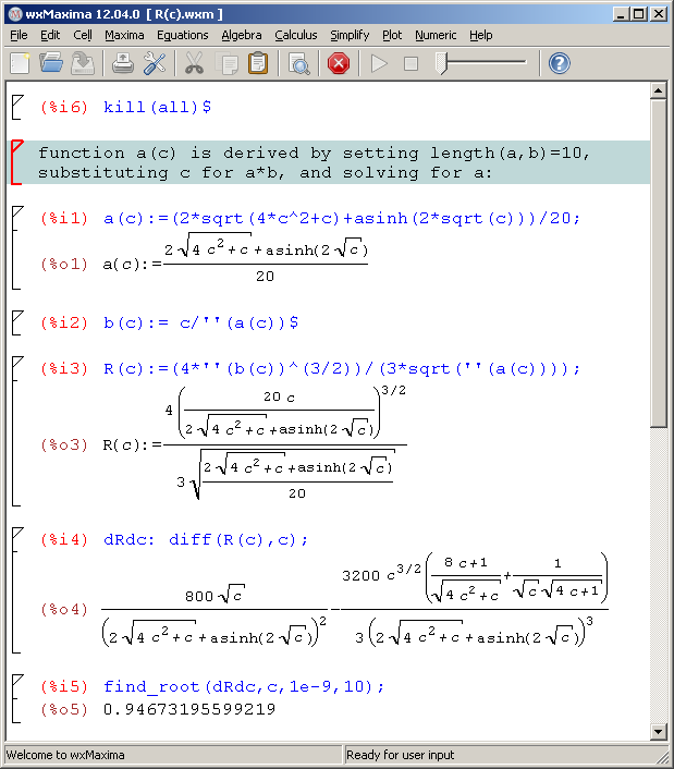

Using your R(c) method, a numerical root finder quickly converges to a precise value for c.
But you can get the same result without differentiating R(c), by simply plotting R(c) and locating the extremum.
I get 3 arcsinh(2 sqrt©) * sqrt(4c^2+c) = 2c+8c^2. I doubt there is a nice closed form of this.
