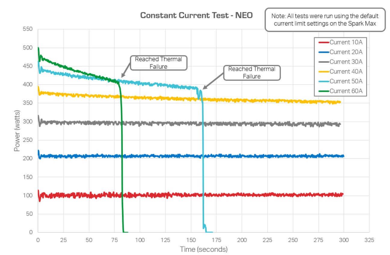

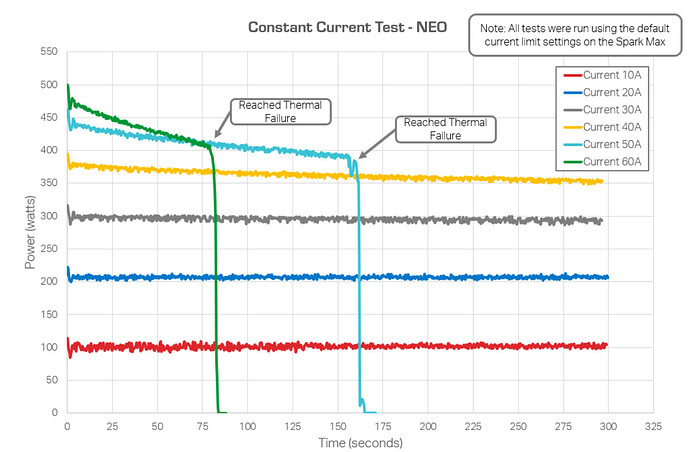

Good news, there is test data for how motors perform when under load for a long period of time.

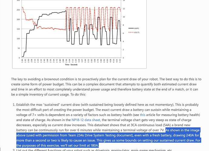

Researching battery brownout, I came across this page of the WPILib docs
which contains information about making a current budget. Since reading, I have been attempting to create a current budgeting system within our code base. However, I am unsure about how to decide the maximum current I should allow to be drawn from the battery at once. Their example, highlighted in the below image, uses 180 Amps as their data shows that 240 amps is dangerous.

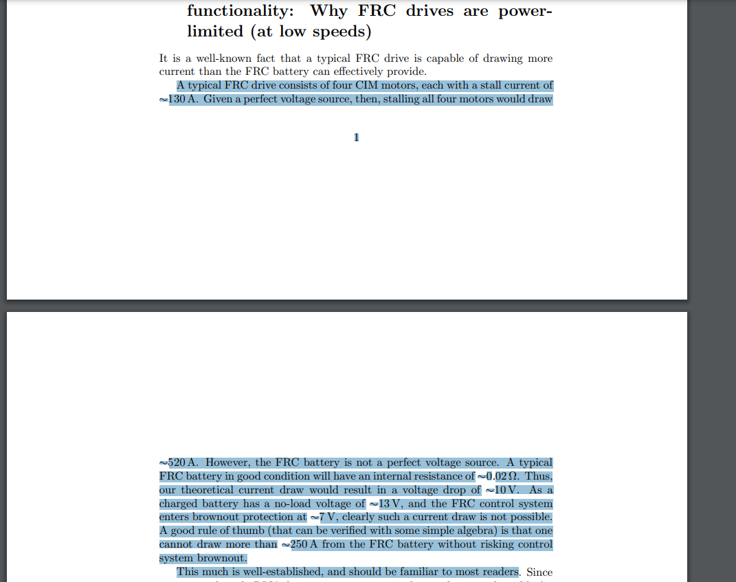

However, I became confused after reading this paper here on chief delphi: https://www.chiefdelphi.com/uploads/default/original/3X/f/2/f2c7116c9b8c3dd1bb1f95250289778af1ca36dc.pdf
On page 1 and two (the exact section highlighted in the photo below), they mention how it is "common knowledge) to not exceed 250 amps, making me think that a limit somewhere around 230-240 would be pretty good, a significant amount larger than 180.
My questions are the following: what is a reasonable number to have as a maximum total current draw on the battery, and how would I go about finding experimental value on my team’s individual batteries?

The main breaker is designed to pop at just over 120A after a few seconds, thats typically your first limiter. Honestly I wouldn’t worry too much about current budgeting above that level as if you’re pulling that much regularly something is probably up (or it’s a funky drivetrain).
Better to give each mechanism as much individual current as it wants/should have to enable best performance. Note that the main breaker allows ~200A for a brief period of time, they are quite forgiving.
It’s not a very technical solution, but letting physics limit the high current peaks is the safest way. Actually pulling 180-250A on an FRC robot for more than an instant is pretty hard. As more current is pulled from the battery it’s voltage drops off a cliff, soon it’ll hit 8V and the roborio will start cutting out. If that’s happening, limit current somewhere, aiming for about 10V max drop. Battery test units exist that can tell you the health of a battery (think Battery Beak is one?), useful to picking out pristine units for competition and other ones for practice.
If you really want a software budgeting system, aim to budget continuous currents not peak current. It has a bigger effect on the runtime/life of the battery. ~40A for drive and heavy mechanisms (climber, elevator), ~30A for stuff in-between (say shooters), 20A for light things like flaps or intake rollers. Consider which mechanism will run at the same time as each other less the total overall.
