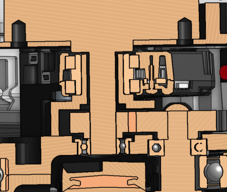

The throughbore is measuring the rotation of the outside of the cover of the drive shaft - not the drive shaft itself. The part that the thrubore is measuring is actually fixed to the azimuth, and is not rotated by the drive motor.

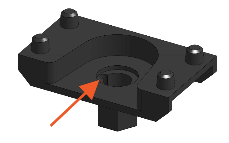

Not exactly the best view in the world, but you can see here (mostly) that the thrubore is not actually engaging with the NEO - there is a gap around the NEO shaft. The part that the thrubore engages with is this hex segment (image from REV docs):
This hex segment is fixed to the azimuth of the module.
