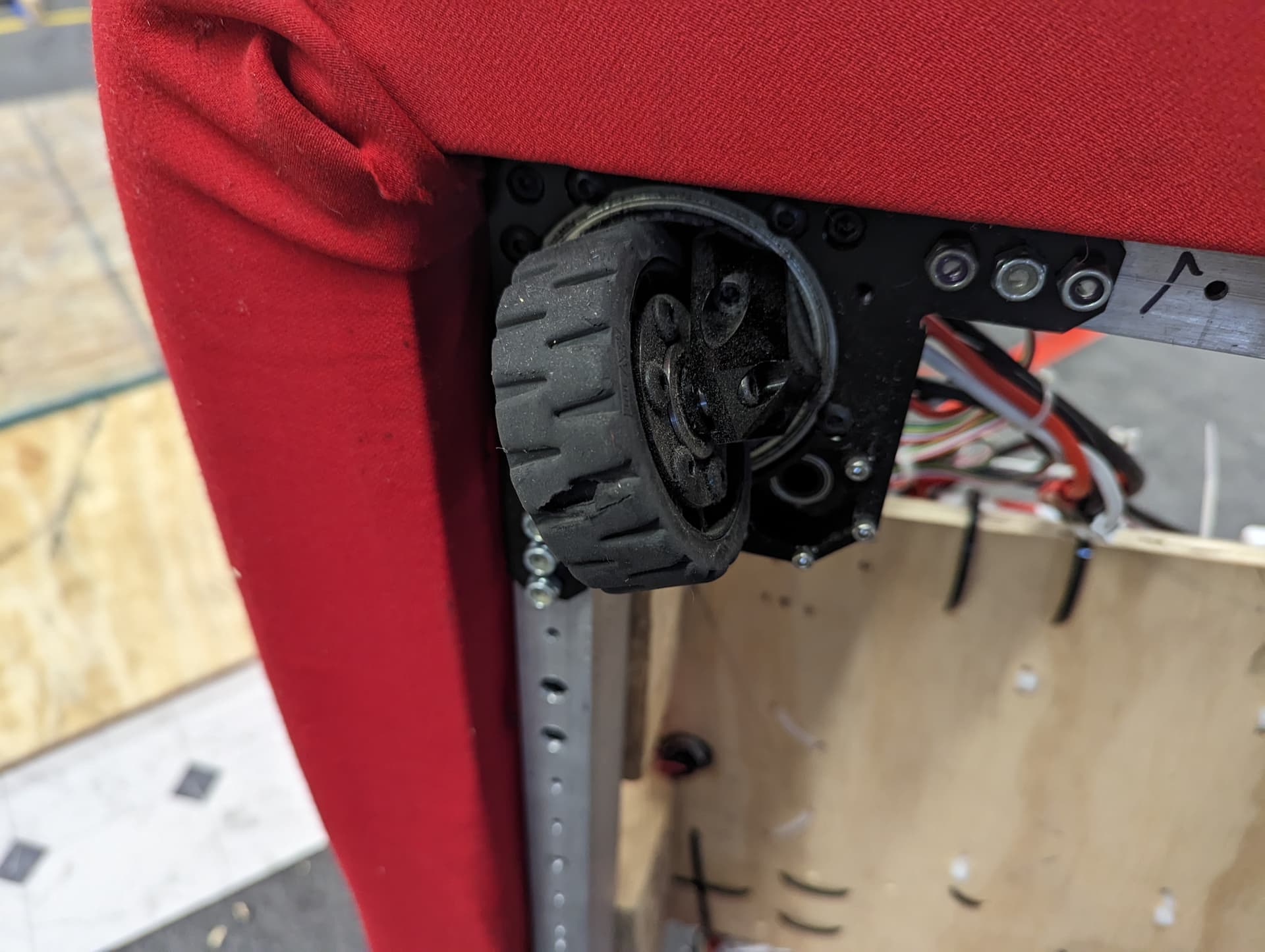

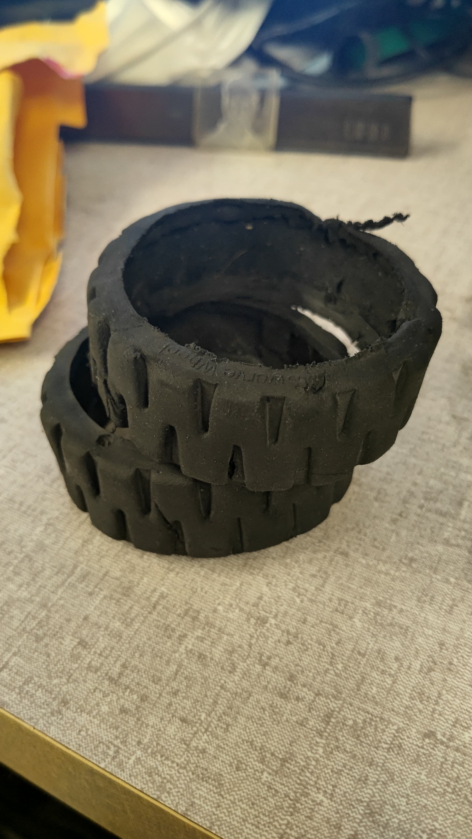

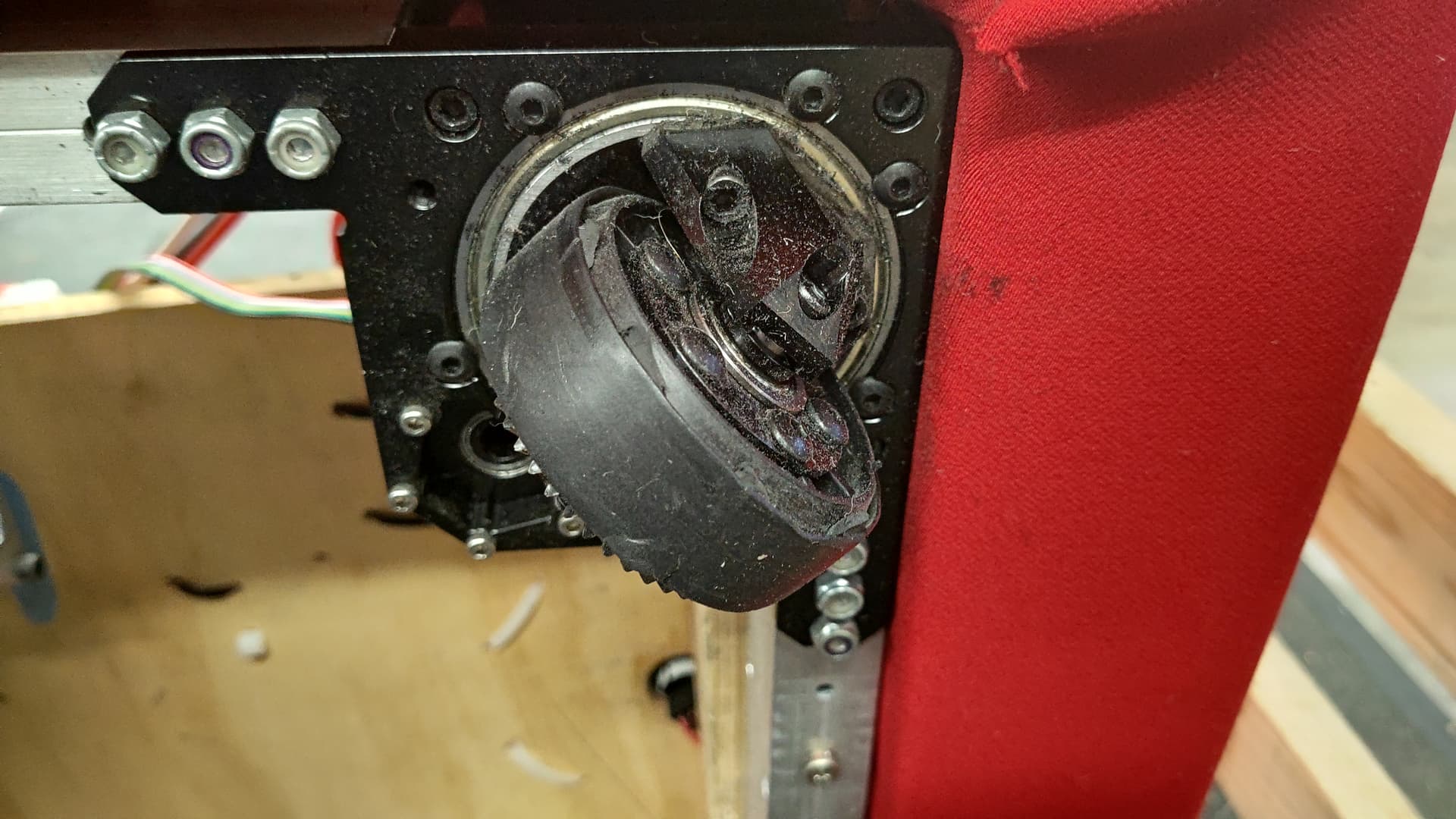

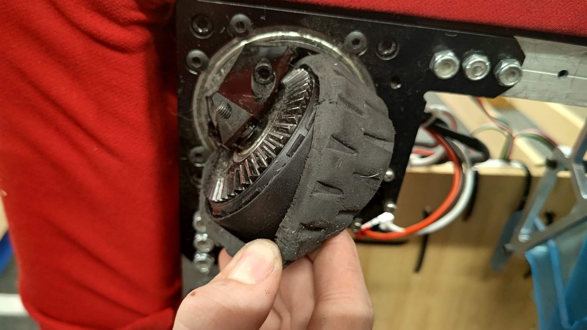

We bought 4 MAXSwerve pods for testing, and have had them running on a drivetrain for a couple of hours now. We’ve already had the rubber tread separate from 2 of the 4 wheels - see attached photos. Nothing out-of-the-ordinary in terms of driving - just a lot of back-and-forth feeding runs, including climbing and parking on our charging station. Has anyone else seen MAXSwerve wheels lose tread that fast? I see replacements online for $5 each, but if we need to be worrying about replacing wheels every few matches in competition, that’s going to quickly add up.
We have about 3 hours of drive time on our wheels, I would say about 1.5-2 regionals worth and are not observing that level of tread wear. However, we are running about 75 lb on our protobot at the moment, on carpet, and with the the 13 tooth ratio.
May I ask what robot weight, gear ratio and floor composition you are driving on?
Have you checked to make sure the swerve code is working correctly, and you aren’t introducing too much scrub on the wheels?
This bot’s just a drivetrain and bumpers - just threw it on a scale and it’s ~60lbs. Running on discarded competition field carpet from a couple of years ago.
This is with a 60 lbf robot including bumpers and batteries. We are using the stock max speed gear ratio. We are using revs base code with no additional tuning. We are seeing failure of our 3rd wheel as well.

The other issue here is the failure isn’t wear, this is the tread coming off. We also haven’t seen anywhere near comparable wear with our SDS modules seen in competition. I would be surprised if the rev modules make it through a single match with defense.

This isnt wear though. Our tread hasnt gotten worn down its still intact. Rather it has completely seperated from the wheel. I agree that tread wear is expected.
I’ll give ya that one, I was most definitely focusing on wear. I don’t have answers beyond what 2767 has done with overmolding (perhaps @Mark_Wasserman can comment on the durability of the plastic/overmolded interface). Eventually we found ourselves back to roughtop, and while not involved with 2767 this season I suspect roughtop is still the preference.
