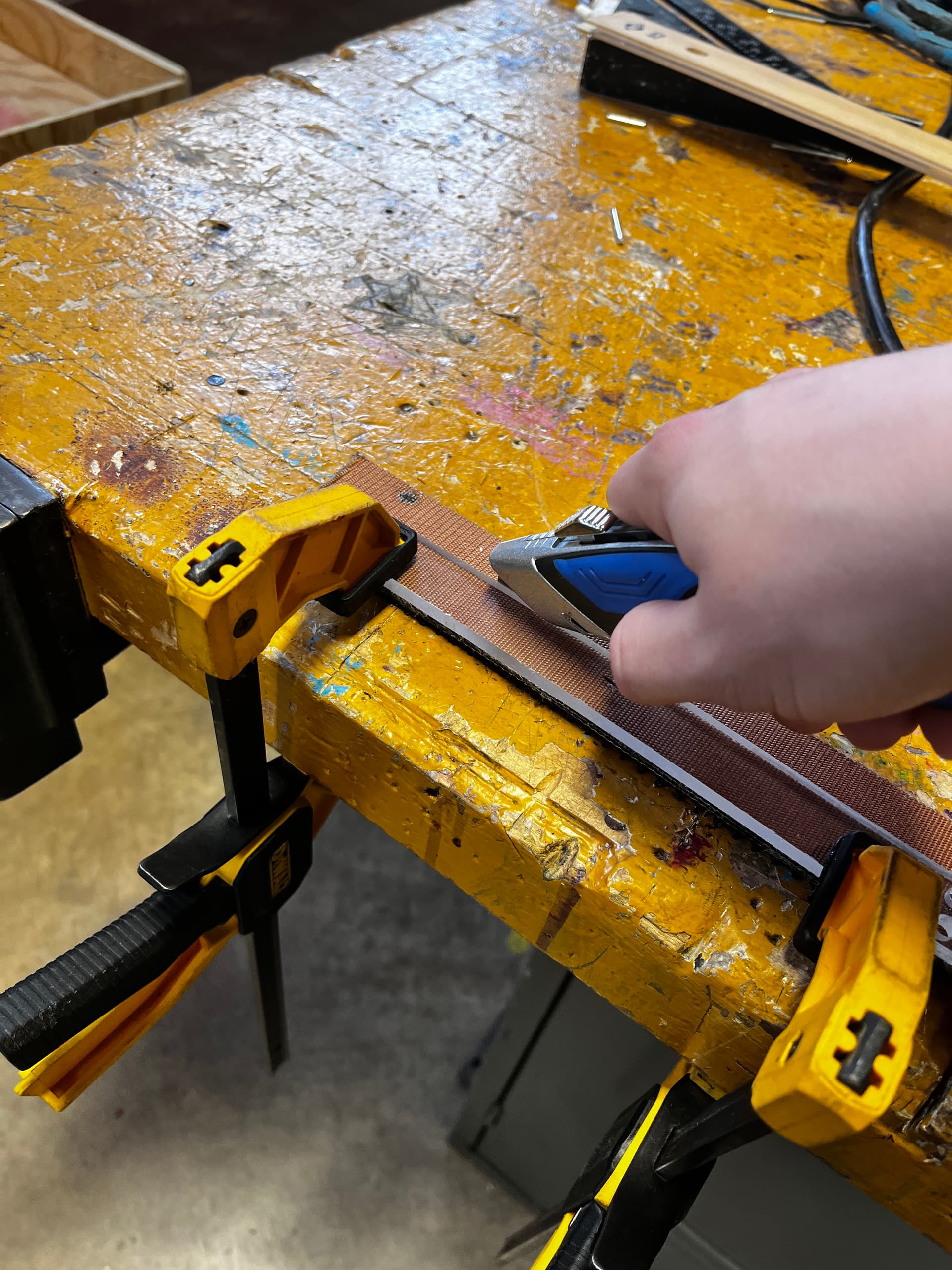

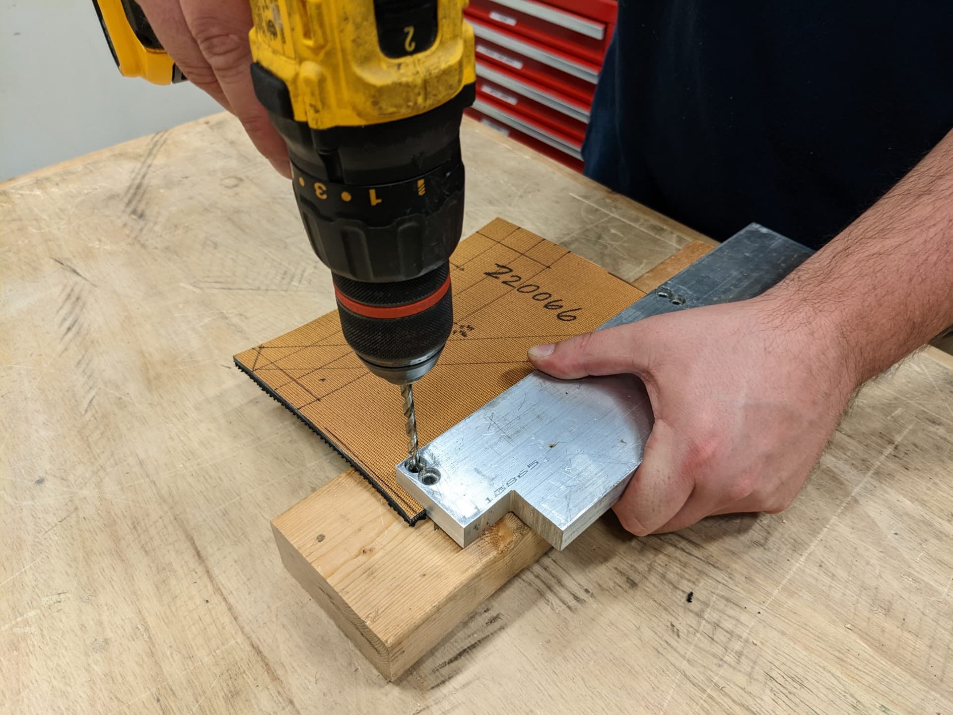

The aluminum wheels (we had rev version) with black tread from McMaster-Carr worked out great at CIR. We changed out one set just to be safe after 5 practice matches and 9 qualification matches at the end of the day Friday. We could have run them longer. In comparison, we went through around 30 standard wheels at Lake Superior, with some lasting 1.5 matches for us. The aluminum takes a beating on the charge station, so having an extra set of wheels is safest. It took a little extra tread to get the spacing right for mounting, so order some extra. A 3/16 leather punch or one size up worked well for us.
If you want to place the holes accurately, you can make yourself a version of our tread marking jig. Even if you are punching the holes, you could 3D print a version to mark the hole locations with a sharpie marker for punching.
That jig was very helpful for the end to where the holes are punched. We ended up just flipping it once we figured out the length, and marking the other side. Note: “make yourself a version” to get the correct length. The total length of tread we settle on was 8 3/16 possibly. I am going by memory as the student that has it all figured out is not around today. My memory is a scary thing, so buy a little extra tread.

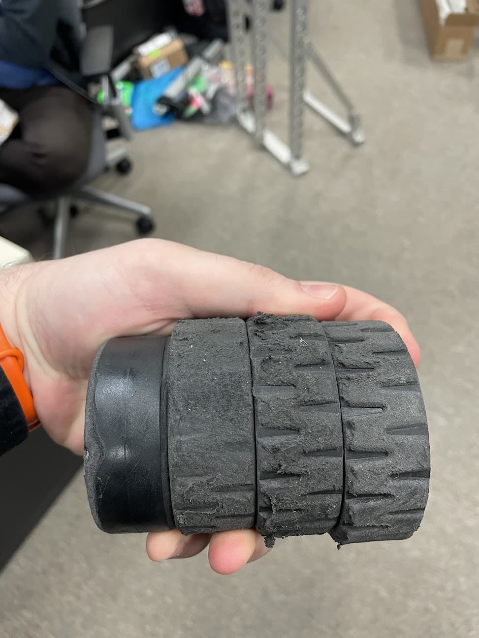

In the last week and a half, we’ve gone through something like 2.5 sets of Blue Nitrile Treaded Wheels, none of which got more than an hour or more of total “Robot On” time. That said, the specific tread had it’s own “Chunking” / “Delamination” type issues, not like we were running the wheels bald.

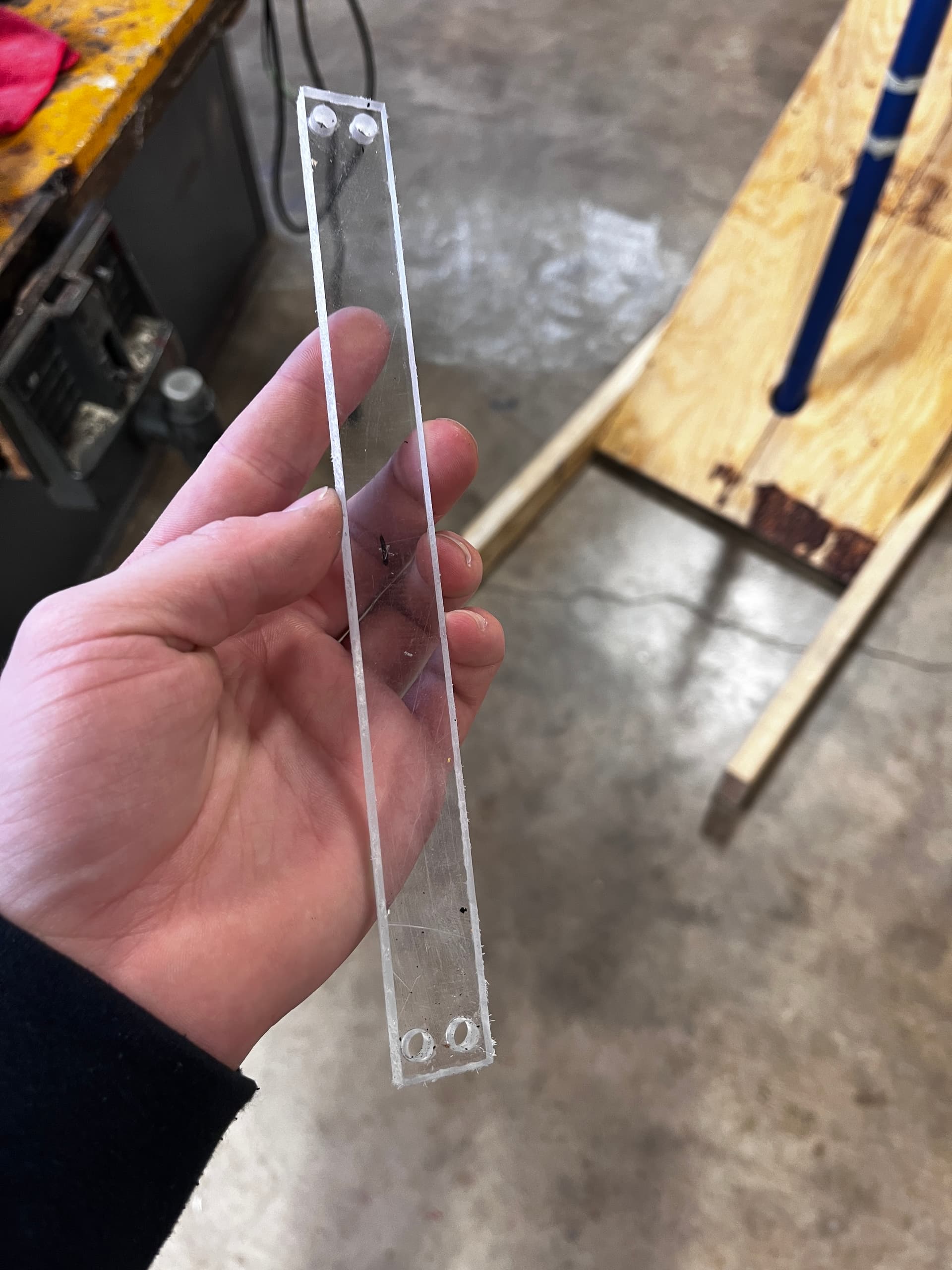

We were a little more limited with time and machining capability so we used a simple hand-cut lexan guide using REV’s tread drawing with no issues. Definitely requires a well cut plate but this works quick and easy for a full set of 4 treads + 4 spares!

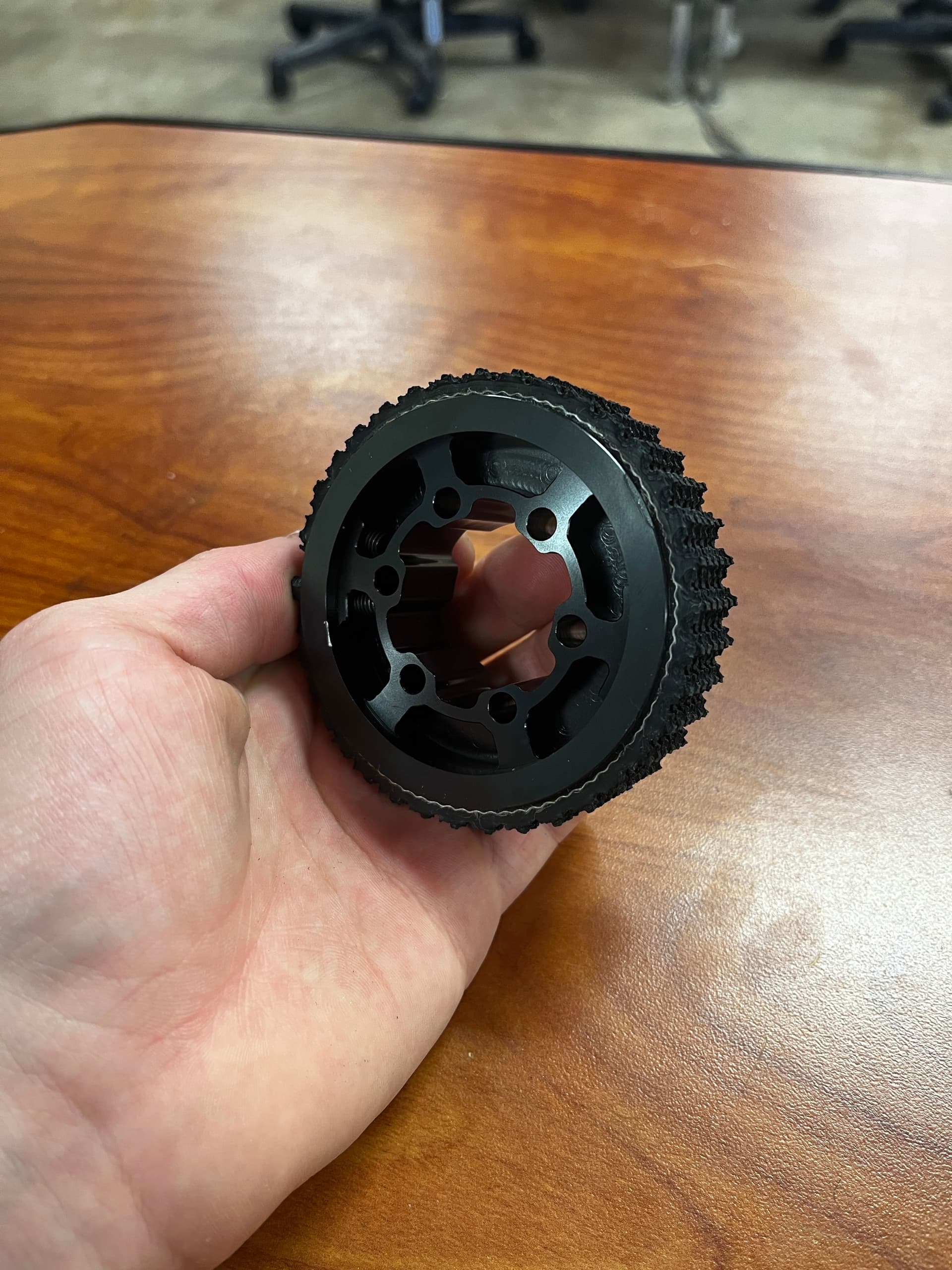

We 3D printed The model of the Thrifty bot aluminum billeted wheel (printed on a Markforged out of Onyx) and LOVED them, We later bought the Thrifty bot aluminum billeted wheels and haven’t had any issues
I gotta say overall I’m loving the MAX Swerve and Thrifty bot wheel combo (Plus they both come anodized black so how can you really beat that time saver lol)

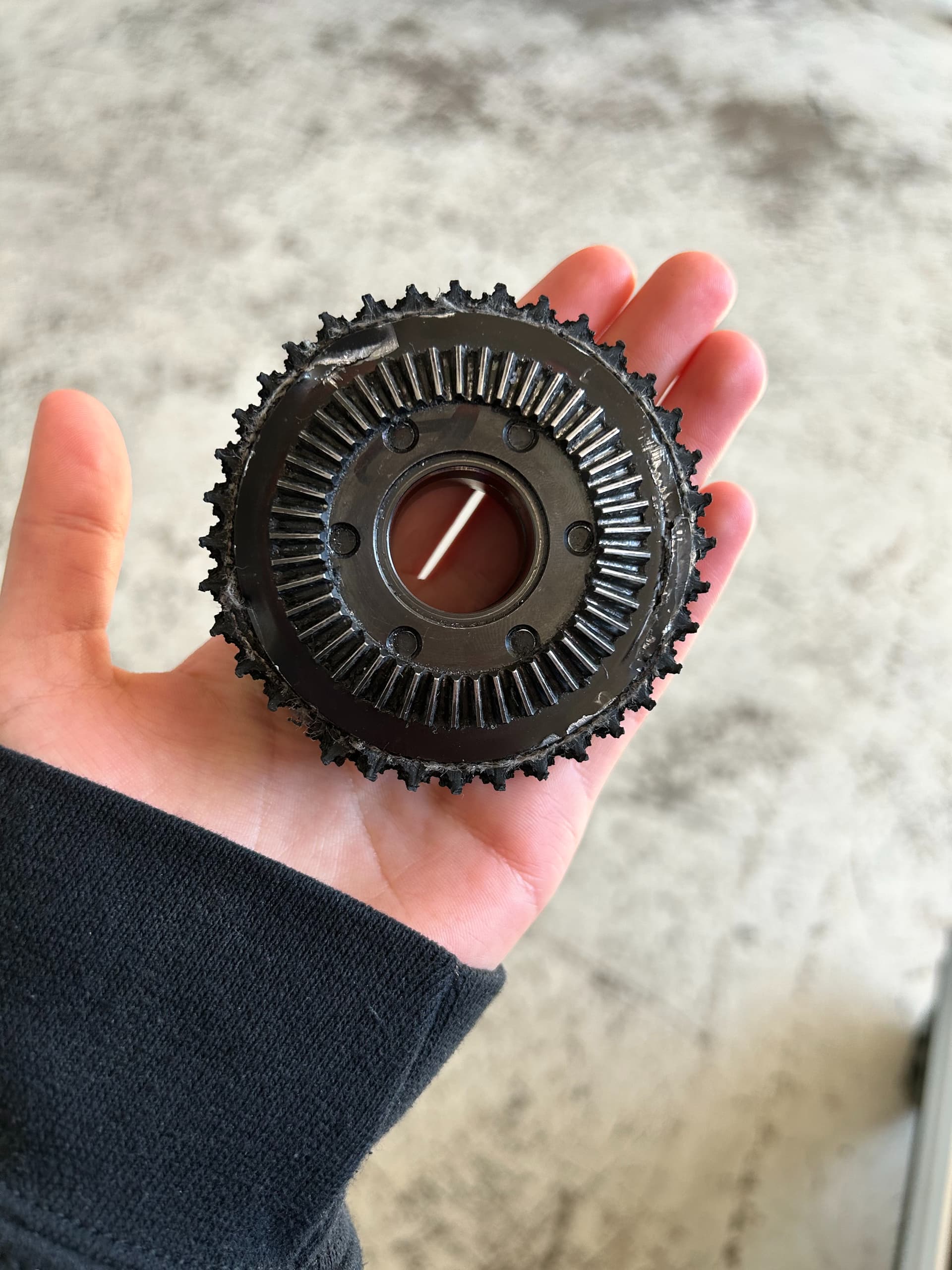

2nd the thrifty wheels. After 1 round with brand new rev stock wheels and lite defense one wheel had tread pealing and got caught in the module. We had to superglue and screw all the wheels and had to drive very lightly just to last the competition. Have had lots of good stuff from R.E.V. and did not expect the biggest failure point at comp to be the swerve wheels.
Of this seems to be a very common issue with the rev modules.
I know several teams who are running them this year and are experiencing the same problem.

A couple of notes here I thought I might share. Next we are expecting a large shipment of the REV metal swerve wheels. We will be sending out 1 wheel for every module purchased at our expense.

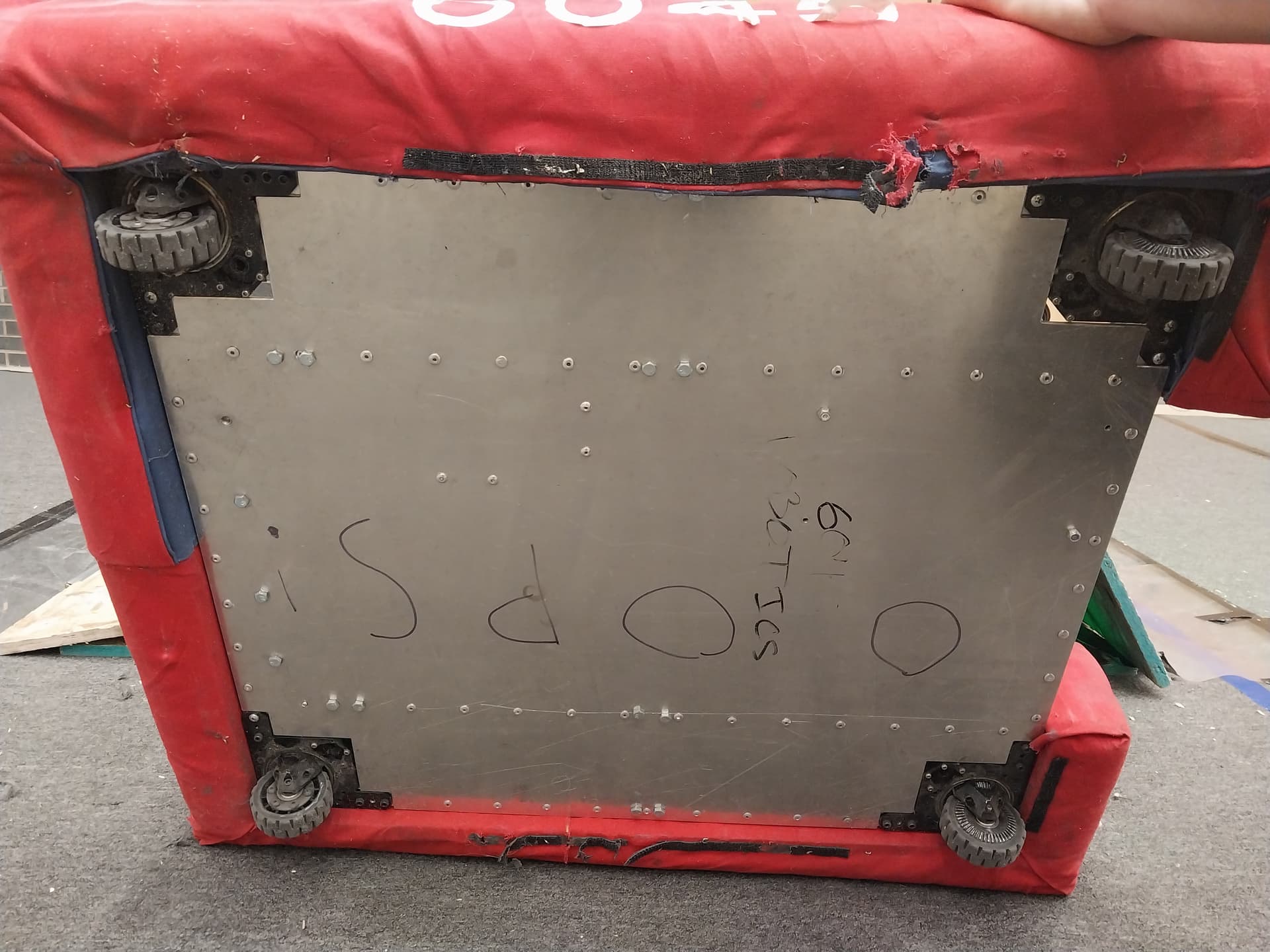

We are also deep in the testing of new molded wheels that are holding up much better to extreme use, and are wearing as teams would expect without peal-off until you wear completely through the tread.
One of our testing teams has been running matches with them and this is them after match 19
