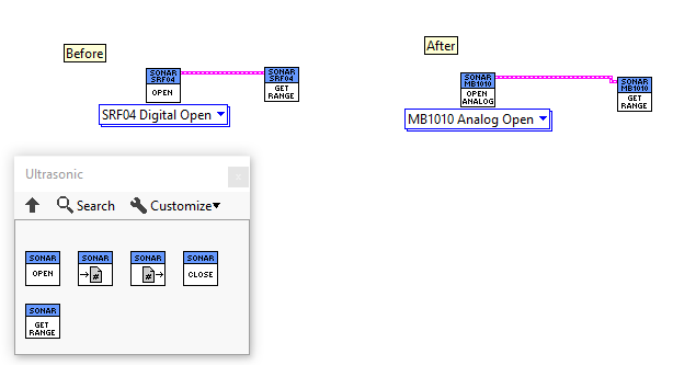

We are trying to set up the ultrasonic sensor mb1200 in analog. The older examples have a block for mb1020 get range. We are unable to find a similar block in the pallette. Do we have to create a new subvi ourselves to create a block on the palette. Or is there somewhere else to look for the block we need?
Just use the ultrasonic palette vis.
They change when you place them on the block diagram, wire them in, and pick the right device.
These are called polymorphic vis and they are actually a collection of vis that are selected from based on the input data types.
Thanks. Is there a way to know which blocks are polymorphic?
A lot of the ones we use are polymorphic.
You can right-click on a vi to get the pop-up and if it has a menu entry for “Open Polymorphic vi”, then it’s got several variations associated with it.
It’s how LabVIEW deals with vis that are fundamentally the same common action, but require dealing with slightly different mixtures of data types.
Any of the Open vis with that selection box under it is polymorphic for each of the possible selections, as well as, any downstream vis that deal with the differences.
For example, the WPI Library Opens where you need to select the type of motor controller attached.
