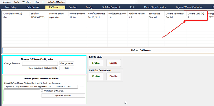

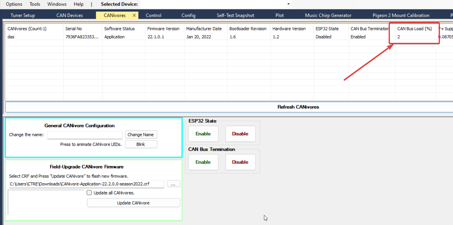

Measuring CAN bus utilization on CANivore
Was taking a look at the CANivore user guide and in it it’s mentioned that you’re able to measure the can bus utilization (presumably on the CANivore?). How would I go upon measuring the util on the CANivore if it’s possible?
