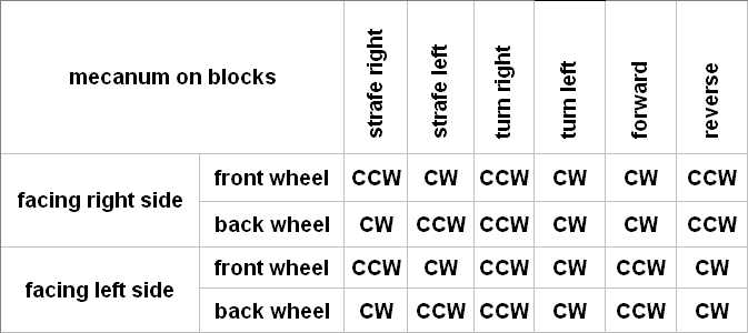

In our testing for the past few days, our mecanum drive has been exhibiting some weird behaviors when strafing and rotating. First, when I strafe, the robot basically acts as if it is rotating around a single wheel. The robot will go diagonal and then rotate more and more until the robot is doing circles. When correcting this with counter rotation (with gyro and manual joystick) in order to get the robot to strafe straight the top wheels are almost stalled out while the rear wheels are going full speed. For rotating, the robot moves in an arc-like fashion instead of rotating in place. We checked on blocks that the wheels are moving correctly. Also, even though our robot looks to be very front heavy, we found the center of mass is very close to the middle of the bot. If anyone has any possible solutions please let me know. I want to see if there are any solutions that we have not tried that are not hard to do before we start replacing any wheels, gearboxes, motors, etc.

Have you checked the wheels are the correct orientation? They should form an “X” shape when viewed from above.
