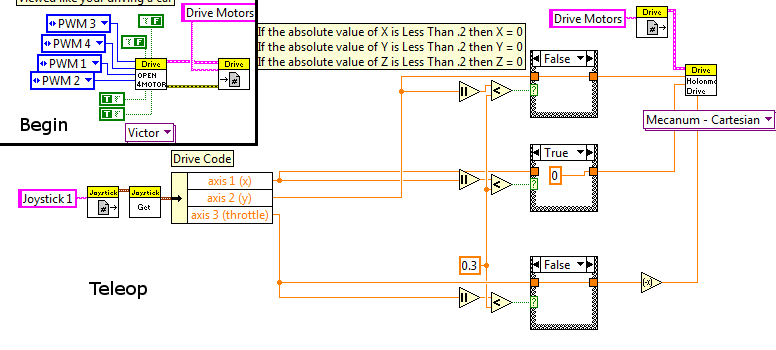

Here is the code we are using I have the begin in the upper left hand corner and the teleop is the rest of it. I have tried different combinations of the true/false constants to invert the motors and I can get the rotate to work when I change them to how (i think) they should be (one side inverted and the other not). But then the forward/reverse/diagonals/strafe don’t work.
I checked the wiring (polarities and PWM’s) and nothing was wrong there.

Which PWM channel do you have going to each motor? I can’t be absolutely certain, but your code seems to have it this way:
PWM1: front left (inverted)
PWM2: front right (inverted)
PWM3: rear left (not inverted)
PWM4: rear right (not inverted)
It’s rather odd to have both front motors inverted and neither rear motor inverted. One typically sees only the right motors inverted, or occasionally only the left ones. The other common situation is for none of them to be inverted and have the compensation occur in the wiring.
It still looks to me like you have your front left and rear right motor controls swapped.

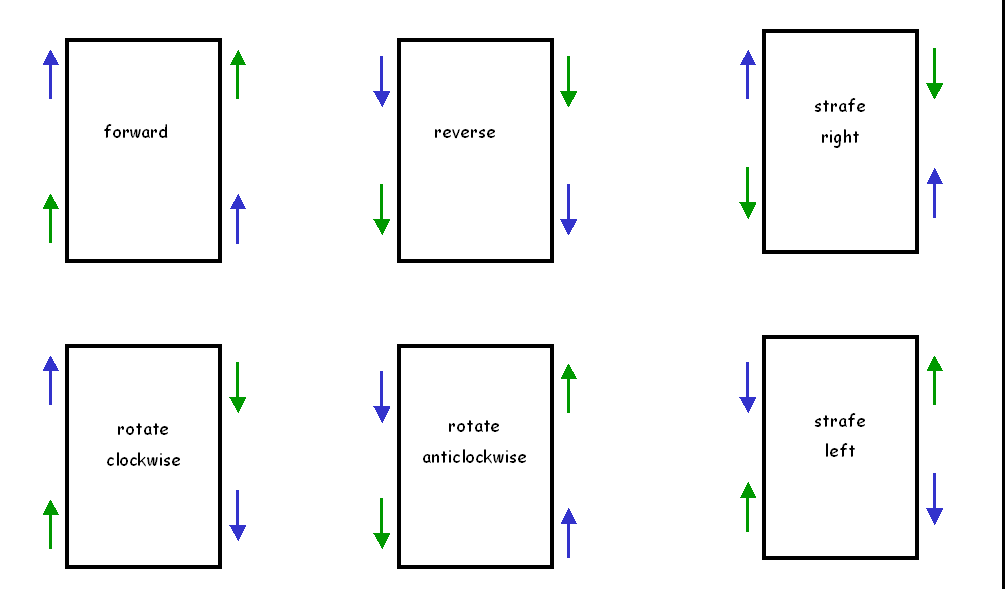

See attached drawing. Notice how the diagonally opposite wheels are always turning in the same direction as each other for forward, reverse, strafe left, and strafe right motion. But they go in opposite directions from one another for rotation.
Trace the wiring back from each front motor to make sure it isn’t being controlled by the diagonally opposite rear wheel command.
Also, are you using home-brew code or the WPI Holonomic Drive vi? Cartesian or Polar?
I got fed up and decided to go through every inversion possible (all 16 of em’) and on the 10th one it worked (yes I ran from robot main 10 times). The correct inversion is Rear Right and Front Right inverted and the left ones not inverted.
Yep, that’s what I said was the typical setup.
But that can’t be the only thing you changed, can it? The robot was reportedly driving forward fine before. If you now have different Motor Invert settings with the same wiring, some of the motors would be running the wrong direction when you tried driving straight.
