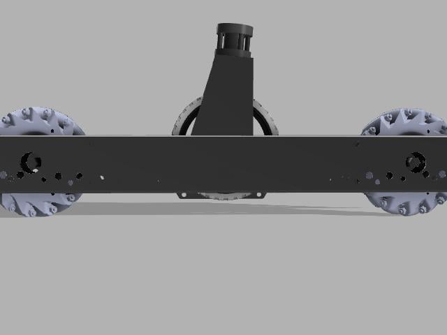

Mecanum-Traction Hybrid Drivetrain
Do you worry about stripping the gears that mesh with the traction wheel when you deploy/undeploy the wheel? It looks like they disengage and if that happened while driving I’d think the drivetrain would throw up gearteeth
This looks kinda like octocanum but with one traction wheel
tbh with all the prebuilt swerve modules + code out there this might take more resources to develop
Yeah, I’ve though about that and while it could happen, the gears mesh before the traction wheel hits the ground so there won’t be any rotational load on the wheel when the teeth engage, and if we put flow control valves on the pneumatic cylinder to sort of ease the gear down, it should be able to engage without damage, at least at lower speeds, but I could be wrong.
even without rotational load when the pneumatic pushes the wheel down I imagine that there would be some damage to the teeth
Neat idea, but I agree that the gear engagement and motion following gear engagement is a problem. Perhaps you could drive a differential from each of the front and rear wheels to drive that center wheel, using a belt or chain with tensioner so it can take the slight change in distance.
If I’m picturing it right, the differential would have bevel gears facing each other, with a planetary arrangement of bevel gears on “spokes” which are free to rotate on their own axes/spokes but which drive their carrier which turns the wheel. The solid wheel would always turn at the average of the two wheels which drive it.
The problem is that the front and back gear sets won’t likely be synchronized when the wheel comes down. One will engage, regardless of the relative position of wheel gear and drive gears, but the other is all too likely to be in the wrong position. Then you have two driven gears that are not in sync. That’s pretty much a recipe for ground gear.
I think it would be easier to have the center wheel drop down using a swing arm like the Octocanum and then you have a constant center to center distance that you can use to keep a belt or chain or gears engaged regardless of whether the wheel is up or down. Yes, the wheel will be spinning when not needed, but if it is not touching the ground, that should not be a huge drag hit.
You only really need to drive the center wheel from one end. You could easily “lock out” strafing in code such that both the motors on one side would be driving in the same direction at the same speed. you won’t get quite as much pushing power if you are motor limited, but if you are traction limited, it won’t matter if the center wheel only gets the power from one motor or both.
If you are going to do this, I suggest just doing a semi-octanum, putting the traction wheel rather closer to one end than the other, and powering from the nearer wheel. This way there will still be some weight on the “solo” mecanum wheels and those motors will be able to help.

I like the idea of using one or more belts to turn the center wheel, and I drew it up similar to what @wgorgen suggested (correct me if I’m wrong) where the wheel is driven from the motor on the right side of the picture and is actuated down using the same pneumatic mechanism that the original used, just angled about 5 degrees to the right.
MecTraction Belt Version
I am thinking about doing something like @GeeTwo suggested and moving the center wheel closer to one side but I’m worried that doing so will move the robot’s center of rotation when the wheel is down and mess up its position tracking in auto. Will this be the case?
One of the objectives of this project is to maximize pushing power when the center wheel is engaged, and since mecanums only transmit ~70% of torque forward because of the angled rollers, it makes the most sense to me to take as much weight as possible off of them and onto the traction wheel. Using the pneumatic cylinders in the drawing (1 on each side) gives a total force against the ground of 94 lbs. Assuming the robot is 150 lbs, this means that the total efficiency would be ((94x1)+(0.70x56))/150 = ~89% efficiency. If the wheels were moved closer to one end, the amount of force they could exert would decrease when they would eventually be able to lift up that side of the robot (the cylinder has enough throw for the center wheel to extend .125" below the plane of the two mecanums). The point at which this occurs would naturally depend on the robot’s CoM. Is my reasoning and math correct or does it not work like this?
Finally, in regards to using an omni wheel in the center, I have always had the notion (correct or not) that omni wheels are worse at pushing straight forward than normal traction wheels. Is this true?

The issue with putting all the weight on the traction wheel when driven from one end is that you are then only driving with half of your motors at that point.
I doubt you’d want to use the hybrid mode for auto; I’m not sure how repeatable anything but a straight line would be. In any case, mecanum should provide enough traction for most auto routines.
That’s true. Pushing with only two drive motors sounds like a recipe for a blown breaker – or worse. I suppose this could be partially circumvented by using a shifter gearbox in high gear for normal mecanum operation and then shifting into a (very) low gear in order to push, but that is likely only adding a lot of complexity and weight for a very marginal increase in performance.

That is a good point about the power. We were just concerned about the mechanical linkage between the front and rear wheels. We thought we would lose the ability to strafe if they were linked.
