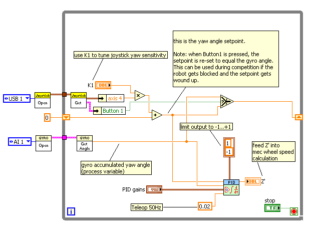

Our team is in the process of playing around with a prototype mecanum chassis. We have a gyro installed and are trying to use it to correct for rotation errors (to drive straight).
Currently we are using the raw gyro rate (g) and the input from joystick (z) to feed the following logic …
z’ = k1 * (z - (g * k2)) + z
K1 is a P constant
K2 is factor to convert deg/sec to something in the -1 to 1 ballpark
It works, but not as smooth as we would like. We still get some drifting, but other times you can see it correcting (especially when we inflate k1).
Are we on the right track with out logic? do we just need to tweak constants more?
Do we need to filter the gyro input?
Anyone want to offer up some sample Labview code?
Related to the error correction, the team saw Team 1058’s awesome mecanum video - where the robot corrects its rotation after impact. Does that (high freq) need to be handled differently that rotation drift error (low freq)?
Should we build our logic using the accumulated Gyro Angle variable? have the error correction work off the difference in the desired angle and the gyro angle? Seems like using the Angle values would cover both the Drift and Impact scenarios. But, how do you go about accumulating a desired angle from the joystick inputs? you would need to know the sampling time of joystick.
Any help would be much appreciated

What you really ought to look into is PID (proportional, integral, derivative) control - there have been a ton of threads on ChiefDelphi over the years on the topic (search for “PID” and you should see them). All three of the FRC languages have facilities for making PID control fairly painless.
Right now what you have is essentially a proportional-only controller (you have feedback on the error between your desired yaw rate and your actual yaw rate) with a feed-forward element (your command gets added to the output) acting on yaw rate. As you observed, this works okay in certain situations (especially with a high P constant - k1 in your case). However, at some point, raising k1 will start to make your bot thrash from side to side as it oscillates around your desired angular rate - it is simply going too fast as it gets near its set point. The “I” and “D” parts of PID address this issue, as well as steady-state error (when your bot knows it needs to turn one way or another, but the proportional part isn’t enough to get it to actually get there).
I would recommend using the accumulated gyro angle rather than the instantaneous yaw rate because usually it is yaw you actually want to control rather than yaw rate. Even more specifically, you usually want to maintain a CONSTANT yaw (keep pointing in the same direction) when you aren’t moving the rotation joystick axis. Usually when you are using the rotation axis, you can get away without feedback control (the driver will take over in that case). In other words, I would suggest some logic like:
If Z is not close to zero
     Just apply Z to turning
Else if Z is close to zero
     Use PID to adjust Z to keep the gyro_angle at its current value
end
To address these issues, you can try a somewhat more complicated approach.
Take your Z-axis (yaw rate) command from your joystick and integrate it (with a gain tuning constant) to create a yaw angle command.
Take the accumulated yaw angle measurement from the gyro and subtract it from the yaw angle command to form the yaw angle error.
Now you can feed this yaw angle error into a PID. The output from the PID is your modified yaw rate command Z’ which gets sent (along with your fwd/rev and strafe joystick commands) to your mecanum logic which converts them in to the four wheel speeds.
Attached is an example LabVIEW implementation.
I’m not an experienced LabVIEW programmer but I think this is correct.
Note that with the LabVIEW PID vi, you feed in the setpoint and process variable, not the error.
The vi also does the output range limiting for you.
The constant K1 adjusts the sensitivity of your joystick Z-axis command.
The Z’ output from the PID is your controlled yaw rate command which gets fed into your mecanum wheel speed calculation along with the fwd/rev and strafe joystick commands.
To tune the PID, try starting with proportional only.

The example is excellent, but is missing a WAIT function. The input to the PID function overrides automatic delta time calculation, but does not actually slow the loop down.
Note that you are not restrained to the 50hz loop rate. If you want your PID to respond more quickly, you can increase the loop rate. 50hz is simply the maximum rate you can receive new data from your joysticks.
Thanks for pointing that out Marshal. I’ve made a note to update and re-post the attachment.

Thanks for all the great feedback. We tried out the example VI last night. We inserted it in the Timed-Tasks area with a 20ms wait loop.
We had to debug some other problems that ate up much of our time last night, but once we got past that it sort of worked. PID gains were VERY sensitive. We had lots of trouble getting a stable AND responsive control loop. Tried using a P-only loop, but responses ranged from 1) robot studdering to get to desired angle or 2) robot overshooting and wildly rotating back-forth. Had to keep P<0.02 in order for it to be stable (but not really responsive). Will try tweaking the gains more next week. Have others had this much trouble tuning a PID loop?
Tell us a little more about your vehicle. What size and kind of mecanum wheels are you using; how are they mounted (can you post a close-up picture to go along with your words); are the rollers contoured and do they spin freely. And are you using direct-drive or chain drive, and how much free play is there at the wheels (ie if you lock the motor shaft, how much - what angle - can you rotate the wheels back and forth).
Before you do any more with the software, make absolutely sure your hardware is correct. A “stuttering” turn is sometimes a sign that you have your mecanum wheels mounted in the wrong orientation. The rollers contacting the floor should make an “O” or diamond pattern; they should look like an “X” from above.
Also make sure you understand what the inputs to the LabVIEW PID block mean. I haven’t looked at it in over a year, but at that time the I and D parameters were not gains. They were time values. That scheme is just as easy to tune as a gain-based one, as long as you recognize that a smaller I or D value yields a stronger response than a larger value.

Oh. My. Gosh.
We’ve been using labview since FRC started using it, and I never even thought to check it: I just assumed it was a normal non-dimensional gain number that would act the way most PID setups expect it to act.
During this year’s game we had a very robust targetting system in real time that would turn the robot and shoot after pushing the fire button. However, we removed it because we could not tune in the I and D portions to get the level of speed required: it was slightly slower than our driver’s aiming and therefore wasn’t effective.
I feel very, very silly right about now. :o
