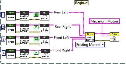

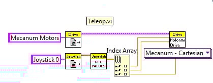

This doesn’t have to be as complicated as the presentation is making it. While there are some great ideas in there, they aren’t absolutely necessary. We use mecanum more often than not, and we do it like this:
In begin.vi, open a 4-motor drivetrain. In teleop (and autonomous if you’re planning on moving then), rather than using the Arcade or Tank robotdrive VIs, use Holonomic in Cartesian mode. X axis is strafe left/right, Y is forward/backward, Z is rotation clockwise/counterclockwise - attach to your joystick axes as desired. That’s all you have to do to get basic movement.

The VI that you want is on the robot drive palette, and is labeled holonomic drive VI, as has already been stated, just wire it up and it works.

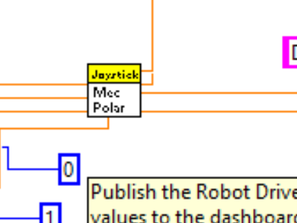

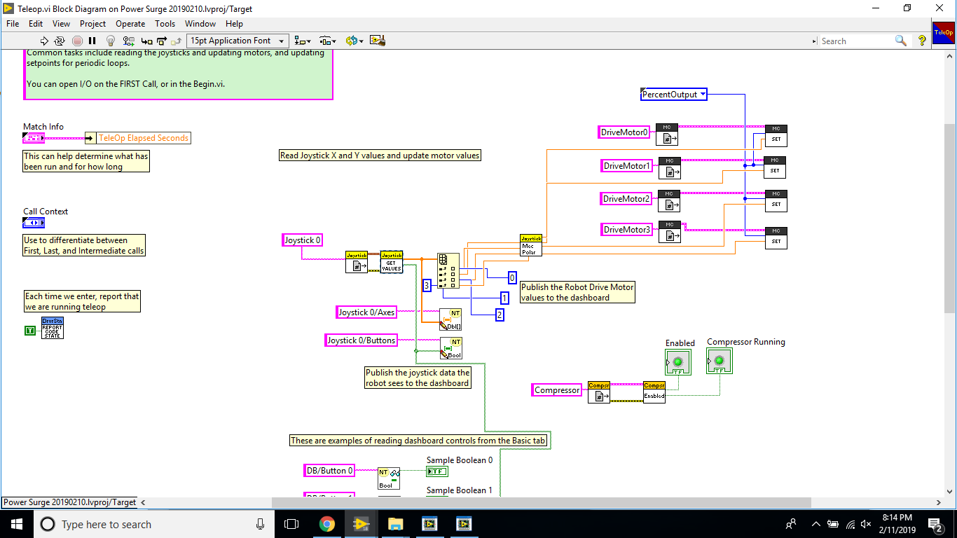

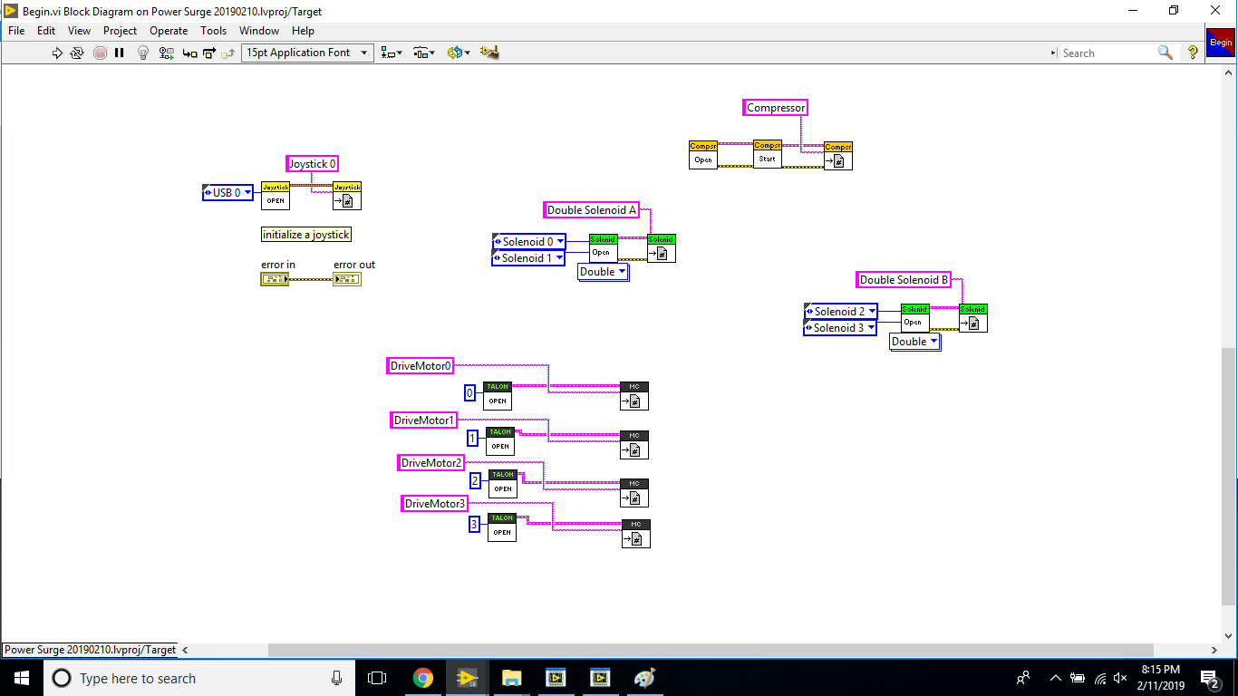

Can someone please help me figure out what is happening. When I use the joystick it goes allover the place. Forward is right, back is left, right and left do nothing, z-axis left goes forward, and z-axis right goes backward. I’ll attach my code to this comment. Thank you in advance!
I’d suggest a different approach, e.g.,
MechanumBegin
MechanumTeleop
except use axis 3 for the rotate as you have above.

The issue you were likely having is that you are using the Polar mecanum joystick mapping, which takes a magnitude and direction (polar joystick coordinates). You were giving it x and y (cartesian) coordinates which caused the erratic behavior. You should generally be using the Cartesian mecanum functions.
Definitely sounds like you did’t have the left side motors set to inverted.
If you look closely you can see that I am using Cartesian
I don’t know about you but that looks like polar…
