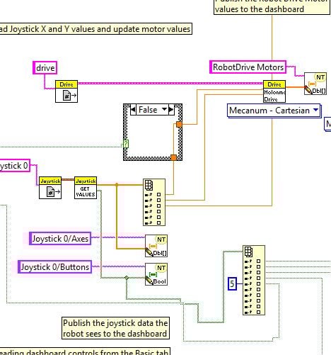

How can I wire a button to cut power in half with mecanum drive?

Why do you want to do that? What is the problem you’re trying to solve? If you don’t give details like that you may receive bad advice.
#14
Trying to have a little finesse with drive when backing in to the lift… in panic mode… our driver hasn’t been able to practice with all the programming issues we’ve had… and now won’t be able to until competition … and we need some programming options
#15
You should just be able to use the joystick to proportionally control, but if not, you could put a case structure in line with your axis, with a button controlling it.
Inside the true case you would multiply it by .5 or whatever scaling factor you want, inside the false case just wire it straight through.
#16
Does this look right?
#17
her is a shot in false
#18
In the True case, I would take the value from the joystick axis, multiply it by the 0.5 you already have in the case structure and then send it out to the holonomic drive block. This way the driver still has control over the robot if they want to go slower or reverse, but they can only go up to half speed.
Your False case looks correct.
You may want to consider doing the same with the rest of the axes.
