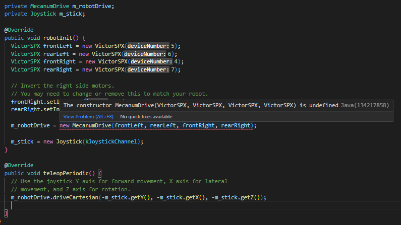

We are trying to get our old bot able to drive again but have ran into some weird issue
Code: https://github.com/Snake5151/Mecanum/blob/main/Robot.java
Any help is appreciated im very confused from it Thanks

In order to use the MecanumDrive
class and other WPILib drive classes with CTRE, you have to use the WPI_VictorSPX class in place of the standard VictorSPX
Are your Victor SPXs connected via PWM or CAN?
we are using Can
This seems to have fixed the issue thanks alot!
If you ever move from Victors to TalonSRX or TalonFX (falcons) it will be the same thing with a WPI_ prefix. The Victor SPX doesn’t support direct encoder feedback like the other two. That might be useful for mecanum control.
