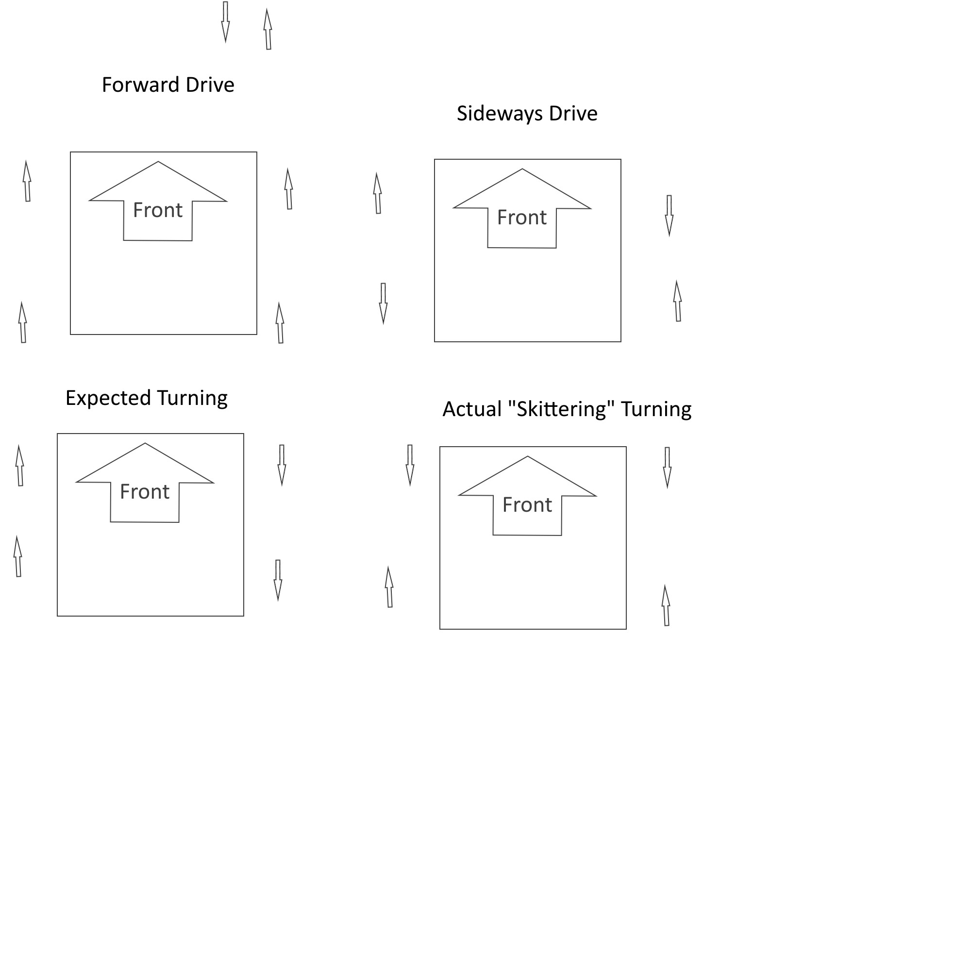

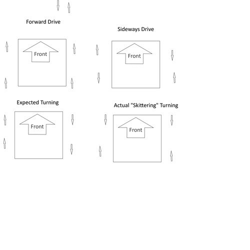

^ The above is an image that displays the intended/actual behavior found in my team’s Mecanum code.
Our Team’s Forward/Backwards and Left/Right strafing works great. However, when trying to turn using wpilibj’s MecanumDrive, the wheels spin incorrectly and the robot basically sputters in place.

Likely two motors that are diagonal from each other are swapped. Notice how diagonal motors have the same rotation direction in forward and strafe mode, but not when rotating.
Double check CAN IDs

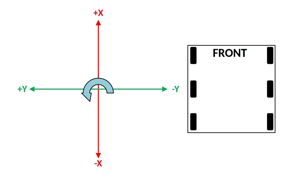

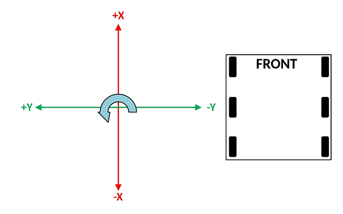

This code probably isn’t driving the robot the way you think it should.
  • Robot forward is positive X
  • Robot left is positive Y
  • Robot rotation is counter-clockwise positive
Joysticks, on the other hand, are:
  • backwards is positive Y
  • right is positive X
Joystick values are rotation around the axis:
So, you need to invert the values from the joystick. I also recommend matching the variable names (you have x named y, and y named x)
double x = -controller.getLeftY();
double y = -controller.getLeftX();
double turn = -controller.getRightX();
drive.driveCartesian(x, y, turn);
Building in the problem above, you probably have your motors inverted incorrectly. With your code, when you push forward on the controller, the robot should move backwards. When you press to the right, the robot should move left.
The fact that the robot appears to moving the right way is probably an indication that your motors are not inverted correctly. Positive output should make the motors drive forward. Incorrect inversion would appear to work for forward and backward, but would not work for rotation.

The axes are the same on an XBox controller as they are on a large joystick.
This is unusual, but it depends on your robot build. Usually the right side is inverted, and the left side is not.
Are you 100% sure that positive output on the motor results in forward motion of the wheel?
This is wrong, unless you want to push the controller stick toward you to drive the robot forward. Positive input from the left Y is pulling the stick toward you. Pushing it away from you is negative.
I think you’re saying you have to invert the input from the left stick, that would be correct. Pushing the left stick to the right will result in postive X input, so it needs to be inverted.
Positive input from the right stick is pushing the stick to the right. It needs to be inverted because robot rotation is CCW (left) positive.
This is because you’re telling the MecanumDrive class you want to move in a different direction than you intend. It’s up to you if you want to leave your workaround and move forward, but I highly recommend getting it fixed properly. If you want to implement odometry, pose estimation, or path planning for autonomous, you’ll need to keep implementing workarounds throughout the code if you don’t use the correct coordinate system.
It seems like you don’t believe I am correct, so I’ll include some references. You can also look in Driver Station while you move the sticks around, and confirm the behavior with your robot’s motors.

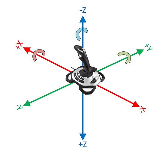

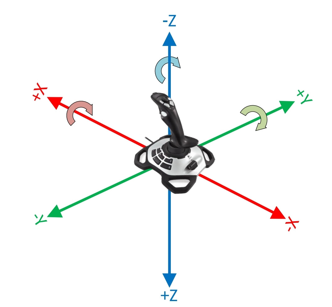

The drive classes use the NWU axes convention… The positive X axis points ahead, the positive Y axis points left, and the positive Z axis points up…
Joysticks follow NED (North-East-Down) convention, where the positive X axis points ahead, the positive Y axis points right, and the positive Z axis points down. However, it’s important to note that axes values are rotations around the respective axes, not translations. When viewed with each axis pointing toward you, CCW is a positive value and CW is a negative value. Pushing forward on the joystick is a CW rotation around the Y axis, so you get a negative value. Pushing to the right is a CCW rotation around the X axis, so you get a positive value.
m_robotDrive.driveCartesian(-m_stick.getY(), -m_stick.getX(), -m_stick.getZ());
Important
Forward on joysticks is the negative direction. Teams often negate the values when reading joystick axes to account for this.
