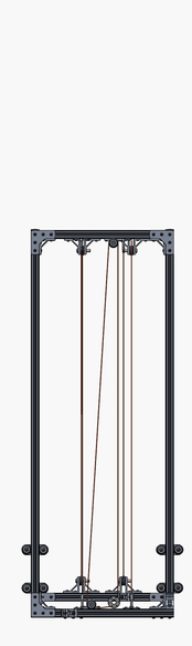

What would be the best way to achieve a mechanically retracted elevator system that doesn’t rely on gravity? I’ve prototyped a continuous elevator design but even with a closed loop tension is released when trying to retract.

Cable rig “cascade”, single down-cable. Lifted the robot up near the start of the match, locked in the “retracted” position, stayed there despite all attempts to get the robot down.
Let’s say say you have a winch and one end of the cable goes through the cascading lift and returns where it ends at the same winch, but wound the opposite way. Now picture three winch divided into 2 sections: a smaller drum responsible for raising the lift and a larger one for pulling it back down.
The trick is in figuring out how big the diameter of each half should be relative to the other.

My team has done 2 elevators. 2008 was a cascade style with no powered return, just gravity. Worked flawlessly. 2011 was a continuous style, with a powered return. Also worked great.
With continuous, the length of wire you pull in as you pull up is the same amount you need to let out for the return. And vice versa. Run both lines on the same diameter spool, driven from the same motor.
With cascade, it’s not quite as simple. You need different diameter drums. When you pull up, you get approx twice as much height as the cable you pull in. So the return line (which just runs direct to the final stage of the elevator) needs to let out twice as much cable as you pull in. So the down drum needs to be twice as big (circumference) as the up drum.
These are only approximations. Your best bet is to put it all in CAD and figure out the length of the line (both up and down) from your winch drum at both extremes. That’ll give you the actual ratio you need.
The return line on a Cascade elevator should be idler on both ends of the 2nd stage, and thus stays 1:1.

There are a number of ways to skin the proverbial cat of powered down stages on an elevator lift.
The most mechanically straight forward is to have a second motor and pulley attached to your last stage that is programed to spool and unspool at the same rate as your up motor system.
My preferred solution is to do a single pulley that winds up and unwinds string at the same time. This type of solution does require more attention to mechanical detail than a dual drive system. The advantage is that you only have one drive system that needs to be controlled as well as saving the mass of the second drive system. For running the powered down for the 2nd or 3rd stages I would recommend doing an inverted cascade string setup. The most common flaw in these types of systems is sine/cosine error caused by the string or chain not being completely vertical.
We detail the implementation of this type of solution in the REV 1" Lift build guide.
Though this guide is referencing the REV lift kits the principles described are applicable to any lift system your team chooses to use.
