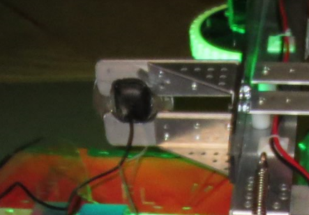

Ours is zip-tied to a piece of Lexan with a rectangular hole that matches the area around the lens. The ties go in an X shape behind the camera body, through four holes in the Lexan, and vertically in front of it on either side of the lens.
The Lexan is actually a pneumatically actuated bracket that can pivot up and down, but it could just as easily have been bolted or riveted in a fixed position.
