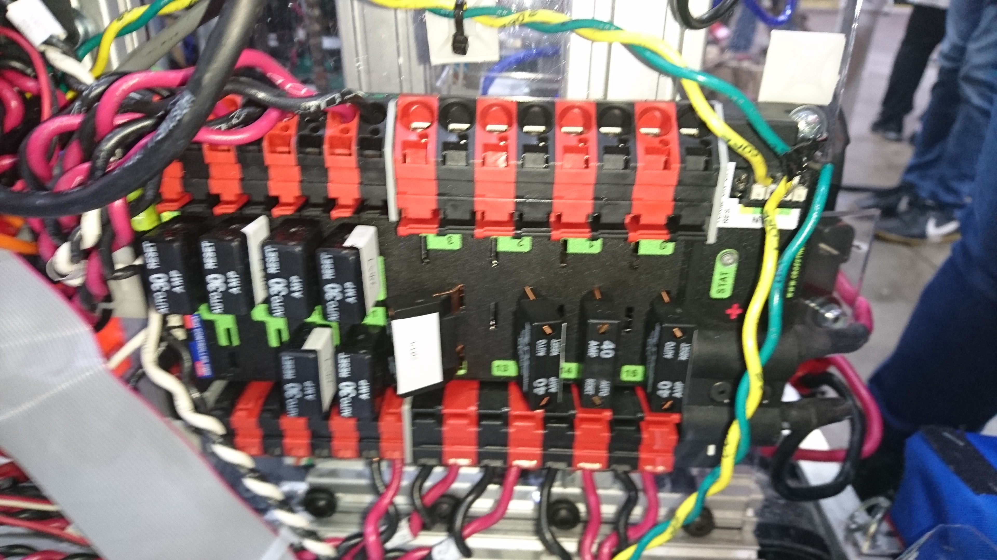

Looks like when we were chasing 111, our bumpers went into the cutout on the cargo ship and we must’ve hit in just the right spot where it pushed our cover in and snapped the breakers. The 2 breakers (that we checked before re-bagging) are actually bending in opposite directions. The leftmost one is almost 90 degrees
