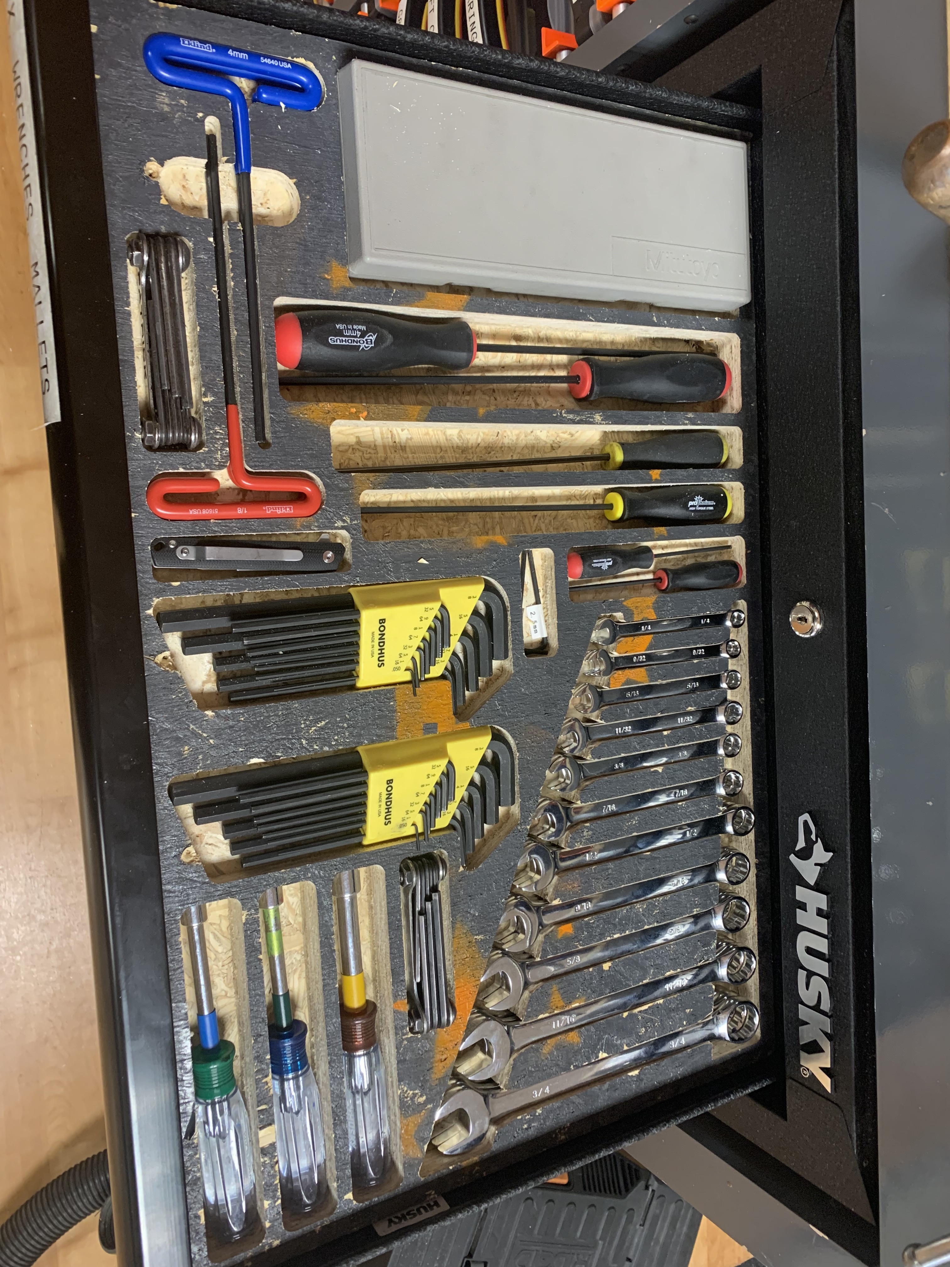

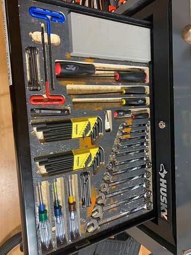

If it were me trying to spend some money on a pit set up right now I’d focus on usability first - do the tools you use have a place? Do you have adequate lighting and power distribution? Do you have a pit set up for off seasons that’s easier to transport so you can train students in using it in the off season?
Lighting, hand tools, labeling are all things that are chronically overlooked for “sexier” things like machines. But the reality is good labeling and lighting probably contributes more to consistent success.

The best thing you can do for a pit (other than building a superpit for easy load in):
