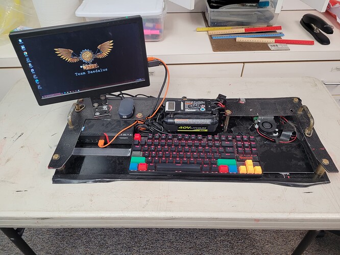

Our driver station is a mini pc with a ryobi 40v battery that powers it. I dont think i have a picture. And I dont know any details about it but if you any questions about it I can get some answers tomorrow from people that actually know computers on my team.

I got a picture of our driver station. I thnk we got the mini pc from our school because they stopped using them and we put it on our drivestation to have a dedicated computer for the drive station.
Mini ThinkPad?

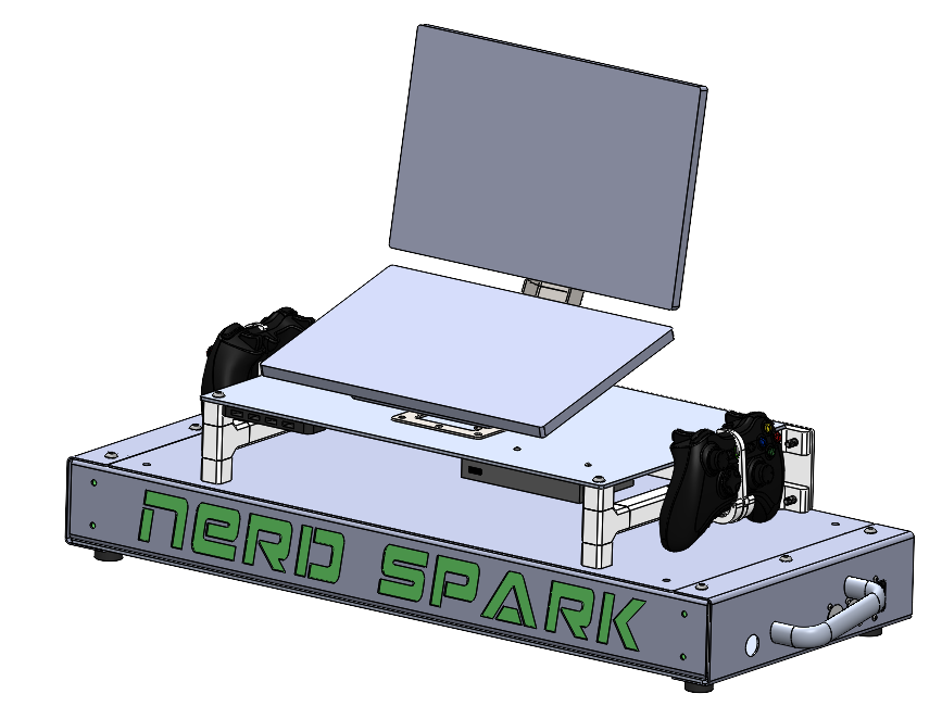

We developed this driver station for use last season:

Goal was not to go cheap but to have two touch screen monitors to experiment with touchscreen controls.
We never got to that point during season.
Everything was powered by:
https://www.amazon.com/12-Volt-Rechargeable-Lithium-Battery/dp/B00JK06CK8/ref=sr_1_12_sspa?crid=26KZQB5UCD36U&keywords=lifepo4+battery+10ah&qid=1696544716&sprefix=lifepo4+battery+10ah%2Caps%2C83&sr=8-12-spons&ufe=app_do%3Aamzn1.fos.f5122f16-c3e8-4386-bf32-63e904010ad0&sp_csd=d2lkZ2V0TmFtZT1zcF9tdGY&psc=1
which could operate everything theoretically for about 4 hrs straight.
Biggest issues we found was the lack of battery management. We never quite knew how much charge was left and thus we were hyper vigilant about keeping it plugged in while in the pits.
Dual touchscreens on the Mele was not recognized on startup so we needed to go through a calibration process every time we restarted.
Improvements we are planning include
  1. Adding a battery meter
  2. Adding a power cutoff switch so that monitors and powered USB hub would not parasitically drain batteries when driver station was in storage
It’s not light but it’s not terribly heavy. One person can carry it from robot cart to driver position pretty easily.
If you are interested in CAD, I can post it online.
