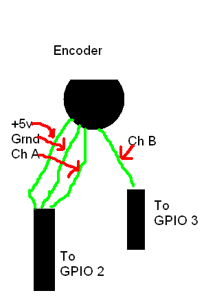

PWM” here is referring to the cable we’ve spliced to, not the output on the digital sidecar
I sketched out a diagram of eaxctly how it’s set up and attached it.
We know the robot isn’t reading the encoder because the value from Get() never changes, and the robot always reports that it is stopped, even when moving
That is a sweet MS Paint sketch :slight_smile:
Everything looks correct to me. So the problem is either really obscure, or right under our noses.

You’ve shown three wires going to one thing, and one wire going to another. The sketch doesn’t show which pins on those “things” the wires go to. If your labeling of the wires on the left matches the order they’re connected to the GPIO pins, I think you have +5 and ground reversed.
I don’t have the robot to look at, so I accidentally reversed them on the diagram. We know that the orientation is correct on the robot because the encoder LEDs are lighting, which wouldn’t happen if they were getting reversed current, and we can get some variation as we turn the wheel, so it’s not something weird like getting the ground and signal wires mixed up.

An actual photograph of your wiring would help a lot at this point. So would a good closeup of how you have the encoder disk attached. Your code looks fine to me (except for a nagging worry about using the %d format specifier with a long integer).
