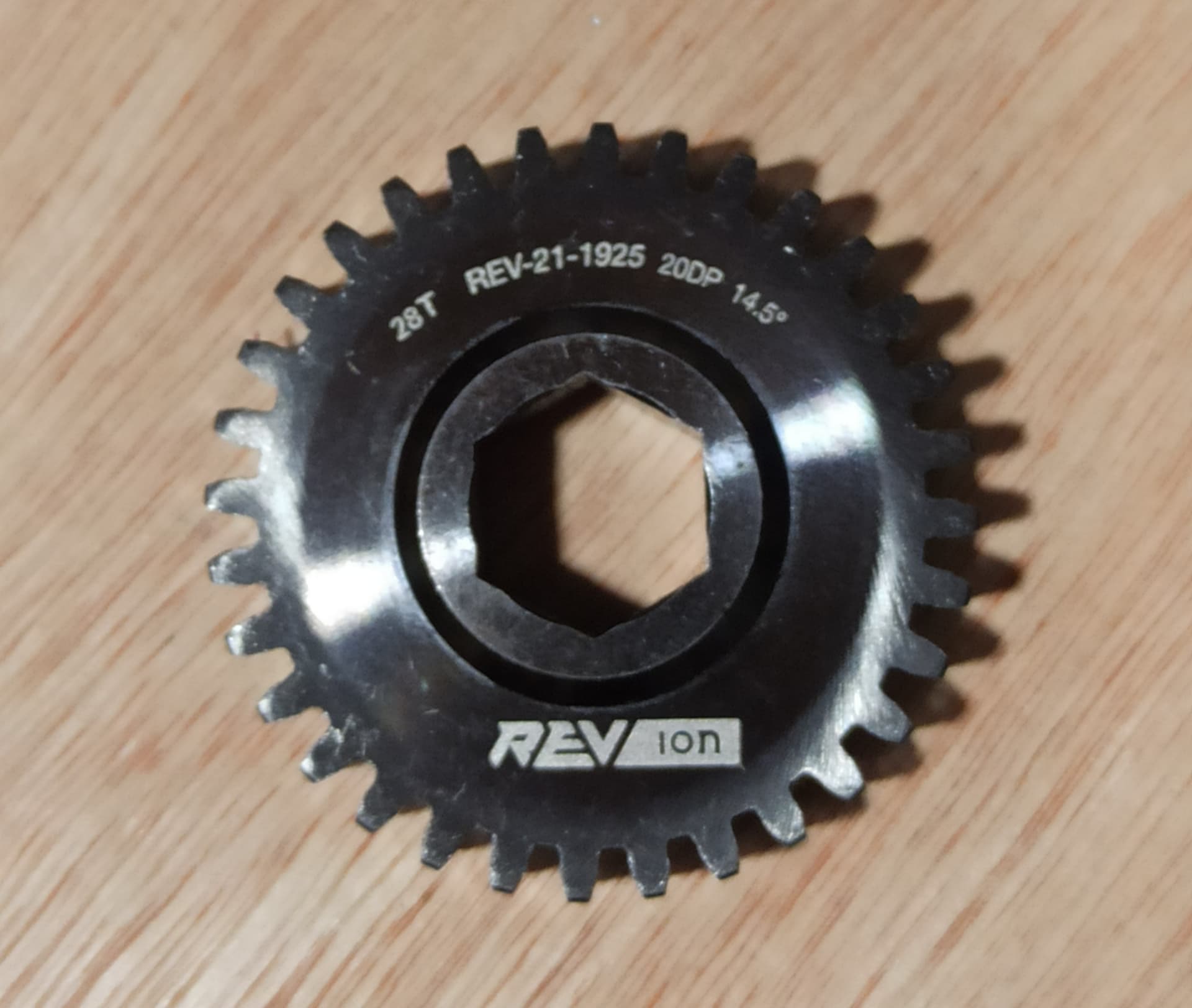

Hey CD :wave: I was wondering if anyone else got gears from the same batch as us : our supposed 28T gear, after counting, was revealed to actually have 32T !
This set us back quite a bit in our build process because of long shipping times to France so any tips on what to do with REV would also be appreciated.

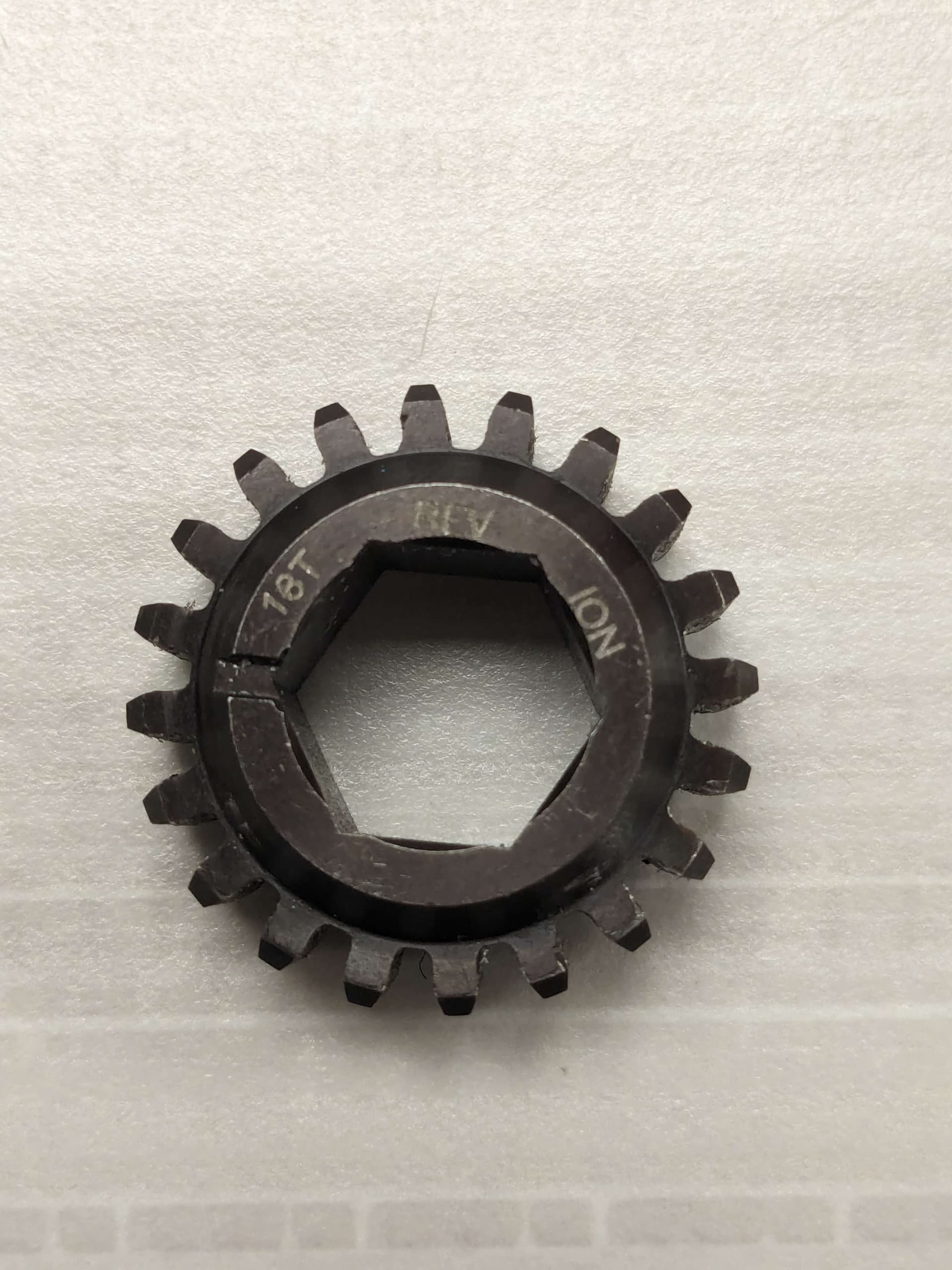

So now confirmed on different skus…

If you have not already @Federico_9220 please reach out to support and we will replace the gear.
This specific issue which has been seen a handful of times is a frustrating one, and one that is being addressed.
As others in this thread noted, it is not practical or economical to have a human check every laser marking so we need to think smarter about this. For this specific issue in the past, we were relying on our vendors to sort and then laser mark the gears and then we check an assortment according to ISO 2859-1:1999 (aka AQL standards) which is not good at catching these 1-2 issues that might exist in a batch of 2000+ gears.
We believe that this is an issue that come to be during the transition between lasering different sizes of gears, when 1-2 of an old size don’t get marked they mix their way into the new size batch.
Moving forward we will be providing laser jigs for all our vendors with teeth cut outs, so only the proper size gear will fit on the laser to avoid any mis-markings. This is an example of the way that we can think smarter about things without increasing the labor required to do 100% checks.
REV has grown quite a bit in the last several years and we are actively expanding our staff in critical places, quality and testing, so we can continue to improve. I know we will continue to improve but in the meanwhile you can be assured that we will always stand behind our products and make it right with replacements or other remedies when necessary.
