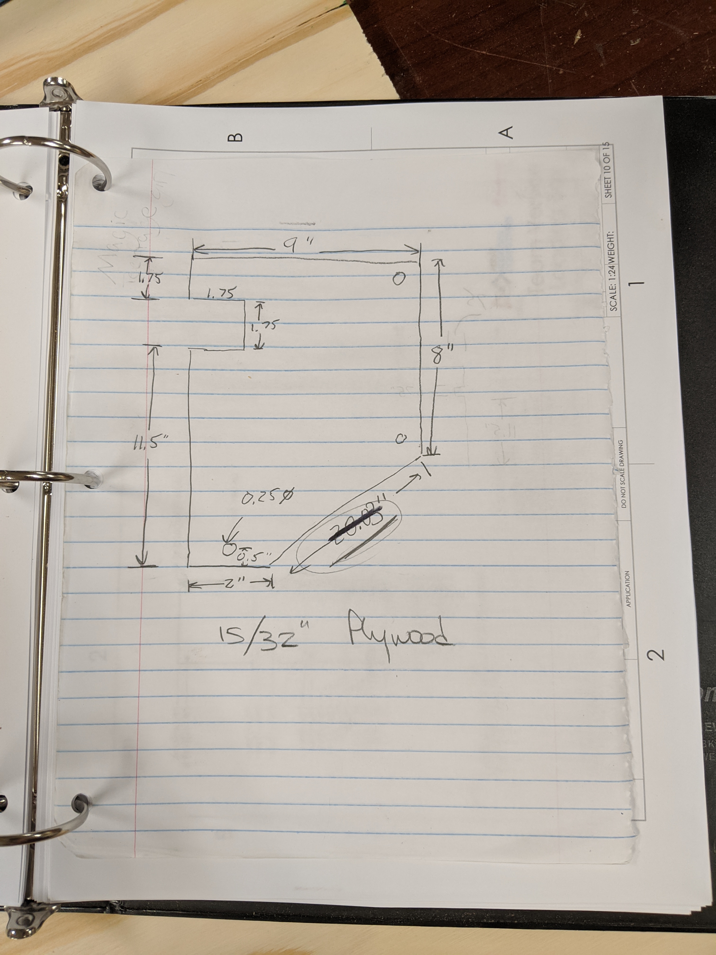

Hi all! One of our mentors has been working on building our half size field and have come across a problem. He can’t find the schematics for part TE-20000-10. It’s labeled as a .125" HB divider for the Loading Bay. Anyone else run into this problem? And is there anyway to address this? Thanks!
Yep - not in the packet, I found that last night, too.
I’d build everything else, and wait for an update. It’s a part that won’t directly affect your robot design, so it can probably wait.
We drew these up with the CAD model, installed them, and they work great.

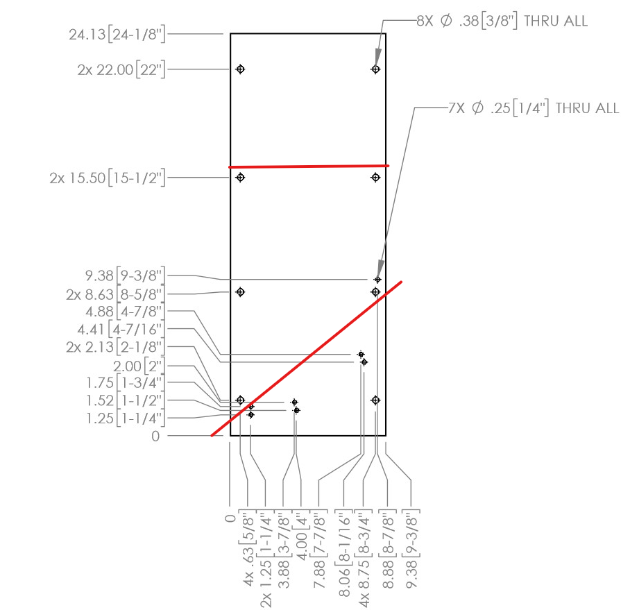

It looks like the drawing for TE-20000-10 is missing from the Half Field and Minimal Field drawings only file. Or am I just incredibly blind?
@nmatthes @juliasdad
Correct, looks like it got missed to me.
Fake it with TE-2000000000-07 and these cuts:

TE-20000-10 was added in 2020 Team Update 01: https://firstfrc.blob.core.windows.net/frc2020/Manual/TeamUpdates/TeamUpdate01.pdf?fbclid=IwAR3IpJSCYzNrCLswMoeRV3iga6doXPWYVcmjanOP-8ERu2l3QA4kMBjB4B4.
Additional pieces were corrected as well.
