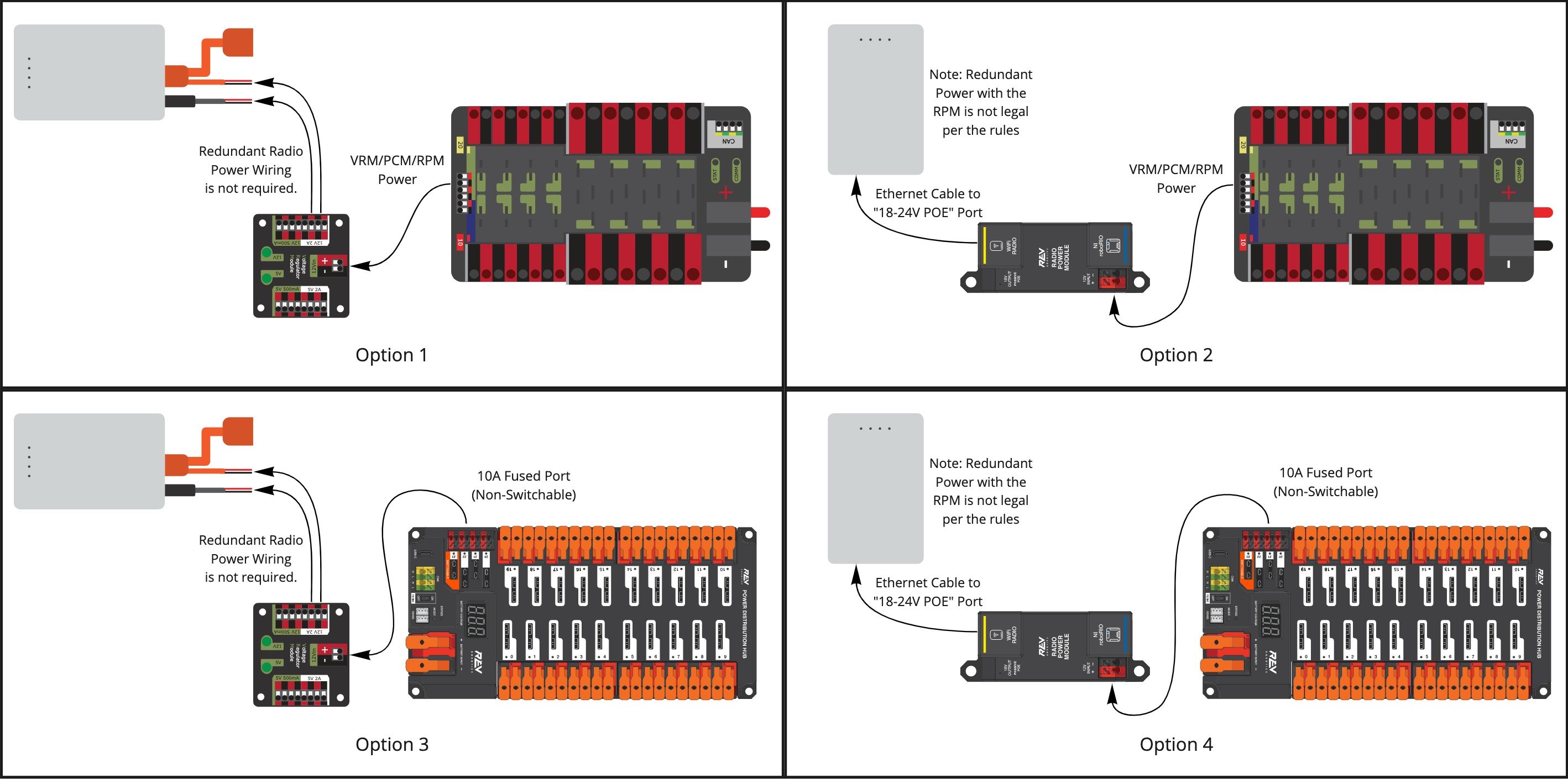

Here is a graphic that shows the (exactly 4) legal ways to power the robot radio in 2022:

Note that this prohibits using any other active POE injector device to power the radio but does not prohibit using any PASSIVE CONDUCTORS to inject the VRM power into an Ethernet cable plugged into the radio port labeled “18-24v POE.”
The “either/or” here could be is exclusive, which prohibits mixing the VRM and RPM.
Is exclusive.
The diagram linked above was created by me and used in both the CSA and RI training from what I was told. Those were the only four legal methods to power the radio.
