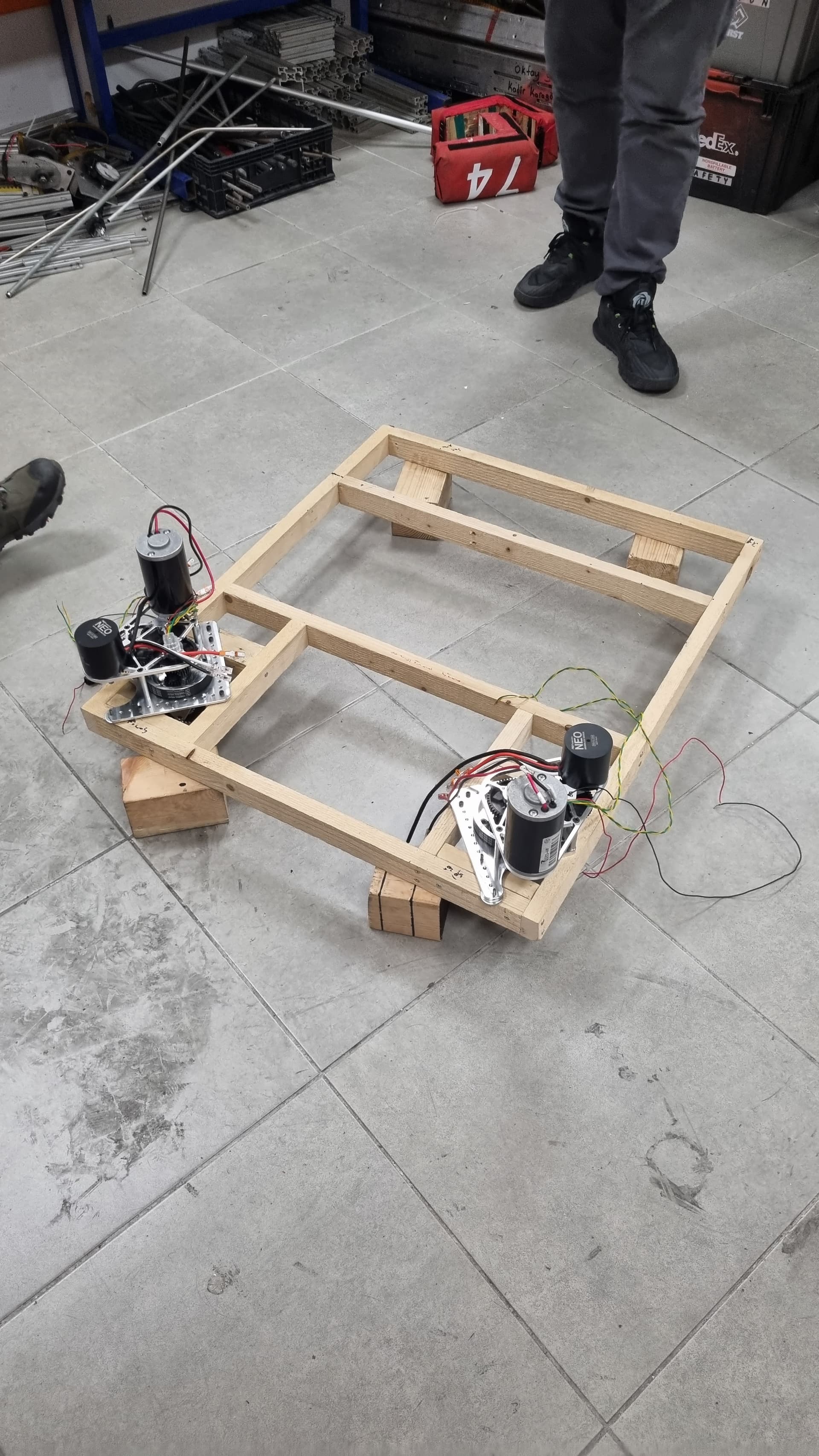

we tried something (SDS MK4I Module)
That looks like an MK4, not an MK4i.
If the motors are sticking up, it’s not an inverted motor setup. If that’s actually an MK4i, I’m not sure I want to know what modifications you guys did that could have been better done by just getting an MK4.
We found such a solution because we do not have a motor. We use is the sds mk4i module.
So why aren’t your NEOs upside down?
I’m genuinely curious here. The MK4i is designed to have the motors inverted, for better protection. With a CIM, I can understand running non-inverted (though I do maintain that an MK4 would have been a better choice–cheaper, though not by much, too). But the NEO should be able to be installed correctly (inverted).

At the beginning of the season, we built the robot’s systems on a tank chassis. then (2 weeks before the competition) we decided to use swerve, but we could not put the system on the swerve chassis. we were crossing the chassis size limit. we cross mounted swerve modules. but when I did this, the Neo coincided with the profile. so we flipped.
Prototype Chassis;
Where there is a will, there is a way :upside_down_face:

Since the motor shafts are cantilevered in the assembly as designed, it seems like just flipping the motors over while using a pinion spacer of the correct length and 8mm push-on rings for retaining the pinion is all that would be needed. No real functional difference. The motors could be attached directly to the upper plate rather than using the long screws and spacers as-designed which is kind of a functional advantage. You, of course, lose the motor protection and add some obstacles to design around above the chassis, but if that’s not a showstopper, it looks like this would be an easy change.
If those motors got hit, there is a good chance of bending the upper plate, so this would not be a mod that just anyone should try, but in a pinch, there is some value.
