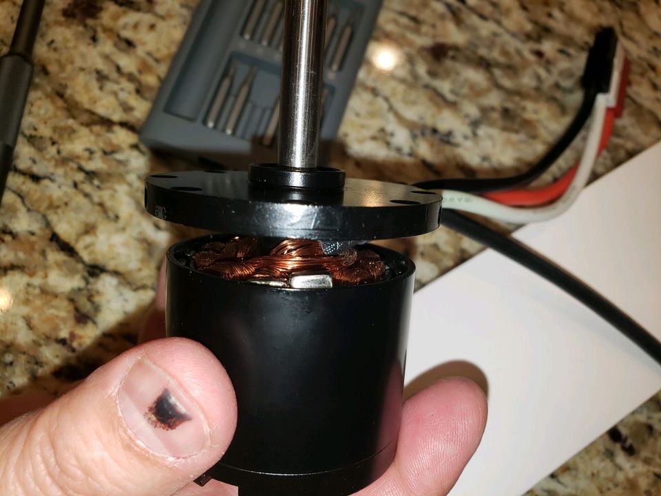

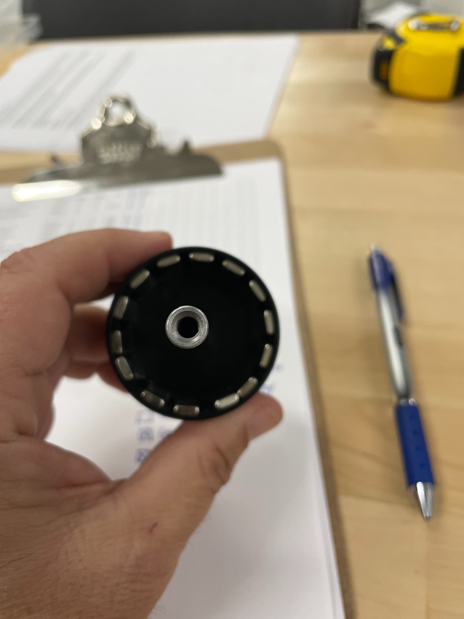

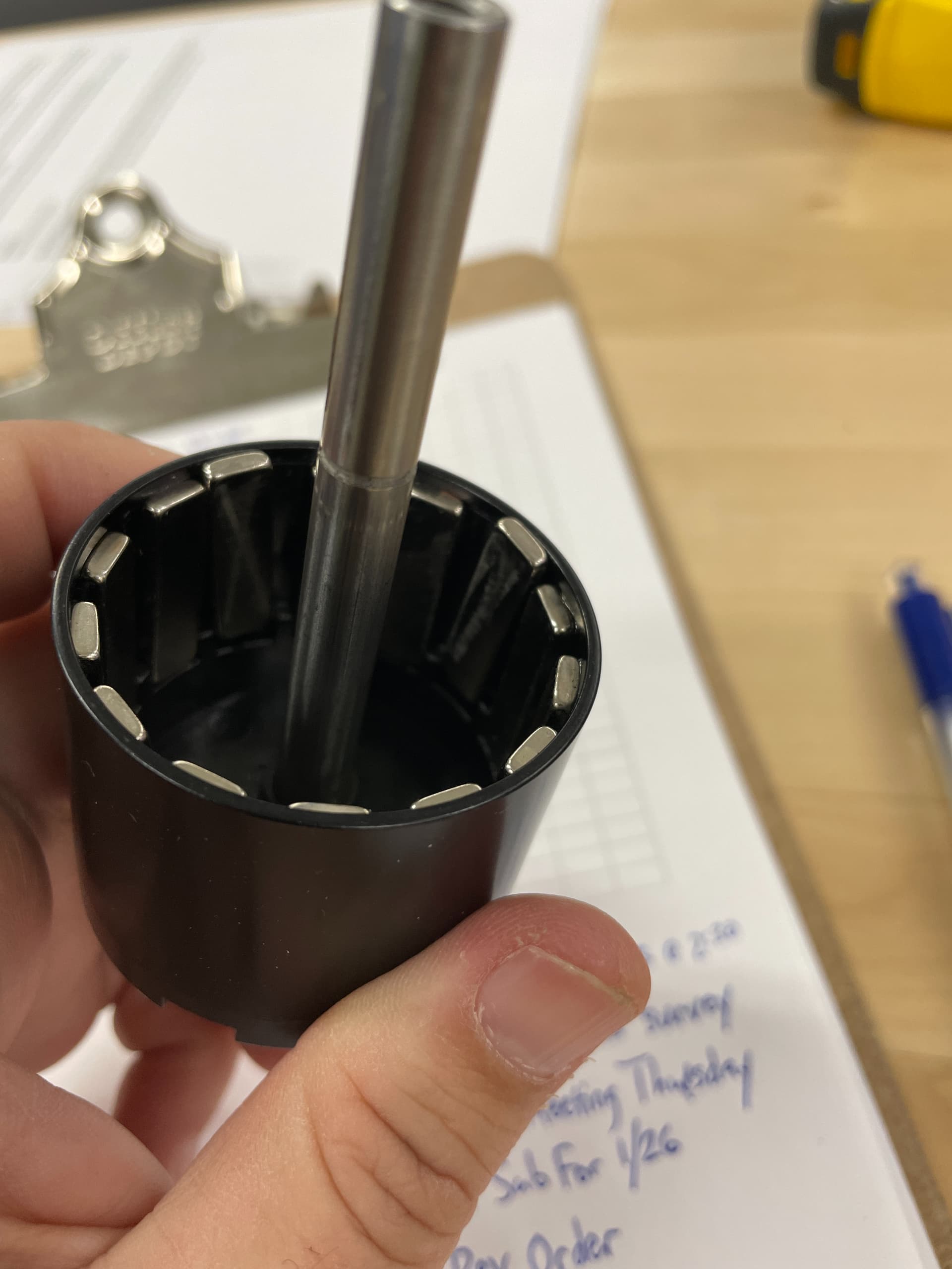

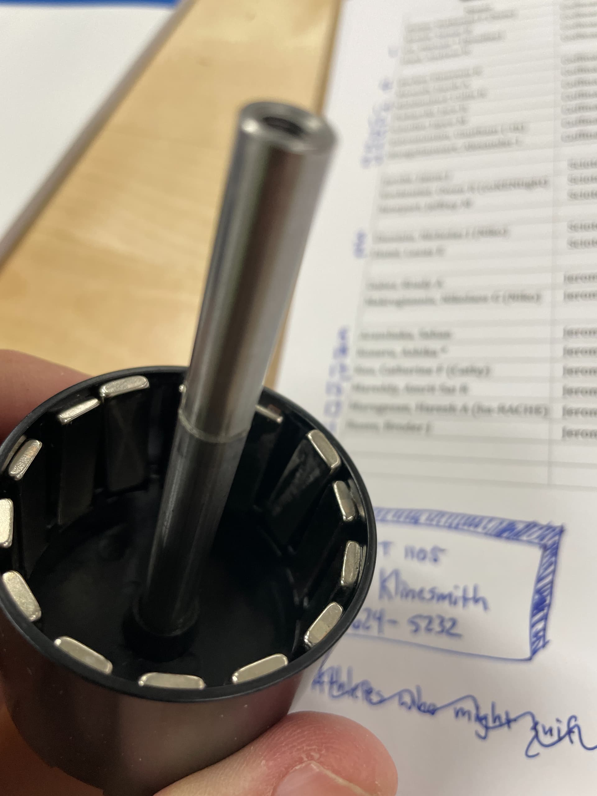

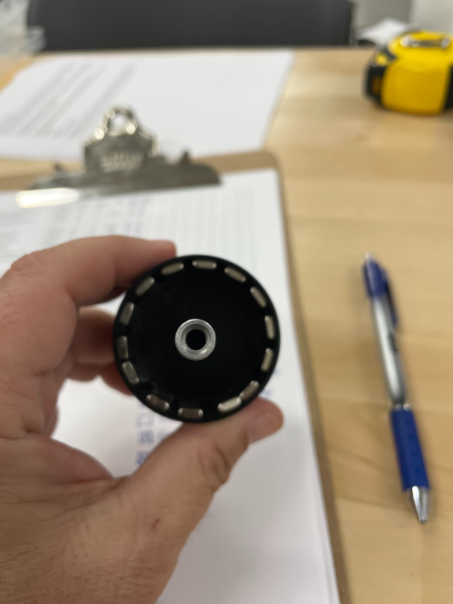

We had a similar issue. Two weeks after starting to use mk4i’s and a set of new neo’s, 3 of our 4 swerve drive motors suddenly seized. We have looked through this and a couple other threads and were wondering about causes for three motors to seize at the same time.
To piggyback on Max’s post, here are some pics of one of the motors, when disassembled…
Sorry for the late update. I did end up figuring it out. Upon disassembly, the magnets were dislodged and not glued in. We checked to see if any other of the magnets were not glued in and we proceeded to glue them back in with Loctite 480 (for metal-metal bonds, magnets, etc.) and we haven’t had any problems since (knock on wood). I will keep you posted if there are any further issues. Thank you all for your help and good luck during this 2024 season!
