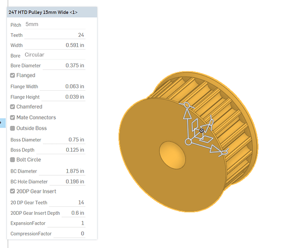

I’m having trouble with a portion of the configurable HTD pulley.
I’m unable to generate a 20DP gear insert cutout. I played with a bunch of variable permutations to test if there’s some dimensional oddity preventing it from generating, but had no luck. Is this user error, or is there something wrong?

This has been resolved. Looks like someone rolled back before the gear and Boolean feature and someone else created a new version and updated the document.
