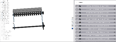

Apologies if this is covered elsewhere, but I am trying to use the MKCad Inserter in an assembly and it does not insert the parts. The tab on the right is there and the parts in the tab show up, but when I drag or click or press Insert, the element blinks but nothing gets inserted.
Firefox 121.0.1, Enhanced Tracking Off for Onshape
Restarted Firefox, uninstalled/reinstalled MKCad, no improvement.
The inserter inserts parts into the assembly at the origin. could there be another part in your assembly that is hiding those parts?
If the part shows up in the list of instances on the left side in your assembly view, it is in the assembly. Click on it and the drag handle will show up on that part. You can then use the drag handle to move the part somewhere where it’s not hidden anymore.
The part is not showing up in the list of instances.
Screen Recording 2024-01-24 at 11.35.53
You can’t drag and drop from the app. You click it, it loads, and it shows up at the origin.
After talking with 177, it seems that the issue is related to their document somehow. The MKCAD app works for other documents, but not their robot document. We’re looking into it.
OK, thanks. I can still just insert from the public MKCad docs for now.

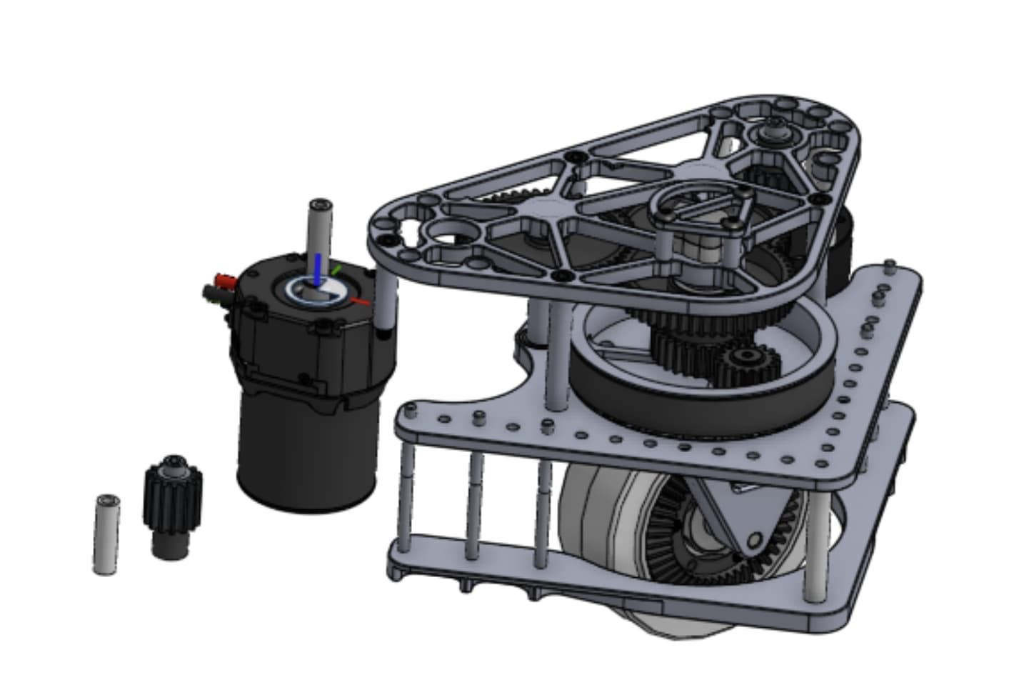

I noticed an issue on the MK4i for the 10-32 above frame configuration. It has the bottom plate rotated wrong and fastened 7 and 13 are over-defined.
Edit: also just noticed the rio 2 had faulty topography.
Not sure I can do the actual, but I asked @Kevin_Thorp if I could port his simplified versions into MKCAD as they have been really useful to my team.
This should be fixed :+1:

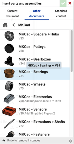

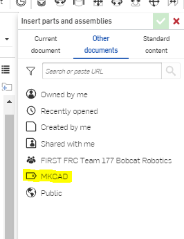

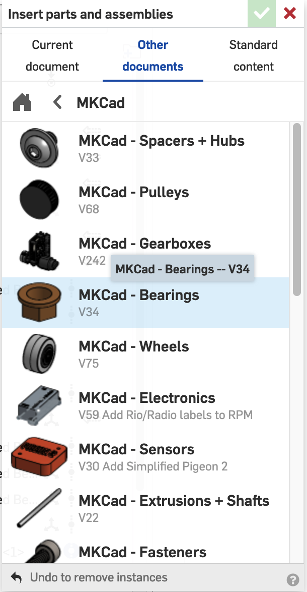

Unfortunately there are a lot of copies and non-official MKCad documents.
Fortunately, I have a label in my documents that has sorted out the “real” MKCad.
Unfortunately, I have no recollection of how I put it there. :innocent:
Can anyone tell me how to do that, so our newer team members can add it?
Click this link

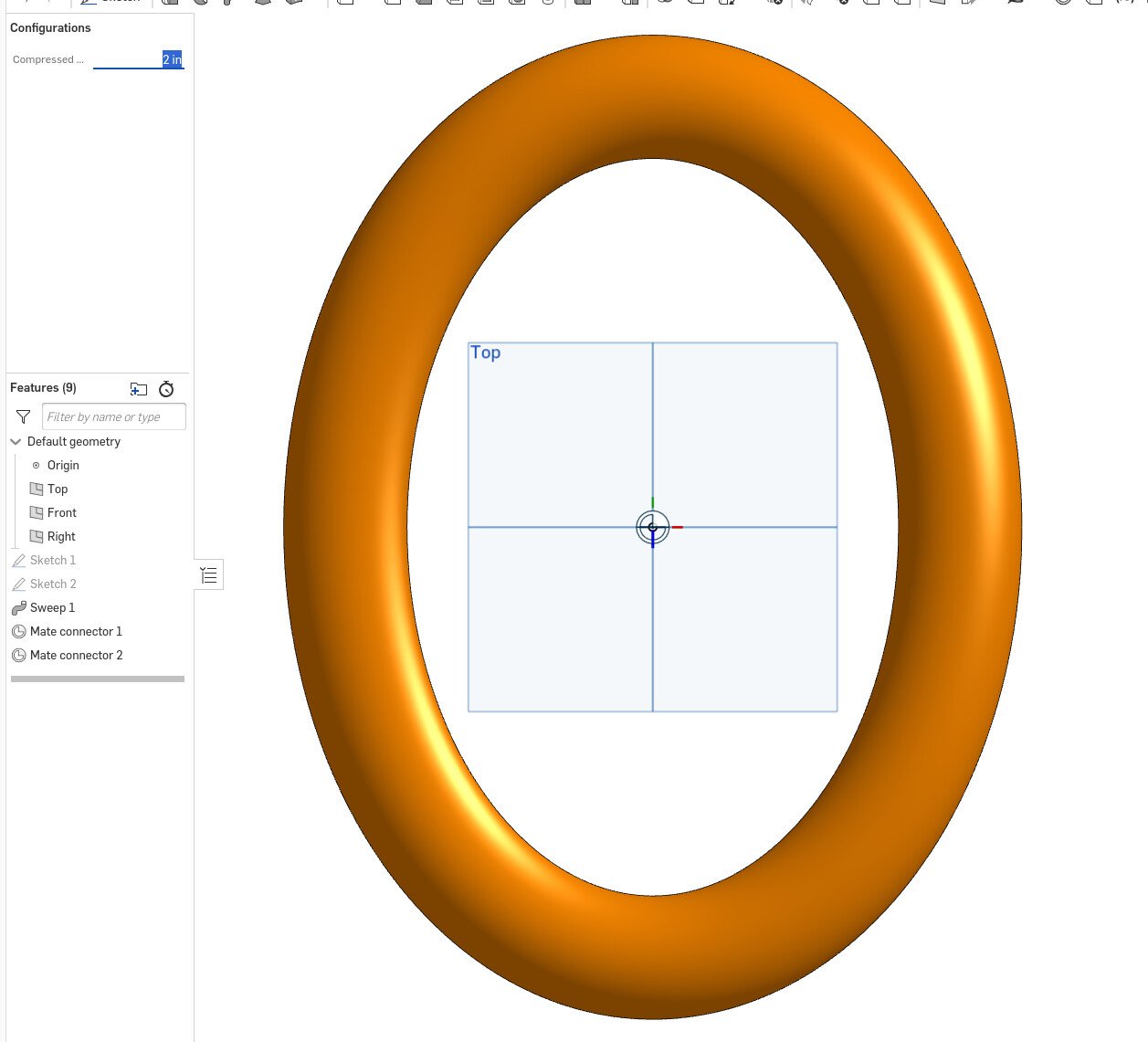

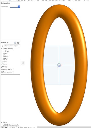

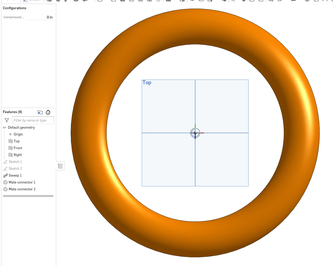

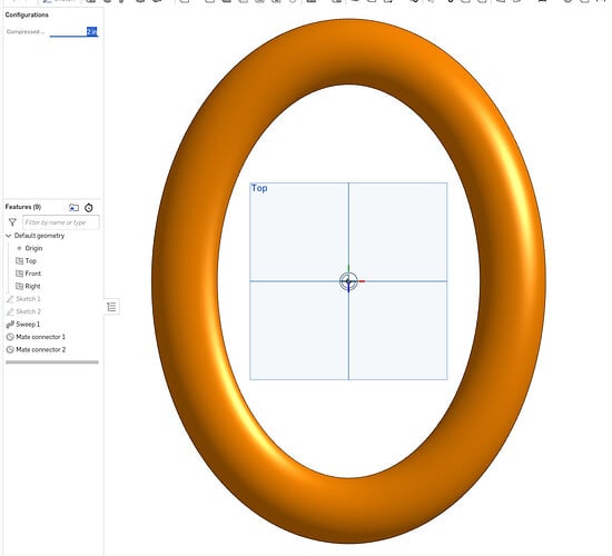

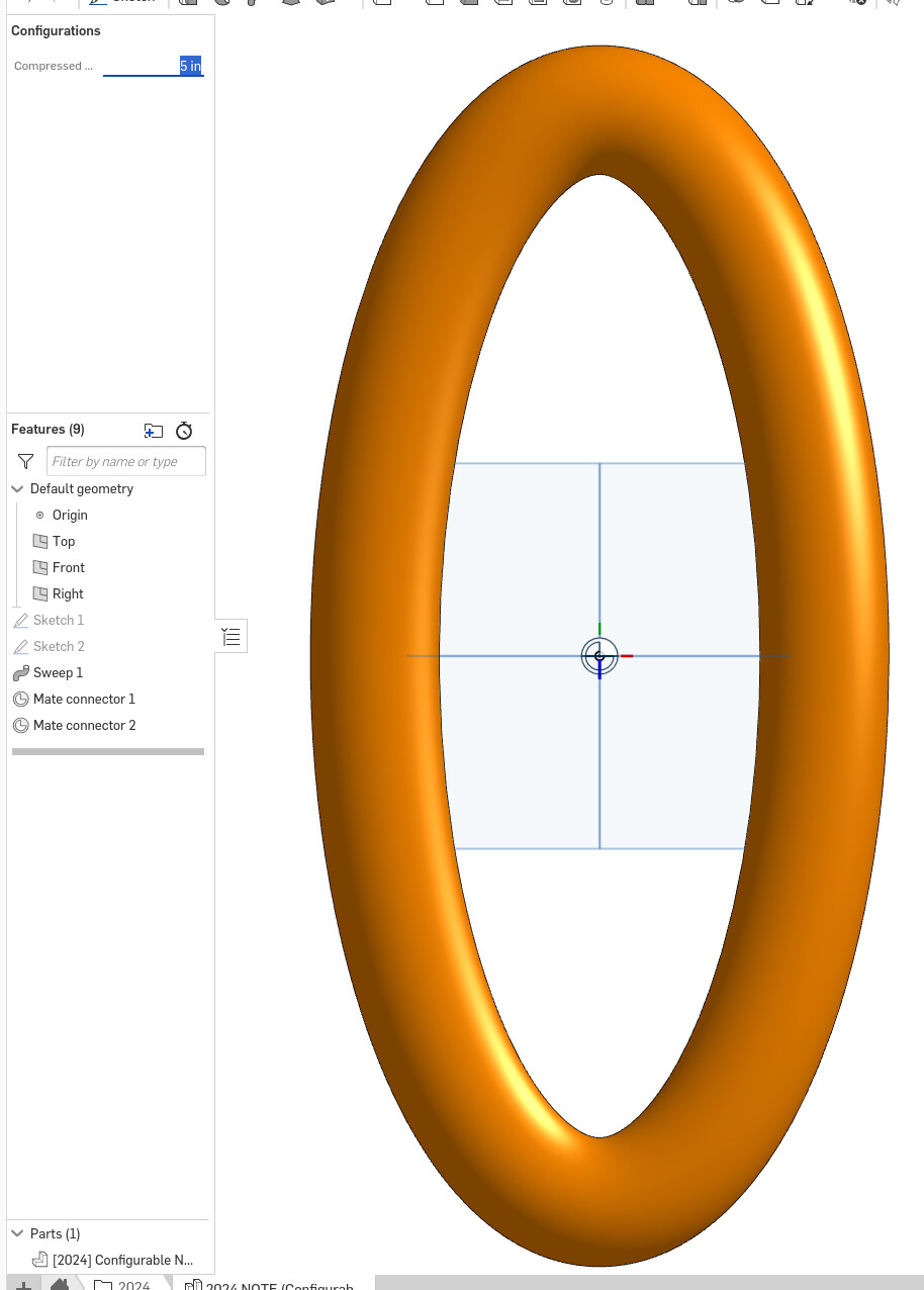

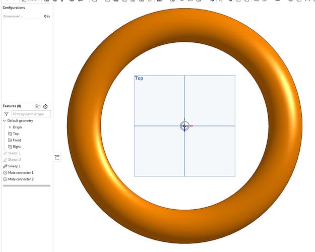

I’ve added a configurable NOTE to the Game Elements section of MKCAD. You can configure the amount of side compression and it will approximate the shape of the compressed NOTE as an ellipse. It also has mate connectors for easier mating.
5 inches of compression
2 inches of compression
0 inches of compression (round)
