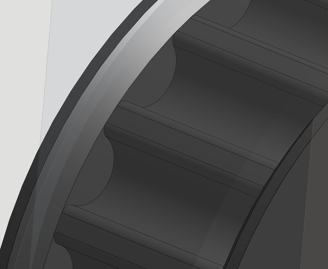

As noted in the thread, Ty later updated the MKCAD pulleys to use the correct geometry, which is as pictured above. It’s fairly easy to tell the difference between the old geometry and the new-- the new is as posted in this thread, the old looks more like this:

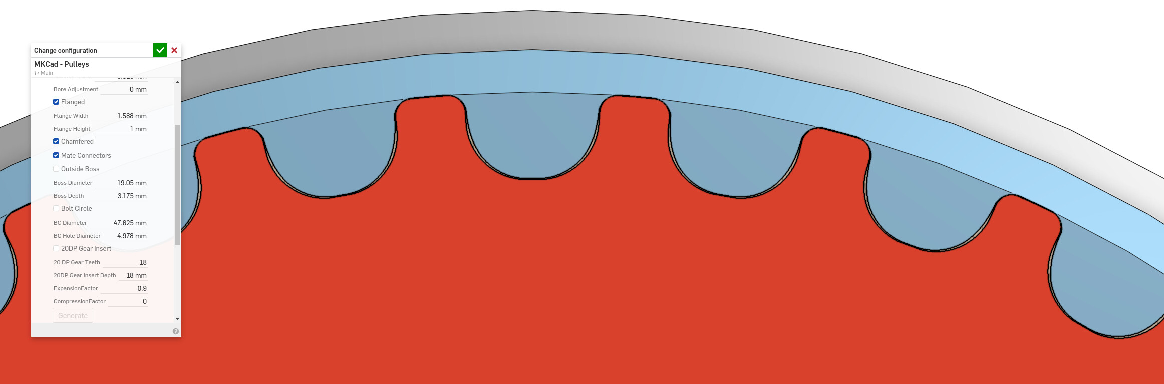

This is a 42T 5mm MKCAD pulley with no offset, and a Vex 42T Pulley.
For comparison, here is the same two pulleys but with a -.005 offset for MKCAD. You can see that the bottom of the roots are now roughly tangent, but the MKCAD tooth is -.0025 shorter. This seems fine and is what 2135 ran for 2021 offseason and 2022 season, but taken to the extreme (numbers larger than -.01 maybe) I’d expect belts to slip under lower load and wear faster.

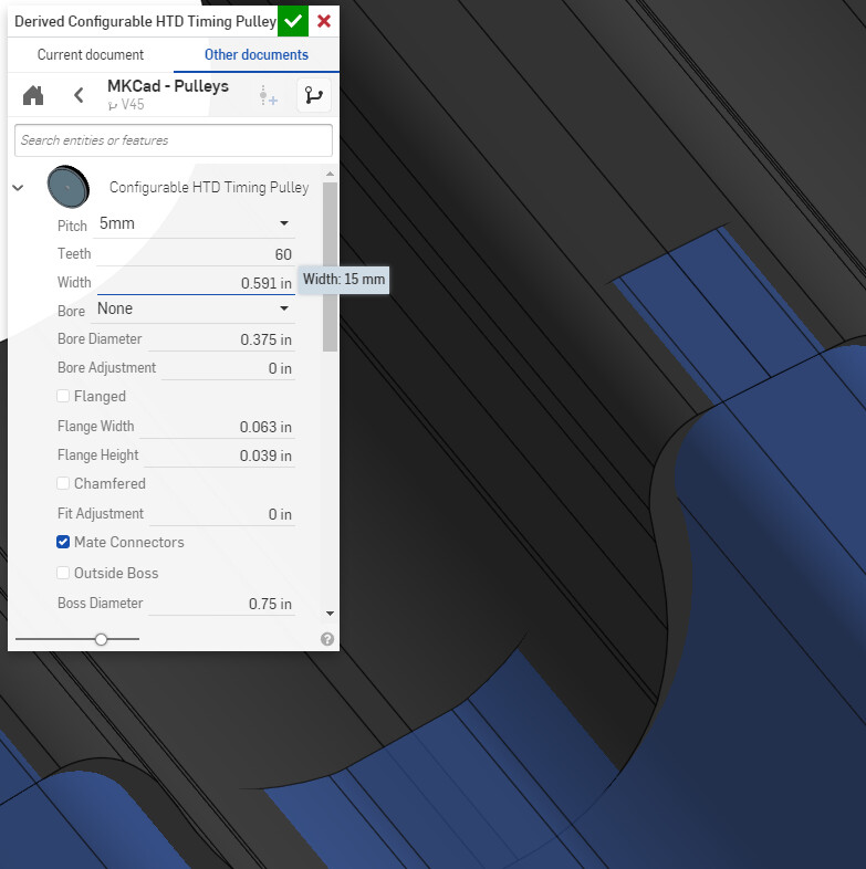

How do you do this adjustment? Just select the outside edge, hit -.005" offset, and extrude the excess off?
I’d probably do a Move Face
I’m not sure how that would work. Is there an easy way to select all the faces on the pulley side?
It’s built into the configuration for MKCAD pulleys.

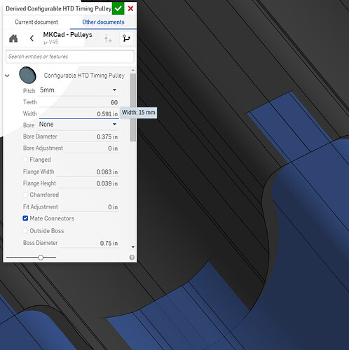

I do not see any

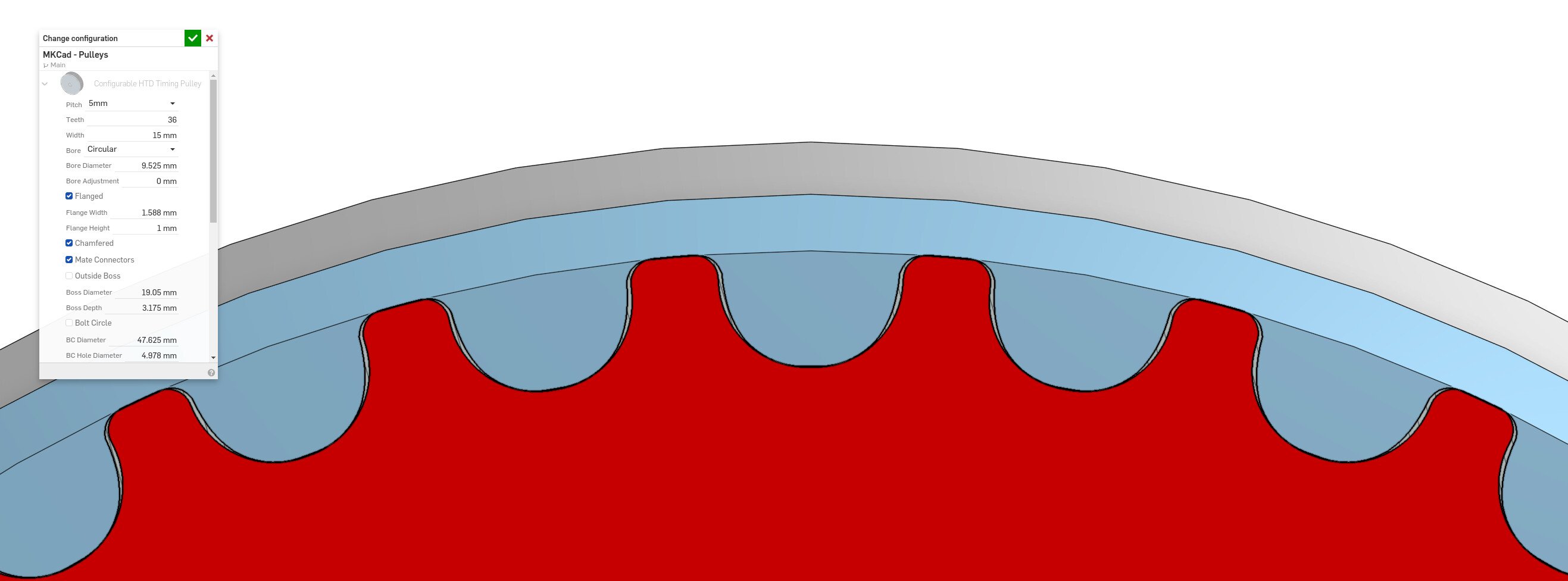

Here is the Vex Pro 60t slice (black) up against the MKCAD 60t generated HTD
I don’t see any option in the configuration, and “Fit Adjustment” doesn’t do anything
Interesting, it is the fit adjustment and does work for me though. Maybe @Ty_Tremblay can educate both of us.

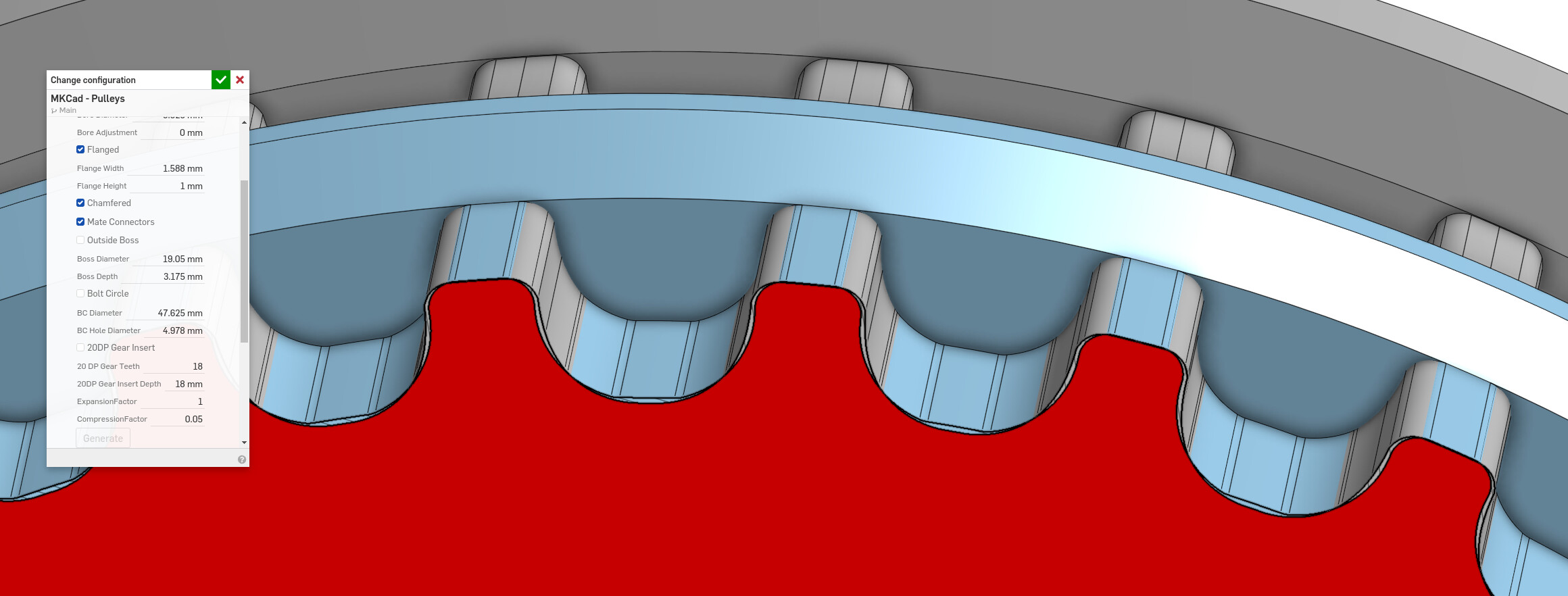

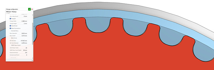

Thanks for catching this. In my port to the better profile from the previous thread, I never updated the fit adjustment parameter. I’ve updated the document to expose two variables from the equations that derive the profile.
  • ExpansionFactor seems to adjust how wide the valleys in the pulley are
  • CompressionFactor seems to adjust how deep the valleys in the pulley are. At the moment, they can only be made shallower.

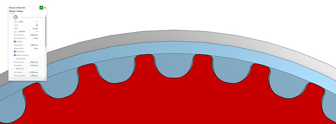

Here’s a few screenshots comparing a vexpro 36T 5mm HTD pulley and the MKCAD configurable pulley, with these new adjustments. Red is the intersection between the pulleys:
Any interest in adjusting these terms when presented to the MKCad user? they are fairly unintuitive. Might I suggest:
GroveWidthFactor*
GroveDepthReduction**
*Factor for the width because it appears to be a multiplier
**Reduction for the depth because it appears to be an offset in mm
Edit: because I cant read :confused:
