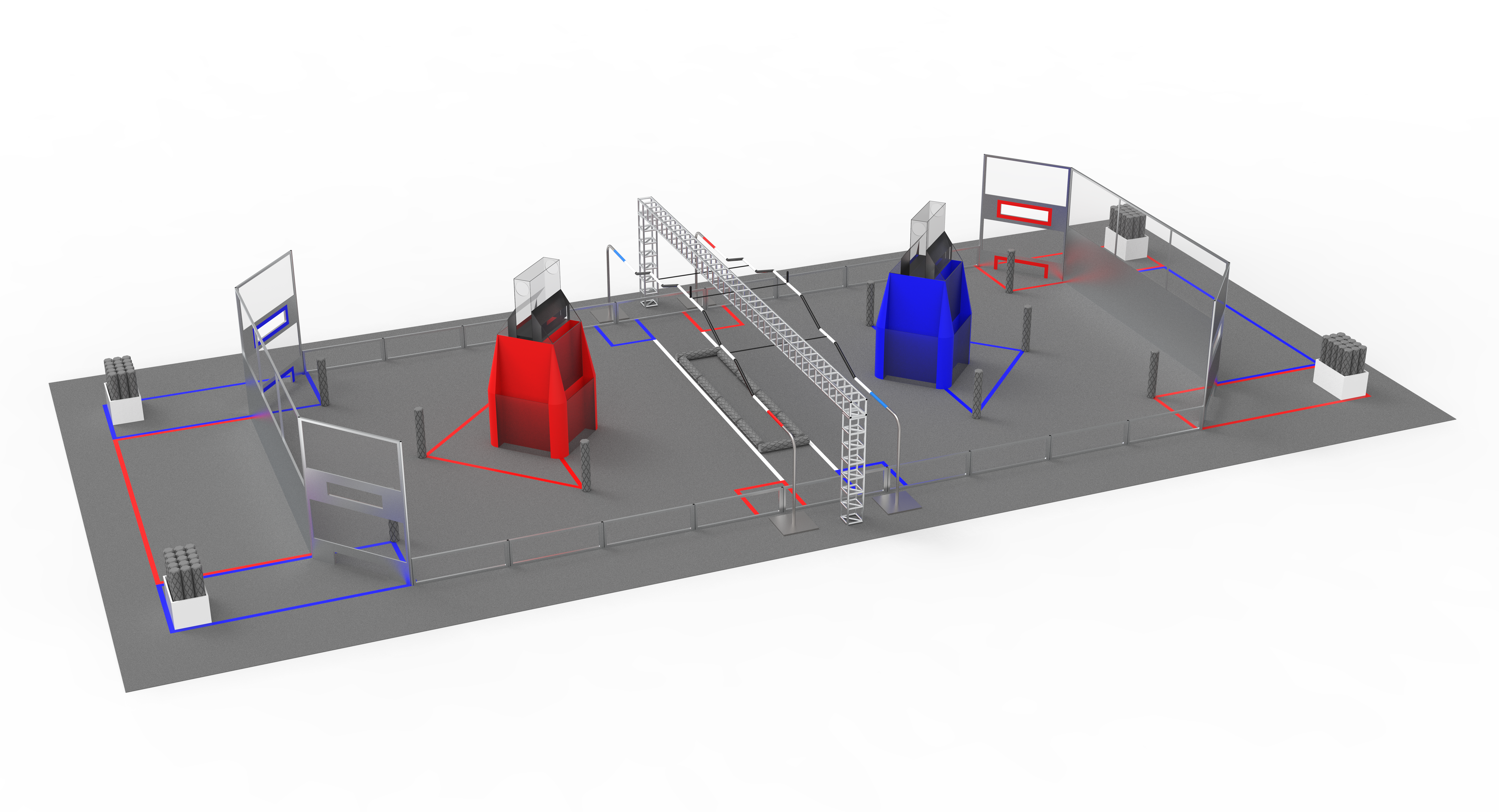

Mock FRC Game: Path to the Peak
Higher Res Field image here
Another year, another FRC game @Leap and I made for the fun of it. Check out the game manual and field CAD here: 2022 CD CAD Challenge Manual: Path to the Peak - Google Docs
Let us know what you think!

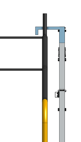

My initial thoughts:
  • Near-Ground → Summit Climb seems very doable if you first lift from off the ground onto the containment unit. The geometry might be weird but it’s definitely doable by angling the robot given the lack of a height limit similar to how many mid->traverse climbs worked this year. (The “blue box” on G22 seems to indicate this isn’t intended, a possible edit could be: “While contacting a climbing BAR, a ROBOT must be fully supported by that BAR unless it is contacting a MOUNTING BAR.”)
  • Despite G22, climbing from the ground to the summit still grants the point for climbing, contributing to the alliance’s cumulative climb points for the purposes of the ranking point and still resulting in a point delta of +8 (16 for summit, -8 for tech foul) making it equivalent points-wise to a ridge climb.

Thanks for catching these! I think there are two big rules we forgot to convert over from normal FRC - namely, the limits on grasping/grabbing/entangling with field elements (addressing point one), and G107 (using height as a perimeter extension, to address the last point). We’ll add these in the next day or so along with upping the “directly to SUMMIT” foul.
Curious to see if you have a geometry sketch on that first bullet though! Would love to see how that climb can be done.

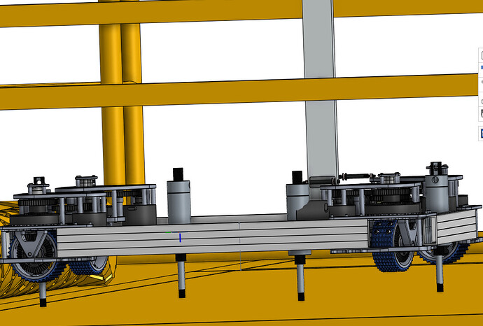

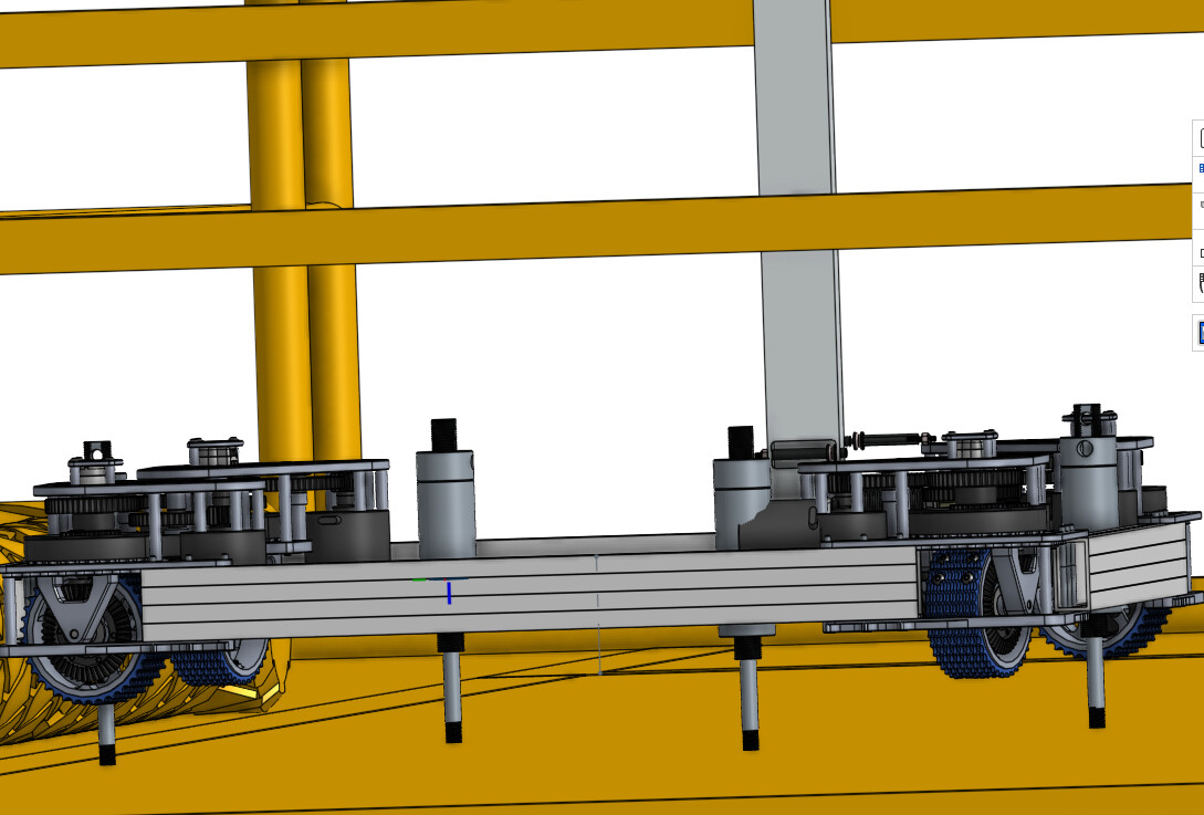

I think I found a very easy way to climb to the peak that’s within the rules. it goes like this:
step 1: Extend elevator or similar such that your hooks or attatchment device clears the peak bar, and drive until the hooks are over the bar.
Step 2: Raise robot on short stilts that stay within the bumper zone,(there are many ways to do this). adjust overall extension height to such that the hooks are just above the bar but not touching.
Step 3:
Retract stilts with significantly greater than 1g acceleration and fall onto the peak bar.
With this method, you are never touching both the bar and the ground at the same time.
