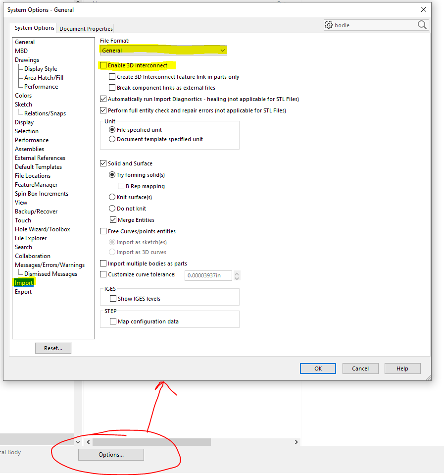

There may be one additional thing you may need to do when importing the part – independent of what has been posted so far.
There’s a SW feature called “3D Interconnect” (SOLIDWORKS 3D Interconnect - 2020 - SOLIDWORKS Help) – the short of it is, if it’s enabled, you can bring in parts not created in SW, but they won’t be editable. You can identify when enabled on parts/assemblies by the green arrows on the icons in the feature tree. See the figure labeled “3D Interconnect Reference Tree”: 3D Interconnect makes SOLIDWORKS 2017 a true Multi-CAD environment
To turn that off globally (as opposed to breaking the links within one file), it’ll be within the Open dialog; click on the file you want to open, but before you click the Open button, click “Options…”:
Choose “Import” in the left pane
Choose “General” in the top drop-down
Uncheck “Enable 3D Interconnect”.
Click OK in the System Options dialog
Finally, click OK in the Open dialog
