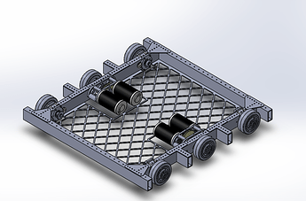

Our team made a west coast drive for our off-season project and we were successful with it so here is the CAD for that. I did release a west coast drive cad earlier but after reading some replies I made some modifications to our original design. The bearing blocks are custom and would be waterjet on a sponsors waterjet. One change for this season is we would create smaller bearing blocks similar to how 971 did theirs as these bearing blocks were made for 16T sprockets and a way to mount an encoder. Since we would be using falcons, there wouldn’t be a need for encoder mounting. The bumper support brackets are 1/16" rather than 1/8" as modeled.
Final SS V2 GB.STEP (8.8 MB)
Frame Assembly.STEP (15.1 MB)

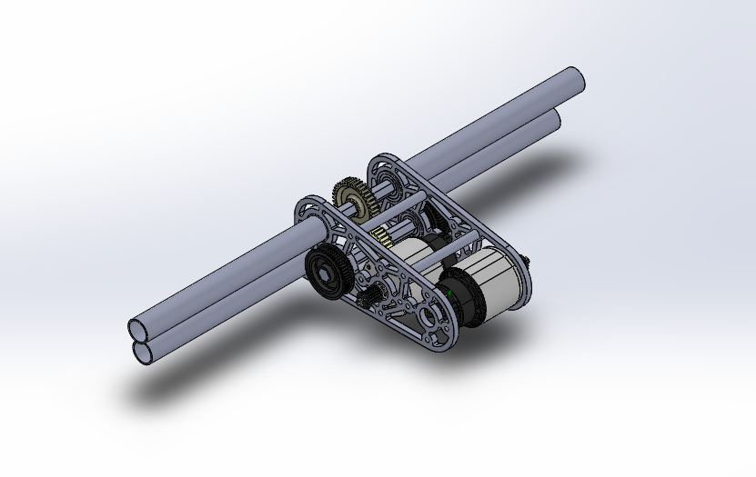

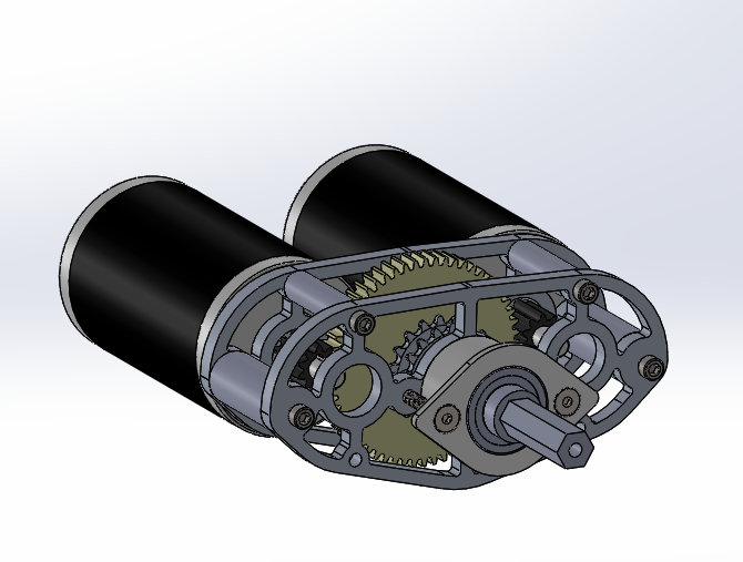

Along with that, I made an elevator which I pray we don’t have to use this year, but here it is. It is not complete but was more for a proof of concept to get the idea down. The gearbox however is complete and would be mounted to the frame by using the two tubes on the bottom. They would have tube connecting nuts pressed in which would bolt to the frame. The gearbox mount technique was taken from 1678 and how they mounted their elevator this year.
Completed Elevator.STEP (2.4 MB)
Final Elevator Gearbox.STEP (29.5 MB)
