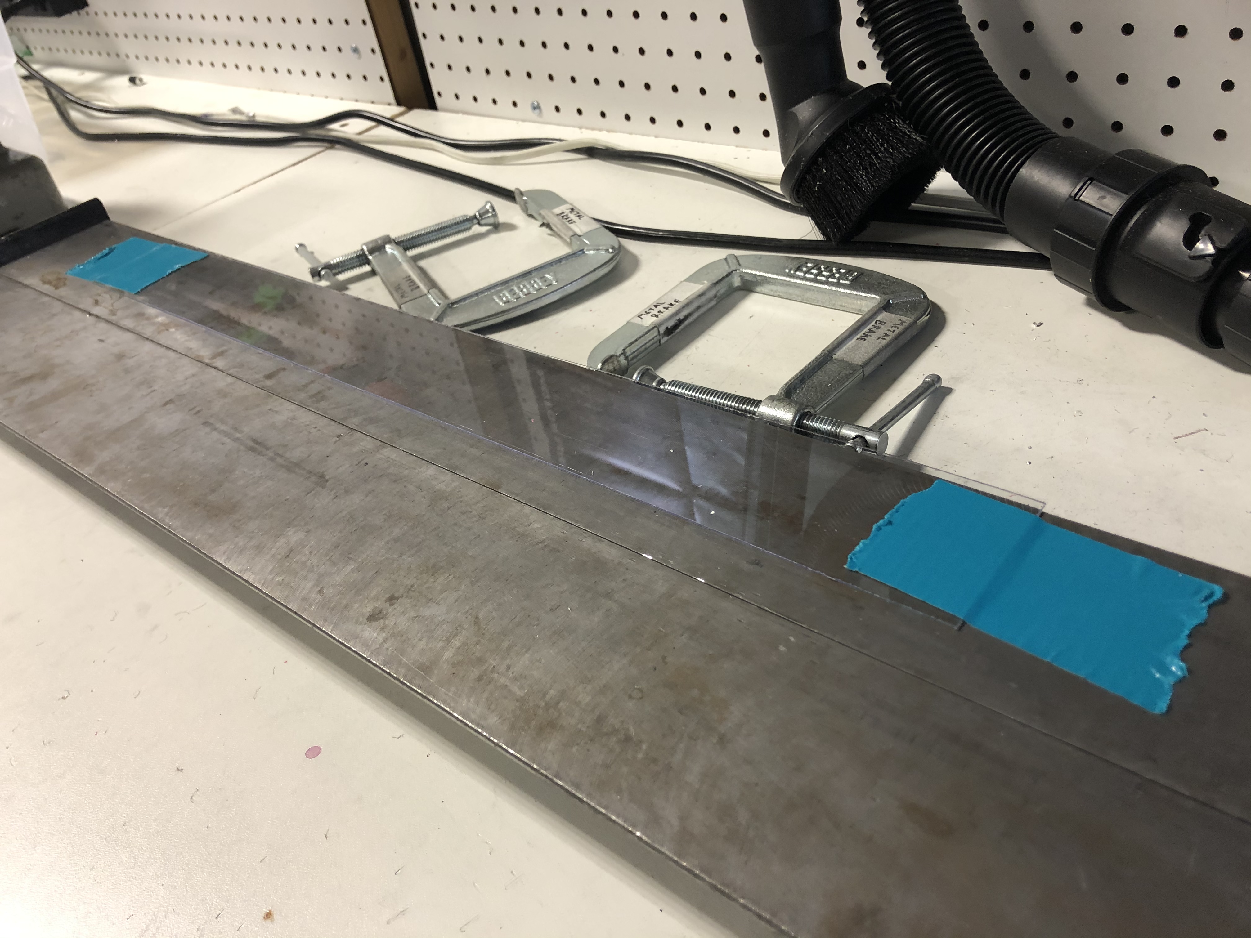

  • Use a backstop, this means you don’t have to setup your brake every time you want to bend a part. This takes ~30 seconds to do and significantly improves the accuracy and consistency of bends. Set the backstop distance on a caliper. Use the caliper to space out a 30 thou thick piece of lexan and tape it down. It’s easy to adjust and remove. Double check the tape between parts, duct tape held fine for us.

Do you happen to have a picture of how you did a backstop with the HF brake? Don’t you have to remove it or something if the backstop is only for the flanges, but not for other bends along the way?

The backstop we used all season was only a 5" x 2" piece of lexan. If we wanted to not use because we had longer flanges we’d either bend in a different part of the 30" long brake or just pull it off.

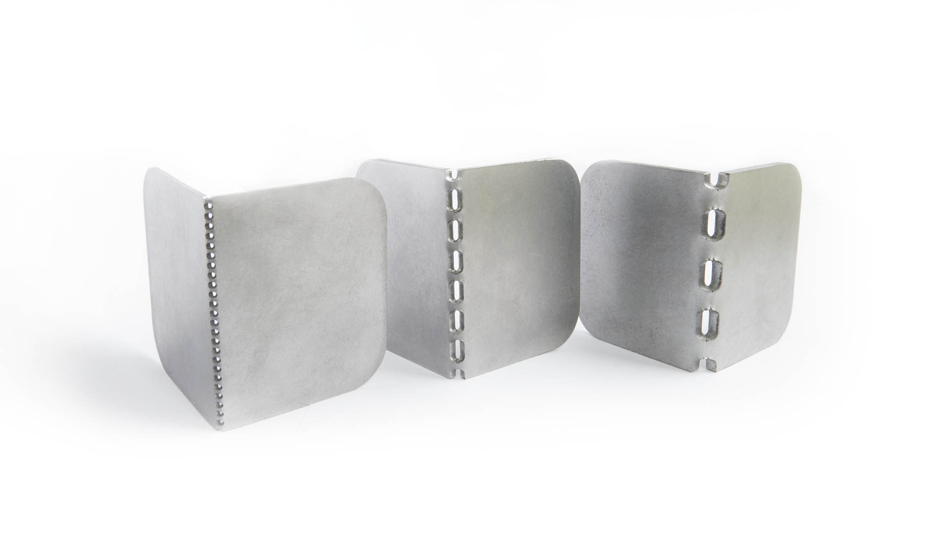

My technique for accurate bends is to drill holes on the bend line with the CNC router. I place 3-5 holes (1/16") on the bend line and line the fingers up on that. Ever since we started doing that, we have had very accurate bends.

Here’s a picture of the backstop. The backstop should be thinner than whatever material you are bending. The deep throat clamps were helpful, especially for very long flanges.
Edit: In the interest of full disclosure the one pictured is not the one we used in season but it’s been six months and who knows where that one went. It could safely be much shorter than it is as pictured.

Edit: since you have a router you have the option of perforating your bends if you think you can tolerate the strength loss (stiffness is still, generally, diminished a bit less). I’ve done this and then bent the pieces on a very light-duty pan and box brake or by hand.

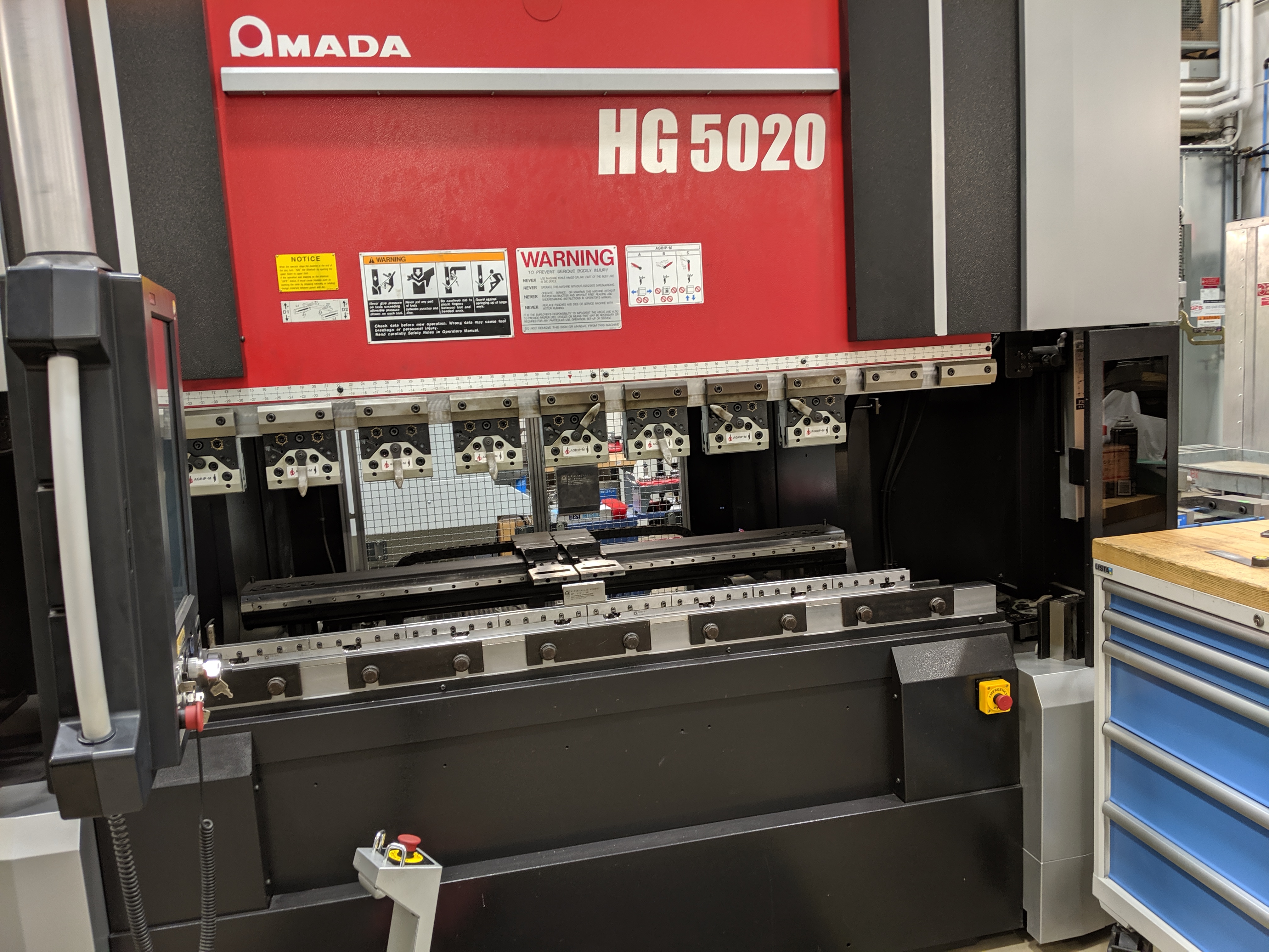

Our 2019 Cargo manipulator was bent on this bad boy.
Not while it was being moved, obviously.
