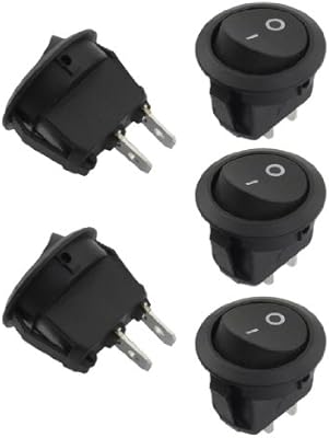

The Smart Dashboard chooser was taking up too much real estate on the screen. We made a USB device to plug into the Driver Station. It has 15 button capability (plus one button for Turbo, but that has a predefined action).
We got these buttons to go with it (you want latching buttons, not momentary contact, also round is easier to cut out a mounting hole than rectangular):
http://smile.amazon.com/gp/product/B00E0L2AG2
The device installed automatically with Windows 10. Driver station recognized it immediately as a JoyStick. No problems using WPLIB/C++ to read the button values.
