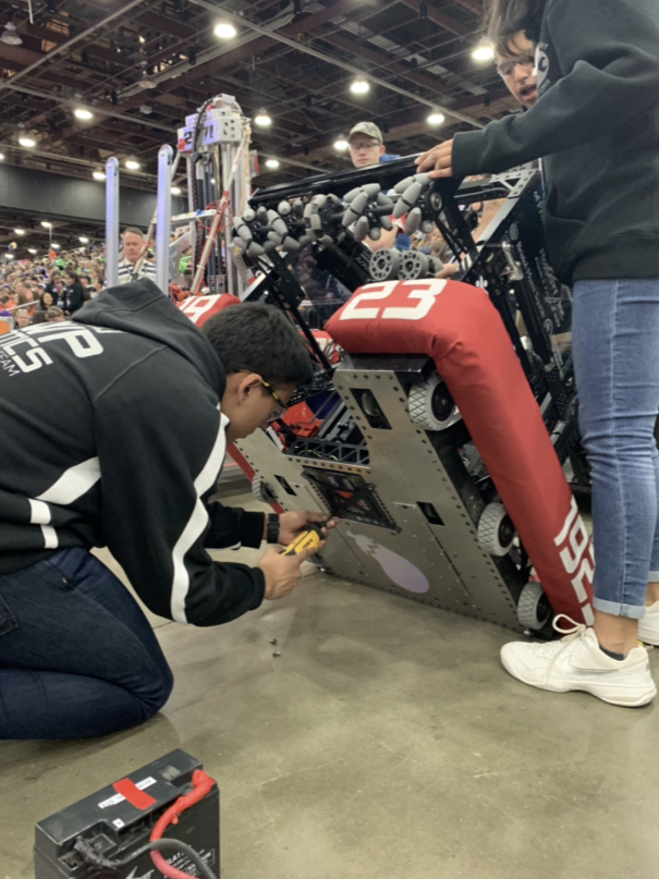

We’ve done something like this for the past few years.
It’s simple to make and works well. Add some padding, and it’s very secure. Perhaps not the most creative solution, but it works.
We had the swap time down to about 45 seconds. One to two people tip the robot back as pictured, and then the plate holding the battery in is secured with (4) 1/4"-20 button head screws, which we undo with a DeWalt Gyroscopic Screwdriver that we found has just enough torque to secure the screws without over tightening. Then its just a matter of unplugging and letting the battery slide out and then sliding the new one in, and re-securing the cover.
I actually had a bet with @Libby_K about whether the battery would ever fall out mid-match, and happy to report that the battery never fell out and I won the bet!

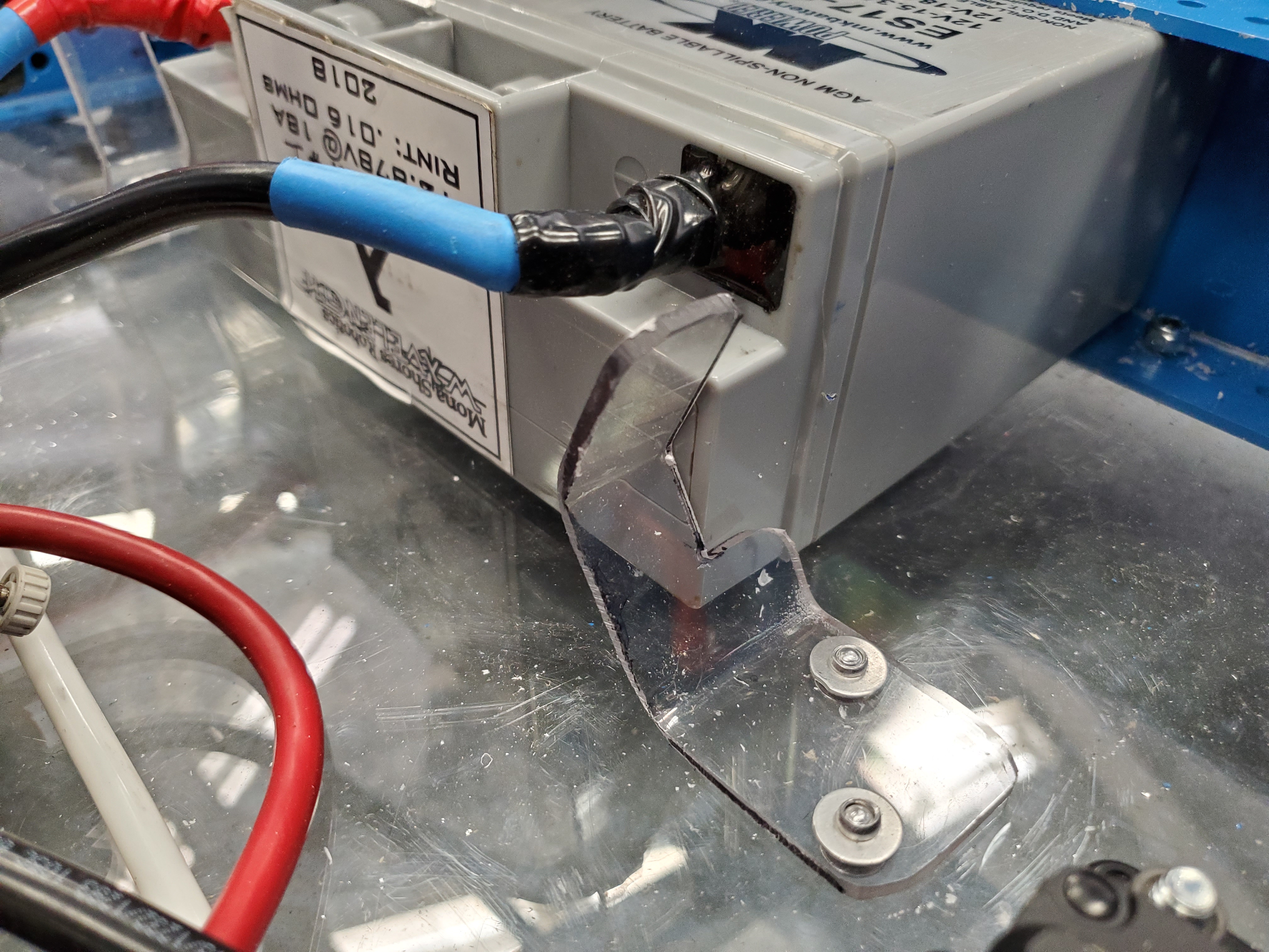

Keeping ours simple this year. We try to use a bent piece of polycarbonate every year in some way.

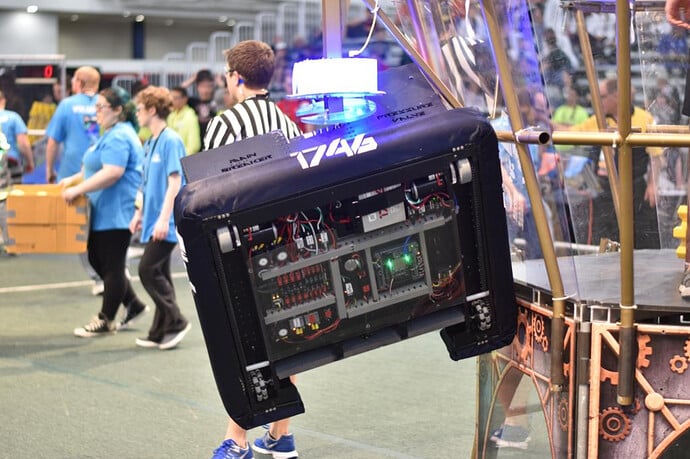

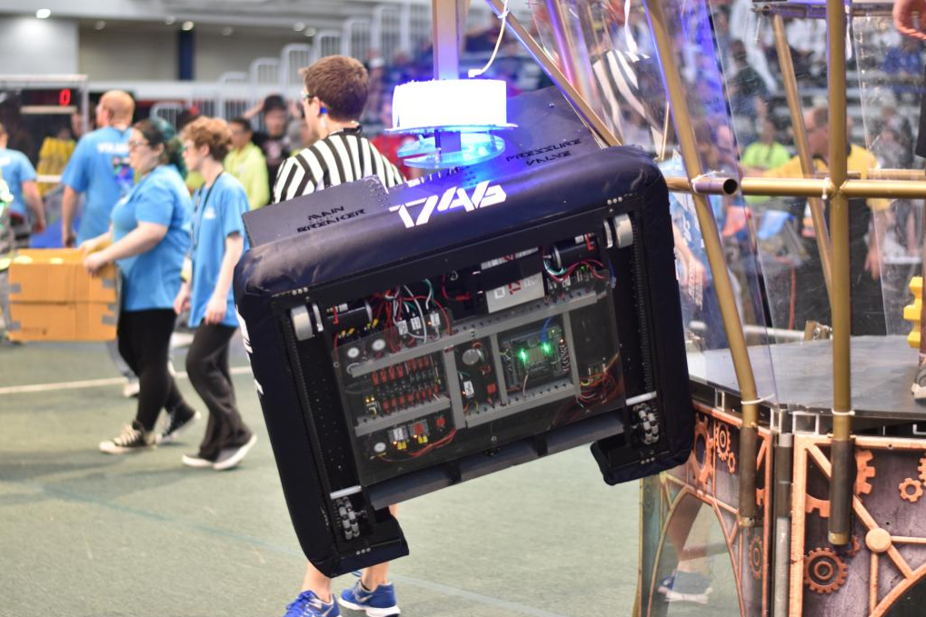

2016, our entire electrical panel hinged upwards and we used a kickstand to hold it up - kind of like a car hood! Under there we had a battery “cage” (imagine @AriMB 's battery holder but rotated 90 degrees and a little taller.

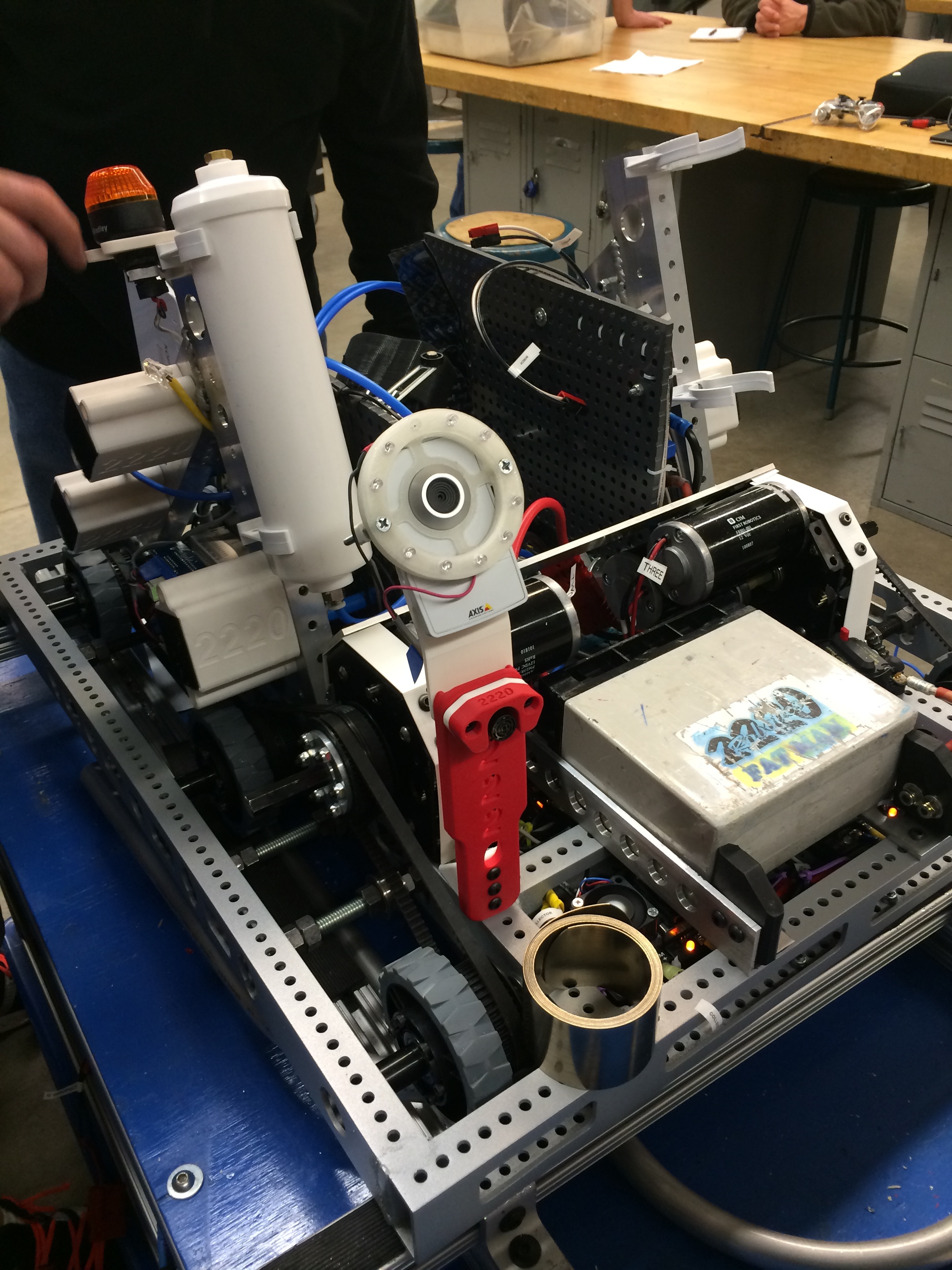

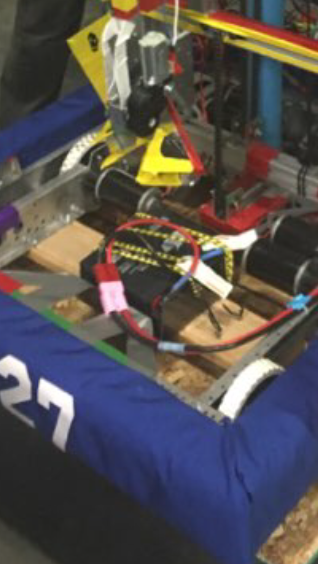

We uh, had an interesting battery position in 2014.
That is on top of our motor controllers (original Talons with short fans), nested into our drive motors for retention.

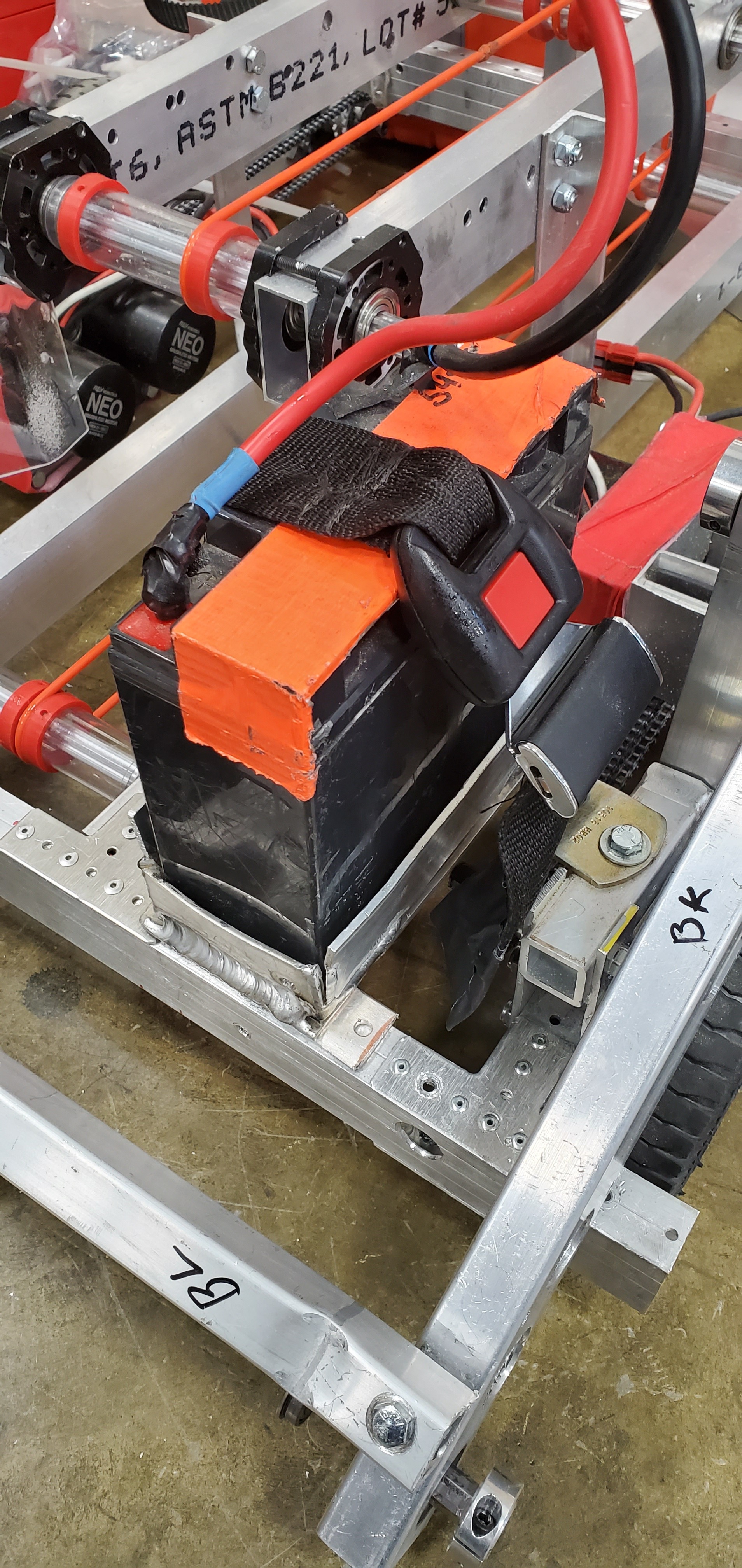

We figured that if the seat belt. Could keep me safe the battery would be no problem

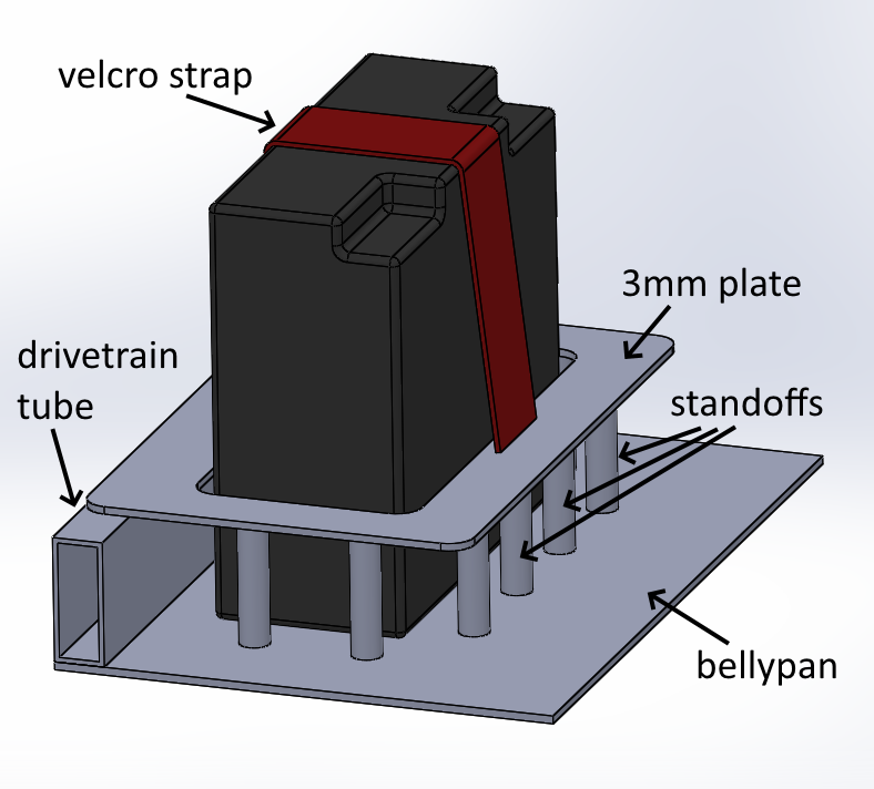

In 2017, we stored all of the electronics underneath the bellypan of the robot, and for the battery mount, there was a sheet metal U on the back and a velcro strap to hold it in place.
