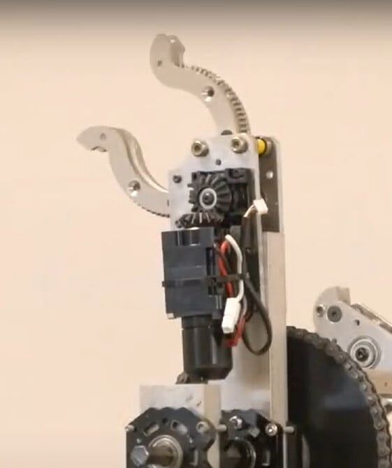

I’m going to put a vote in for 341. Lots of teams have been doing the, “Windmill,” climb, but I have yet to see another team with such a cool latching mechanism as them. They built a gear into the finger and rotate the entire latch around the bar so there is no way for them to fall off if the sequence is correct.
Check it out here:
Here is a quick snapshot:
I was lucky enough to see it in person, but maybe @Karibou or @MissDaisyGirl could comment or share some CAD screenshots.

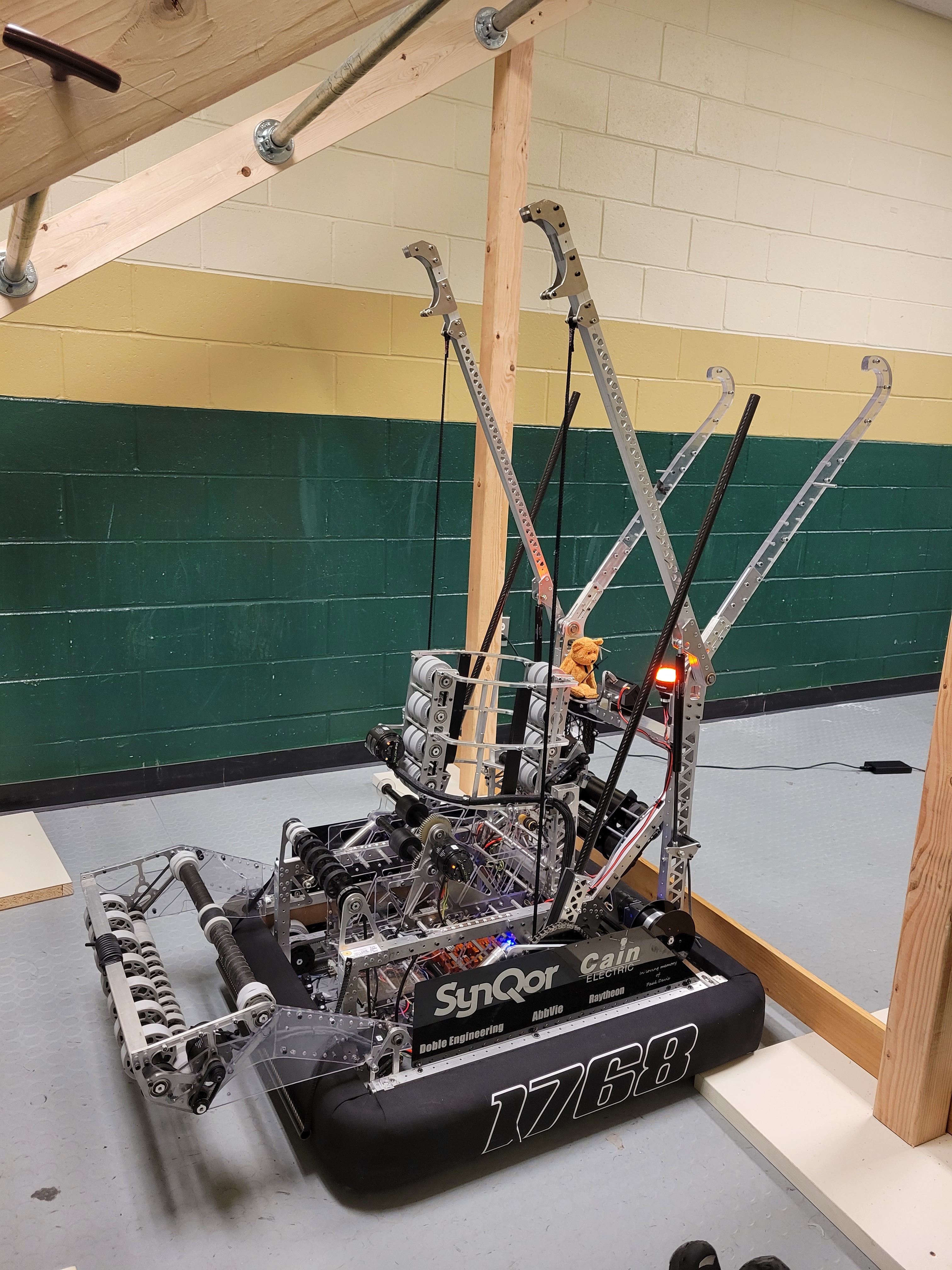

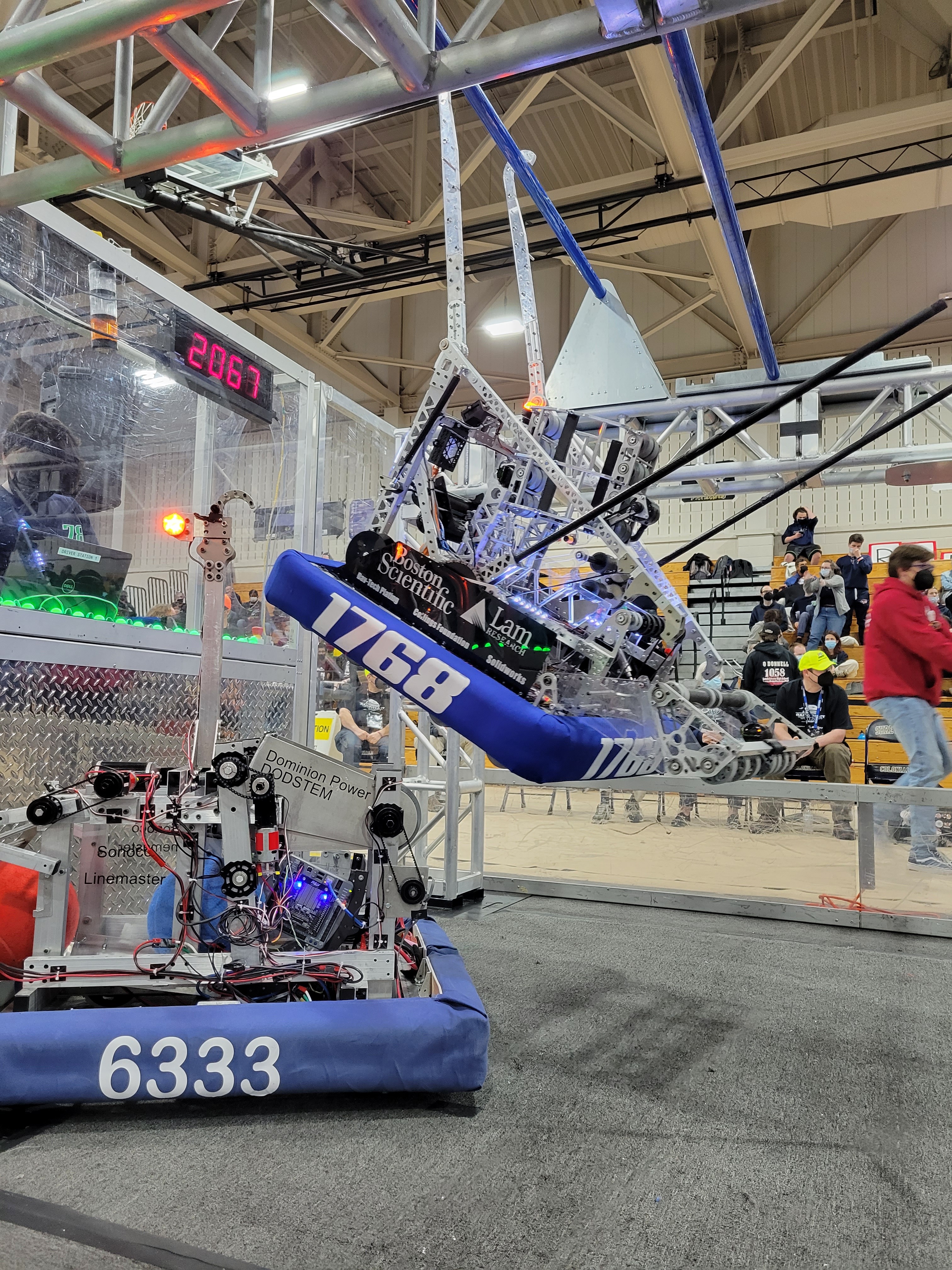

I don’t feel like we have a super creative climber but we did get the creativity award at both of our competitions. It uses a modified climber in a box, different hooks rotation at the bottom and a 2nd wench and spring to control the rotation. This allows us to reliably control our center of gravity and decrease the swinging. (Team 5492) allthough some of that award had to do with our fold out electrical box.
Actually, we also react off of the high rung instead of the truss. Our Blue Alliance photo has the truss reaction bar, but we couldn’t get our claws to latch fully, so we switched, partially inspired by 3310 as well I believe. Instead we use fiberglass poles that bend on the high rung and react us into the right angle to connect with our claws.
You can see them climbing here on blue

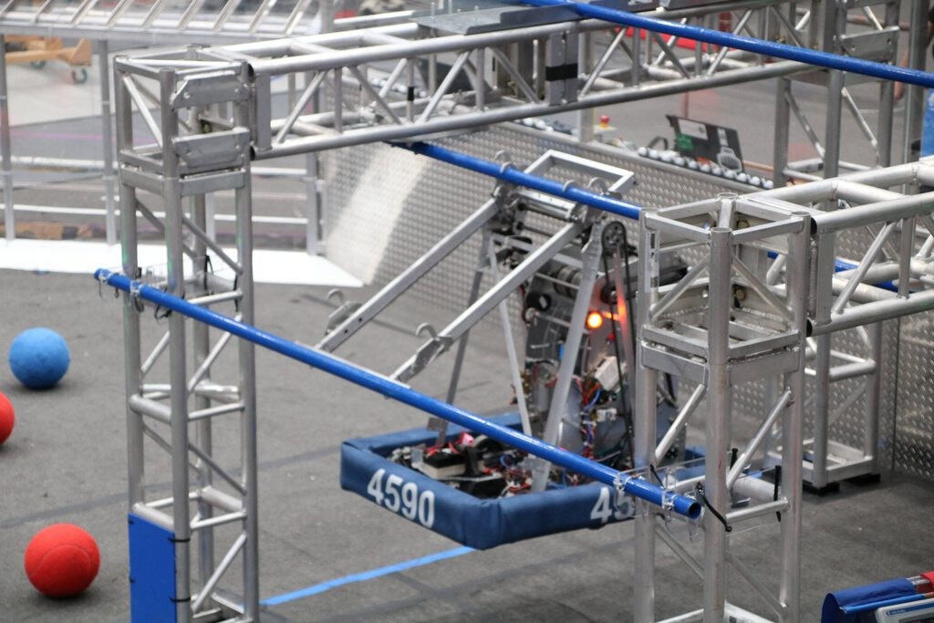

4338 and 4590 both had similar designs, and I can personally say they were both a treat to watch up close
