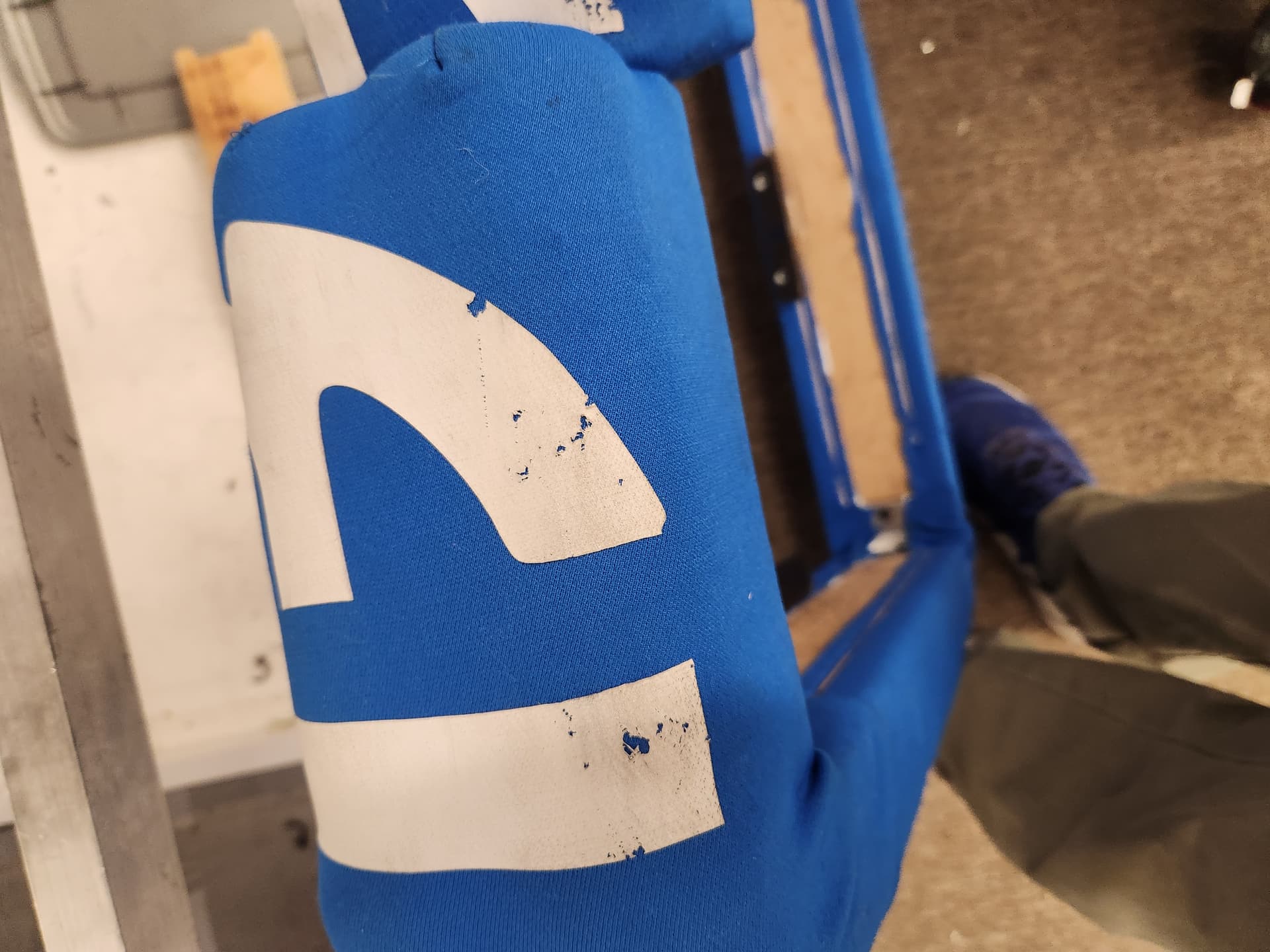

The fabric has held up well, but this game has been harder on bumpers in general than most I’ve been a part of. Though we didn’t have any rips or tears, the numbers were scratched, and most importantly the wood backing and pool noodles have been damaged, so we recently rebuilt for the Colorado Regional. Rockywoods is out of the red fabric, though they still have blue. Discovery Fabrics in Canada has the red. For now, We are continuing to experiment with other Fabrics. This round, we are trying Nike Dri-FIT.

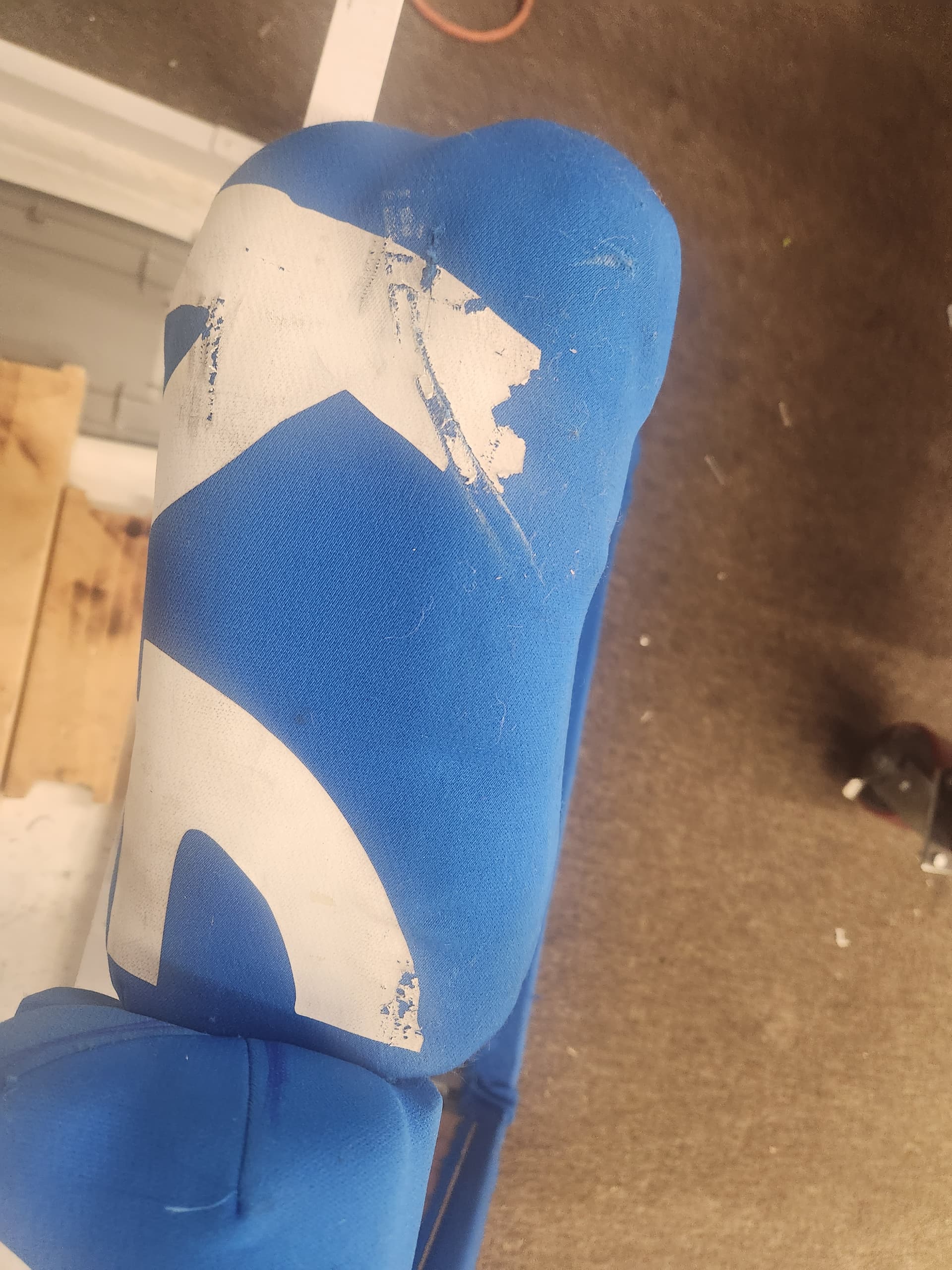

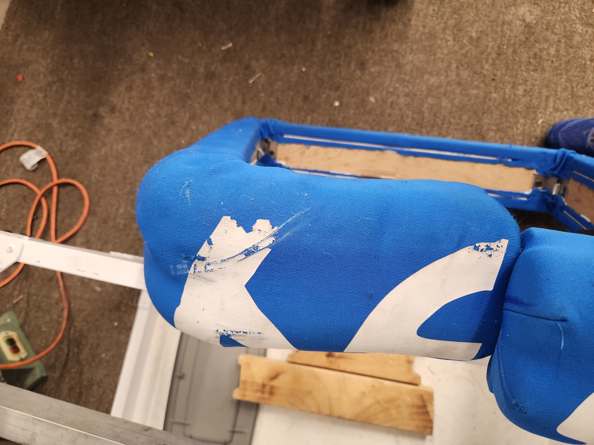

Here is the evidence of hard play on our bumper exterior. Fabric is in good condition but numbers are not. Inside, the pool noodles are broken and in need of replacing. Overall I remain on the Schussmeister train.
We are running the Schoeller Schussmeister (at Joel’s recommendation and based on our own experimentation last summer) and it is doing great so far-- no significant problems after 36 official matches plus many practice matches.

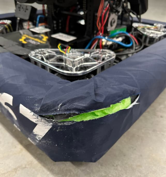

So far we’ve ruined 4 bumpers with large cuts.
2x Blue bumpers in practice on a competition spec charging station. Should have used a practice set but our fault. Then this weekend we had two 24" front to back tears of a red and blue bumper right along the bottom.
I fear we will be replacing bumpers all season long.
Wow. I thought our bumper damage was bad - you win (sorry).
