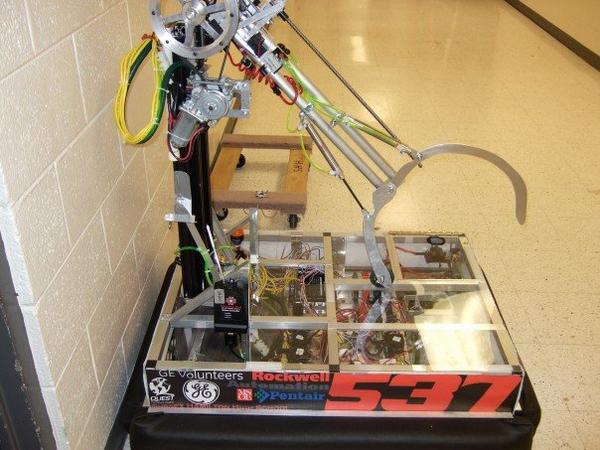

Team 537’s arm has 6 axes of motion. 2 axes on the claw, a boom extension, an elbow, a mast extension, and a total arm rotation. The most unique feature of the overall arm is its ability to rotate at the base approximately 450 degrees. We love it b/c we can score while were being pushed around, although our tank style dt doesnt allow for that very much. Here is a picture.
