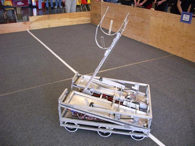

This is our robot. (unpainted)
It’s unique features:
  1. Through a strange system of pullys, the arm can extend to the top row.
  2. A ramp is built into the chassis. The ramp is made of 2 triangles forming a rectangle that unfold to form a ramp.
  3. The ramp is deployed using the arm. Through extending, the arm can push the ramp away from the rest of the chassis and into position.
  4. The ramp, once in position, can be lifted paralell to the feild and lift 2 robots 14 inches.
  5. To increse the width of the ramp, the ramp’s plates are hooked to a system of bungee cords that, when the ramp is lifted, pull the plates outwards and greatly increse the ramp’s width.
:smiley: :smiley: HOPE YOU LIKE IT!:smiley: :cool:
Oh and i forgot to say our robot has a digital compass so it knows were its facing relative to north so we can use drivercentric control. Its pretty sweet we can make the robot auto correct itself to face forwards again or because of our mecanum wheels it can go to my forwards no matter what way it faces.
