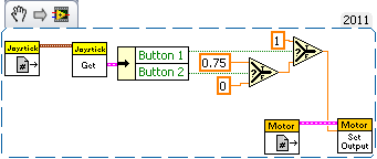

Alright my mentor and I are trying to get it so when we press button 1 we get our shooter to turn at 100% and when we press button 2 we want 75% but we can only get it to got 100% with button 1 and when we press button 2 all it does is pulsate. Any ideas or suggestions?
Yes but… How do you set those two two different speeds?
Something like this
I do believe that looks right we were just adding something to make it wrong… Thanks I will try it rit away in the morning! Thanks mark!
