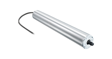

Motor Driven Roller
The game rules state this:
“Electrical solenoid actuators or electromagnets with rated electrical input power no greater than 50 watts (W) continuous duty at 12 volts (VDC) (if qualifying actuator is then used at 24V, it must be approved by the manufacturer for use at 24V)”
I am relatively new to FRC. There are MDR - Motor Driven Rollers used in the industry. There are units that are 48W to stay under the 50W requirements, used in 24v systems. I don’t think they are allowed, but how would I verify this?
Interroll, Pulse, and Itoh Denki are all manufacturers of these type of units.

The cost per motor will be in the $150-$250 range based on the length used. There is also a “Controller Card” needed. The controller cards can operate 1-4 MDRs. The cards are networkable, so direct programming to each motor is available. Price may be what has limited these in the past. (This is my second year… we’ll see with First Inspires says.) The upside is these are used in many locations across many industries.
