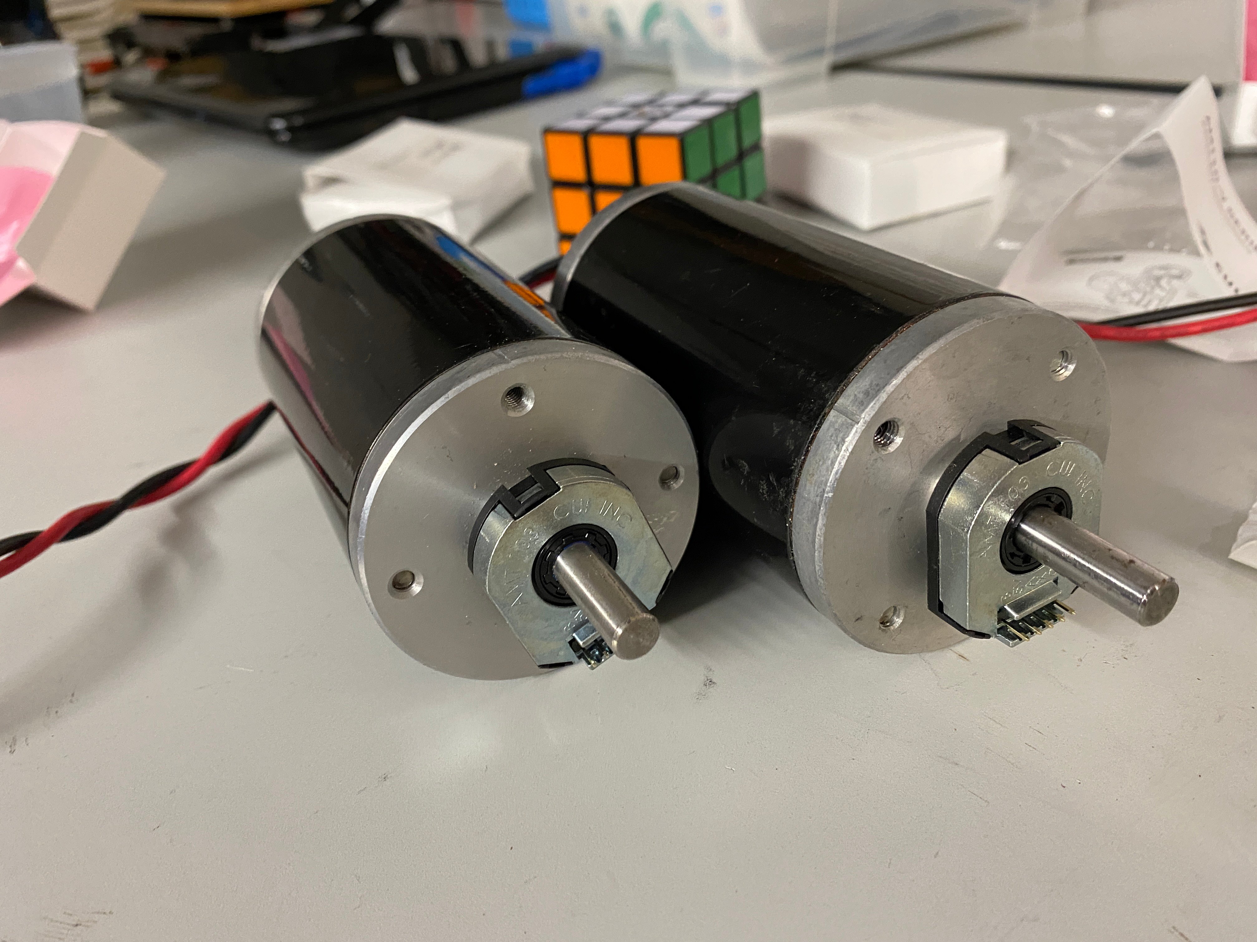

Hi all,
We attached four encoder kits (AMT-103) to four CIM motors, however only one of them stays on, unless you tug with some pressure. The others slide off if you gently pull on them.
Do you have any suggestions on what to do?

Make sure you assembled them properly. Also, make sure you are using the “blue” insert to get a good friction fit on the motor.
The AMT 103 is designed for the plastic base plate to be secured to the motor (step 4 of assembly). Unfortunately, the largest bolt circle on the base plate is 1" diameter, and the CIM mounts are 2" apart. (Reference the figures at the bottom of page 6 of the spec sheet.) To use this encoder with a CIM, you’ll need to get creative. Two ideas: mount the encoder base plate to the plate to which you mount the motor, or 3d print a larger base plate similar to the AMT 102’s wide plate (but even wider).
If you’re not planning this for FRC, you might consider disassembling the CIMs and tap a pair of holes in the shaft plate that match holes in the encoder mount plate and be sure to use short enough screws, but this is not an FRC permissible motor mod per 2020’s R28.

I’m not sure I fully understand the problem. The plastic base should be mounted to the motor. The best way to mount the AMT encoders, no matter where you are mounting them, is VHB (Very High Bond double stick tape), just make sure you use the centering device as you install it.
The adapter should lock on to the shaft fairly securely but it doesn’t need to transfer much torque. The adapter is supposed to be a slip fit in the encoder and it not intended to retain the encoder itself.

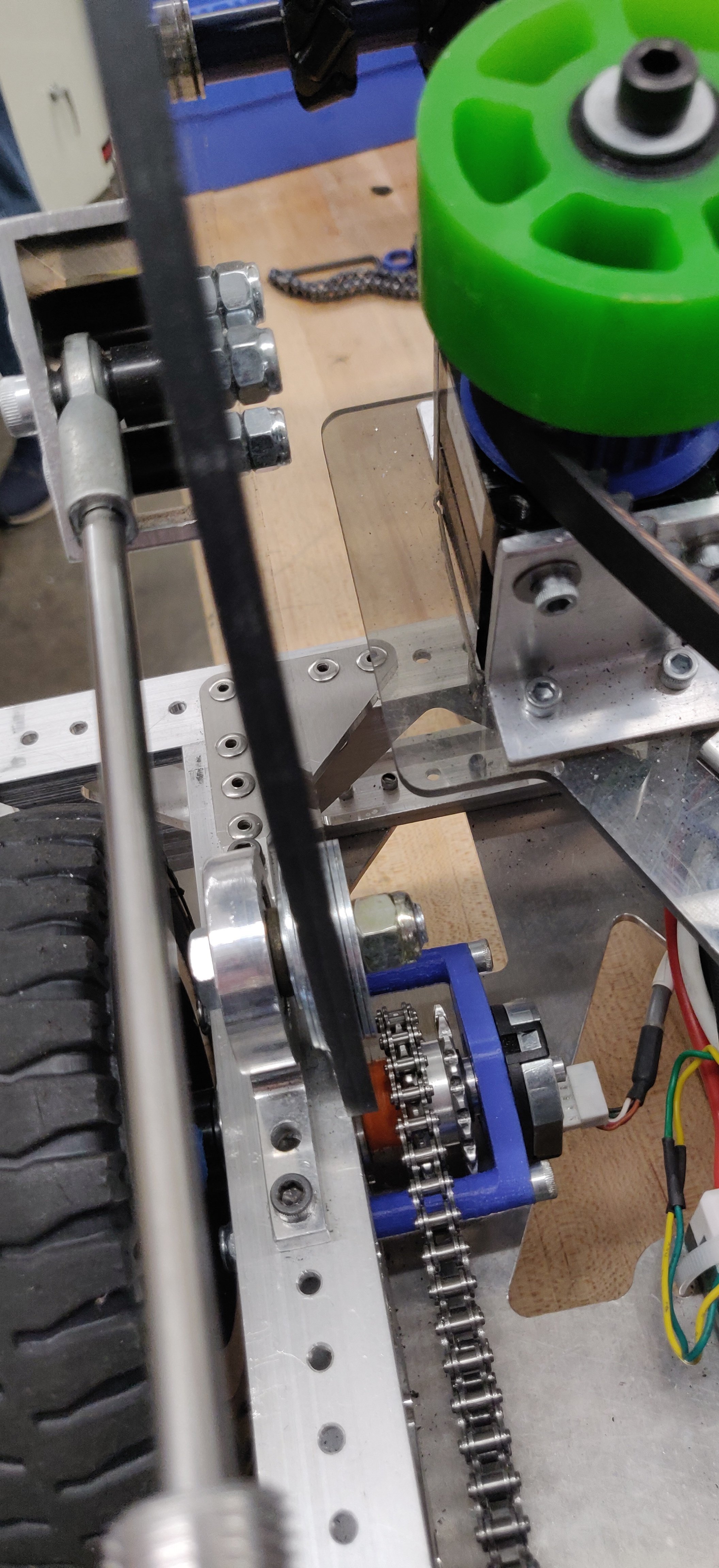

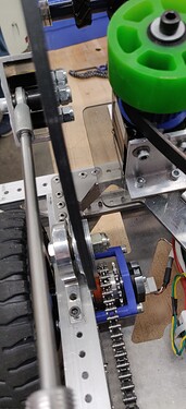

My team, 3512 uses AMT 103’s for our drivetrain encoders.
We secure them directly to a turned down hex shaft with a 3D printed mount:

Don’t quote me on this but I think the 103 works with this from a hole mounting standpoint the issue becomes the direction the 103 wires come out. With my design they would interfere with the mounting plates that cim was on but if you can tailor the plate to accommodate the wires then that could work.
You’re absolutely correct here. It’s been a while since I’ve worked with these encoders, and now that you say that and I look more closely at the differences, that would be an issue that needs designing around…
