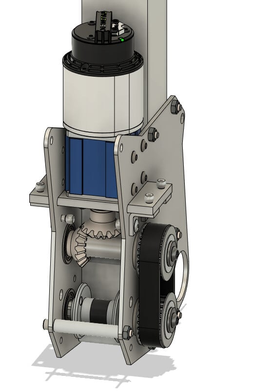

This is what 7457 is using this year. We ran into packaging issues with the winch system in its original state, and switching to this bevel box gives us a lot of room to play with. We are using the 15T 1/2" Hex Bevel Gears from vex and sanding down the back face of one the gears to fit it in.

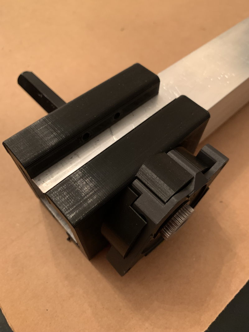

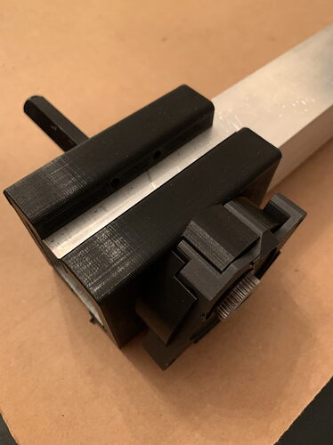

As part of a personal project to get better at Fusion360, I designed an 3D printed mount that moves the spool into the tube, perhaps that might be helpful. Hasn’t been tested in competition conditions but the 3D printed parts aren’t under any significant stress.
