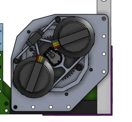

im looking for a way to design sheilds for the motors on the mk4 and mk4i swerve drives.
the shields need to connect to the chassis and need to protect the motors from any harm from impact with other objects/robots.
mk4:
the mk4 motor shields that i have in mind are just big aluminium L pieces that are about 50x50x2 mm. the problem with this desing is that its too strong and last year it was on my teams robot and our chassis got a huge disformation on its side.
mk4i:
i have no idead on how to design these motor sheilds. from what i know they need to cover up the bottom part of the Falcon 500 motors (that are positioned really close to the floor) and protect them from any objects that may be on the floor. i wanna say that it would be logical to make these shields more roundish to spread the impact evenly but i am really in the dark here.

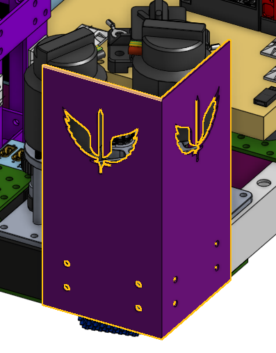

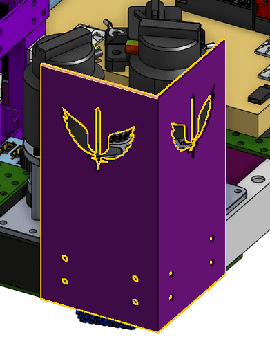

these are the shields we had last year. they were too hard and wouldn’t budge and because of that the energy transfer disformed our chassis. (the big purple L)

It’s an engineering problem; the energy from the collision has to go somewhere. In this case, the energy went into deforming your chassis. You could make the shields less strong, but then they might not protect the motors.

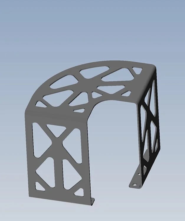

Regarding manufacturing, it looks like your 2023 guards are made of sheet metal?

i think something like what 5990 did this year would work fine with some adjustments.
i just want something that i can detach and replace fast if i need to.

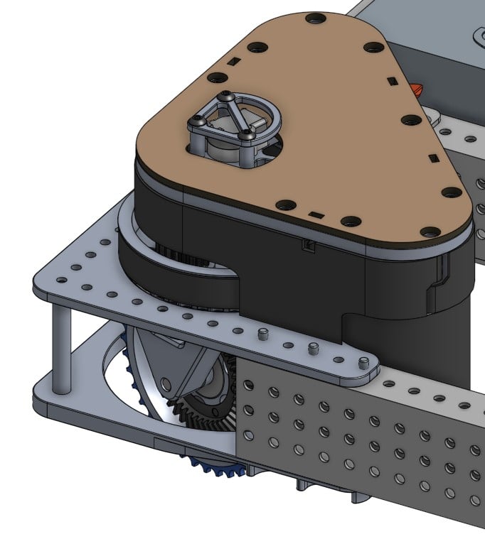

the problem here is that the midplate in my chassis will be way higher and wont provide a lot of coverage for the motors. its because we are shortening the corner spacers to fit our 20x40x3 mm tubing instead of the 1x2x1/8 inch.
beacause its now a lot shorter the motors are exposed and the gap between the chassis and the floor is 10~ mm higher, meaning that something as big as 10~ mm + the original gap can damage the motors without being moved by the chassis
You can add CNC’d alluminum spacers above your 40mm tube so the L bracket clamps down on 2in worth of material, 254 did something like this in 2022 to get closer ground clearance but you could use a similar idea
